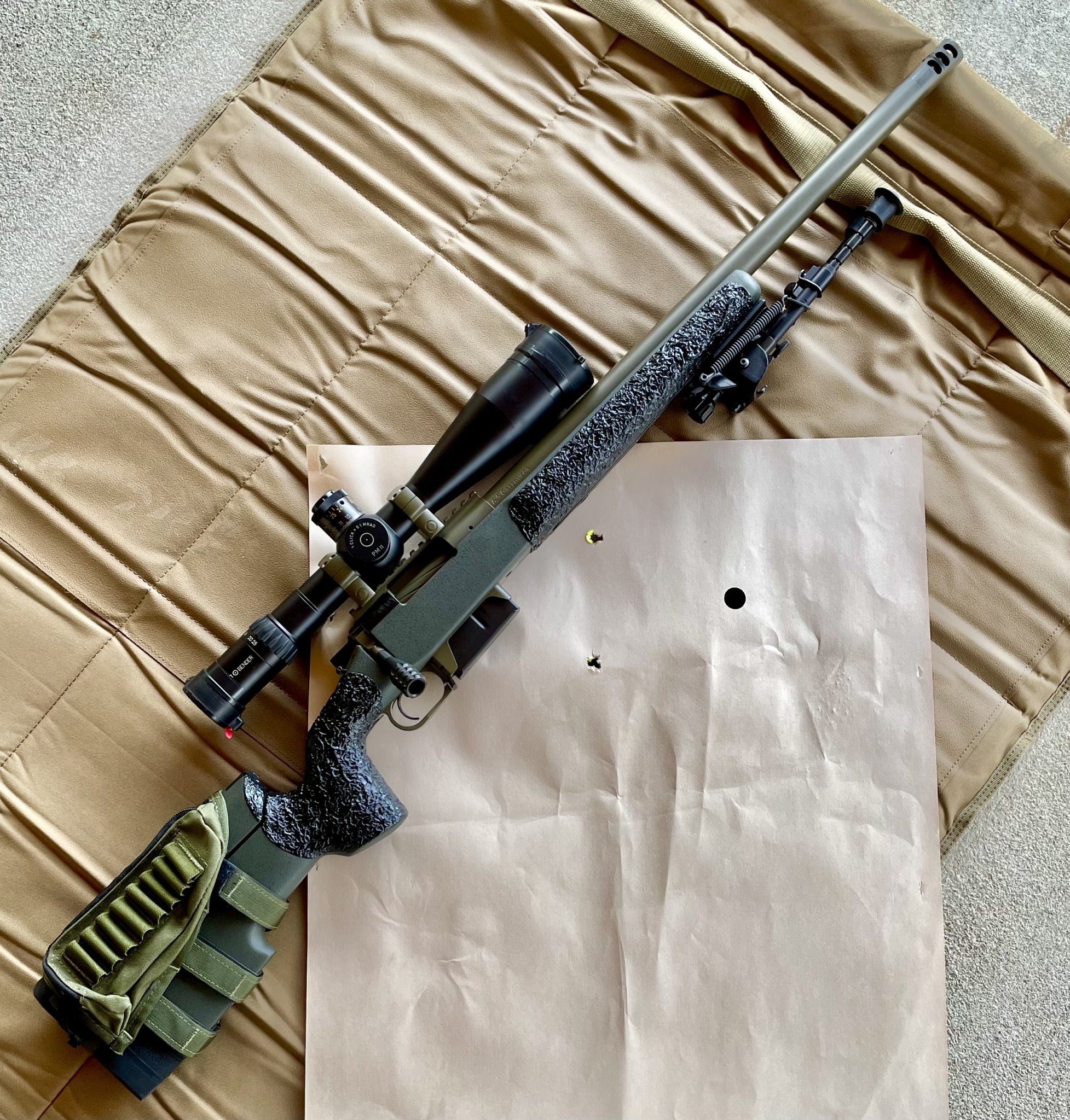

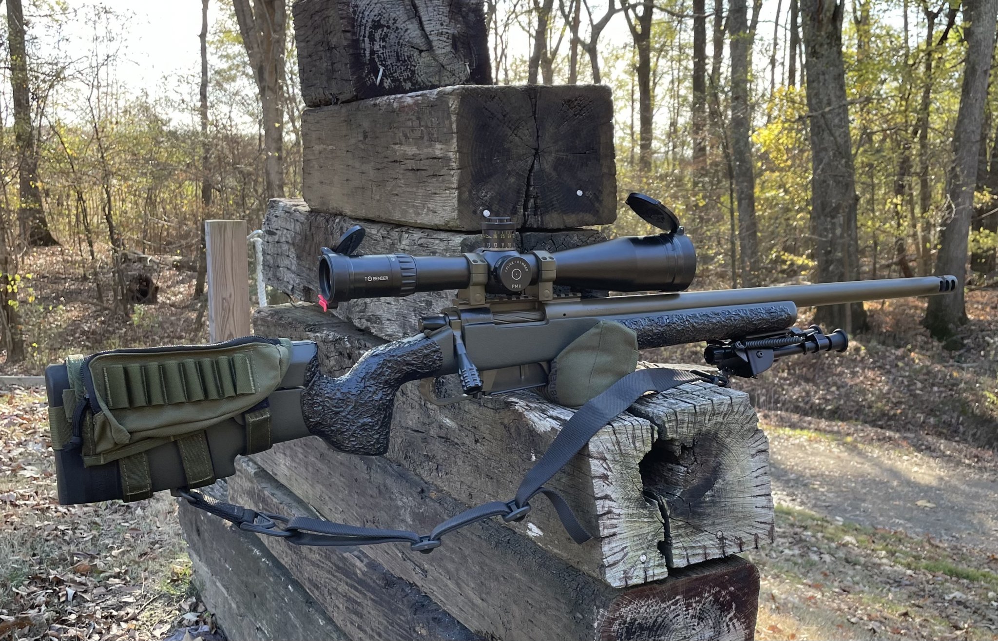

Can't tell you how many start with "this be my only one" and end up with six full size gun safes stuffed full :ROFLMAO: I like the idea starting with the best (unlike me that justifies an entry level and then upgrades five times). My current toy is the Impact /Bartlein/Manners carbon fiber/Trigger Tech/ Spur/Night Force ATCAR and I absolutely love it!
