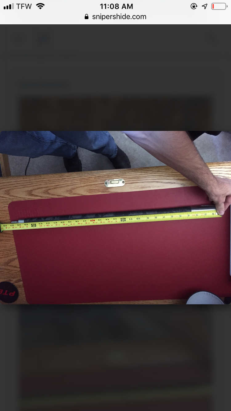

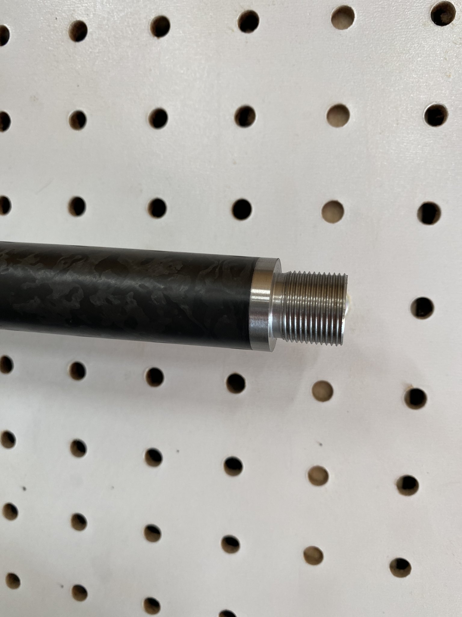

Eight months ago I sold a older proof barrel blank to a member on here. This week he messaged me saying it was messed up. To my knowledge this barrel came directly from Proof with the tenon threaded this way. I’m looking for someone more knowledgeable to tell me if this blank is messed up.

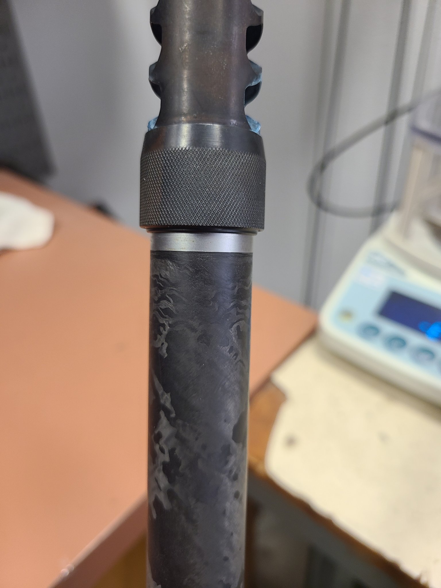

This is the original photo I sent the guy that purchased the barrel. I know the skinny part should be cut off and from the picture I sent it looks to be roughly the .8” the Proof lists on the website. Unfortunately I never received that measurement from his gunsmith.
Or maybe the gunsmith has never done a proof barrel before as 98% of barrels don't have a tenon like a proof and thought the tenon was the part needing threaded. ... either way he asked before screwing it up ? All good he can work on it now and will.be fine for him. Have the GS give proof a call and they can explain what's going on if he'd like. Just sayin. Carry on
Well, I think we found the gunsmith... 🤣😂🤣
I've built a lot of rifles, and I'm well aware no other barrels out there come with a tenon hanging off the end. But it still should be common sense, and the smith should call Proof instead of telling the customer it's "defective", and relaying the message to the seller, and then the seller posting about it on here.

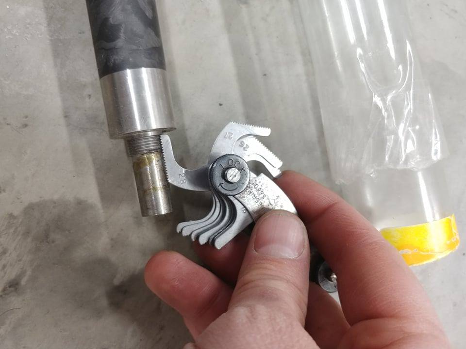

Older Proof barrels had a 1/2-28 threaded section like that, I got one in about 2014 that was identical. There is nothing wrong with the barrel. Somewhere along the way they changed to a 5/8” straight tennon left, I’d imagine the older threads were from the wrapping process. Cut that portion off and roll on as usual.

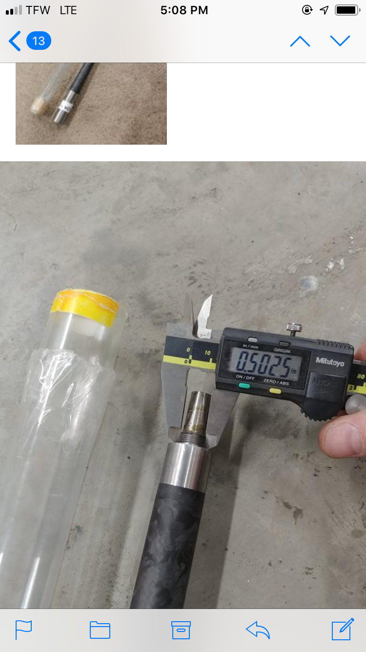

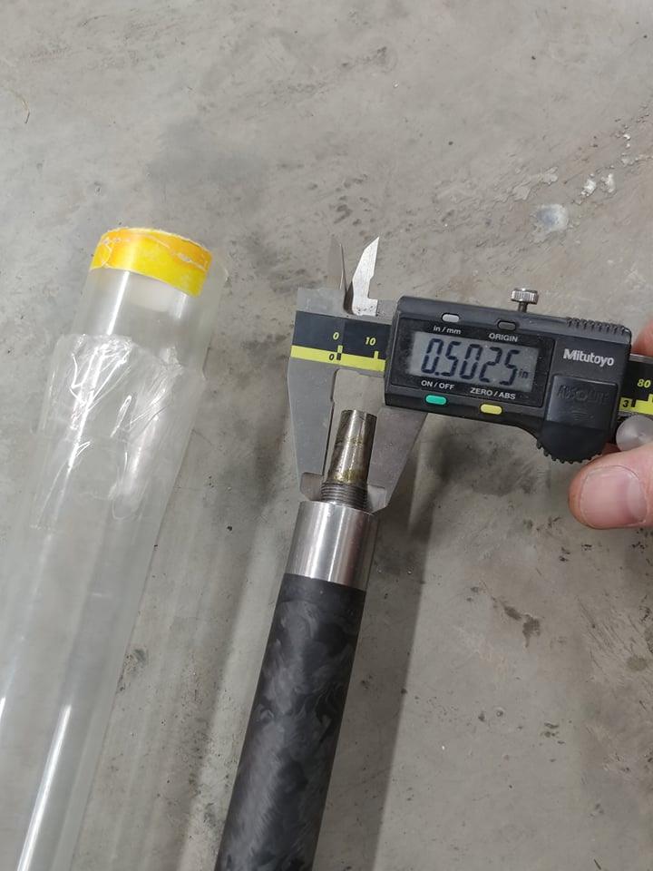

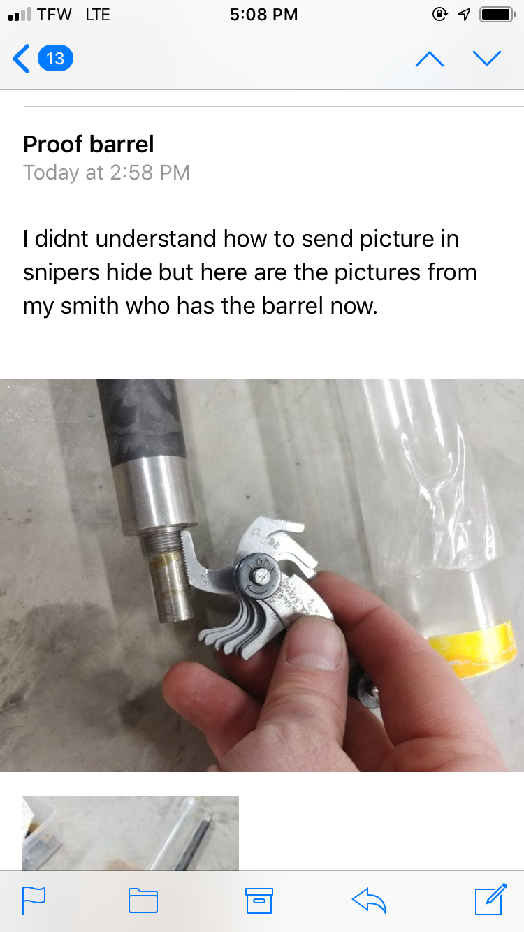

Ok so I'm the guy that bought the barrel. For all of you guys saying " that skinny part should be cut off", that skinny part is meant to be threaded for a brake or any other muzzle device you might want to put on it. It is threaded for 1/2x28. THIS IS A .338 CALIBER BARREL. No gunsmith or barrel maker would ever put that small of a thread on a .338 caliber barrel. I have never even seen a muzzle device threaded for that. My gun smith has already contacted proof with the serial number on the barrel. Proof says they never put threads on blanks. NEVER. How can you say that this is a new blank? It is very obvious that someone messed up by threading 1/2x28 on the muzzle and wanted rid of the barrel because they knew they messed up.
No it is not, you must cut that off. The full diameter section that butts up to the carbon is what needs to be threaded.

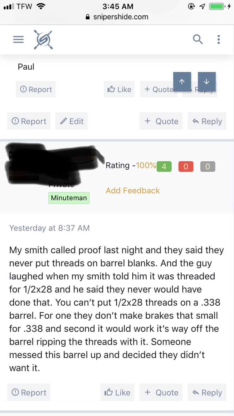

I will call Proof myself this morning. But like I said, my smith has already called them and they told him they never would have done this to a .338 barrel.
The part you think is ‘messed up” needs to be cut off as its a byproduct of manufacturing. The fact that your gunsmith didn't say “well we’re cutting that off anyway” is troubling.

If this is how it should be then my bad. I have bought 4 other proof barrels and they never came threaded or with a .5 diameter muzzle. They were all significantly newer than this one. When I bought the barrel I had no idea how old it was. In the pictures he had on the page you couldn't tell it was threaded at the end. He has advertised it as a new blank. I should have called proof with the serial number to confirm how old it was, but I honestly never thought that it could be over 6 years old.
It doesn't matter how old it is or what that stub looks like. The "muzzle" isnt 0.5", the stub is. It literally gets chopped off. Companies change things over the years. There is nothing wrong and your Smith should have chopped thst off and threaded the actual muzzle and been done with it. There is nothing to prove or accuse or complain about. Just cut it off like you're supposed to.

Now im curious. The other proofs you purchased, did they have that spigot sticking out the front? Did your gunsmith thread that portion, or did he hack them off?
Find a new gunsmith. Send it to DST who chimed in on this thread. Your gunsmith doesn't know what he's doing and neither do you in this case. I am not trying to be mean, it just is what it is. I got a friend in the Butler area also, please let us know who the gunsmith is so I can let my buddy know to avoid him.
Reactions: Deep South Tactical
Ok, I get it. I'm apparently wrong on this. I'm sorry for putting putting the seller through this. I was only going off of what I was told by not only my gunsmith but Proof themselves. I'm going to get the name of the guy my gunsmith talked to at proof and try to get ahold of him and maybe someone that knows that they are talking about. Maybe he was a new guy at Proof and didn't know they used to do that.
Ok I just got off the phone with Proof research. He said they never threaded blanks. Period. They use the shank at the end of the barrel to hold the barrel from wrapping, but they don't use threads. He also told me that the small shank is meant to be cut off and to thread the larger part. So the barrel itself should be fine for making new threads. But he told me that someone had threaded the barrel after it left proof and obviously didn't know what they were doing. So for those that said "that's how they used to do it" no its not. I was told I was getting a new blank. I realize that the barrel should be fine and I'm going to roll with it but this is not what I thought I was buying.
My smith knew as soon as he saw it that it had been threaded by someone. I was wrong by saying that you are supposed to thread the shank at the end. But what the hell do I know. I just shoot these things. The fact is that this barrel has had machining done to it after it left proof. This is not a new blank and as far as I know right now its someone's mistake or reject.
My smith as soon as he saw it that it had been threaded by someone. I was wrong by saying that you are supposed to thread the shank at the end. But what the hell do I know. I just shoot these things. The fact is that this barrel has had machining done to it after it left proof. This is not a new blank and as far as I know right now its someone's mistake or reject.
Does the blank have a chamber cut into it? If not, it’s a new blank. Simple as that.
The part that needs to actually be threaded (the muzzle) hasn’t been threaded, the chamber hasn’t been cut, the tenon hasn’t been threaded. Someone cut threads in the stub that gets cut off. Big deal. I guess you could always sell it, and wait a year or longer for a new barrel from Proof.
Judging by the pictures posted, the barrel hasn't been chambered or fitted for an action - given that, it's still a new blank just as @Krob95 said.
You've had 2 gunsmiths (@Deep South Tactical and @DAVETOOLEY) tell you that what you have is normal.
You've had a site moderator (@padom) tell you what you have is normal.
All of this plus an overwhelming consensus that what you have is normal.
But, for the sake of the argument, what if someone did chuck it into a lathe and thread that short little portion you're concerned about - how does this objectively make the barrel a "mistake" or "reject"?
ETA: Sorry, 3 gunsmiths (sorry @LibertyArms)
Proof themselves told me this isn't normal. I have a ton of respect for the people that chimed in on this but I just feel like I got taken advantage of. I would not have bought the barrel if I knew someone had done work to it. Even if it was just threading the scrap end of the barrel. And I think a lot of people would feel the same way. How is that hard to understand? Lesson learned on trying to save a couple bucks on buying critical rifle components from a private party.
No. I highly doubt anyone would feel the same way given this particular situation. So yes, admittedly, your stance is hard for me to understand.
Proof themselves told you the above, but you're still doubling down on it like you received a defective product.
You still have a brand new barrel that has never been chambered. You are not being taken advantage of.
@Krob95 started the bidding at $300 - I'll offer you $350. I don't even care what caliber or twist the barrel is, I'll build something with it :D .
I’ll give you 200 now for the reject barrel since you’re whining about something trivial. Cry us a river, build a bridge, and get over it. Literally other people have had older proofs with the stupid thread on there. Dave Tooley, the man himself, has seen them like that. I wouldn’t discount a word he says.
Anywho, sell the barrel, or chamber it, Ben. But complaining about your brand new, never been fired, old stock barrel is comical at best.
Can't believe this thread is still going, if I sold it to him that barrel, I would give him has money back and sell it to someone else who knows what is going on. If you can't take the word of these respected smiths in this thread, not sure who will convince you.

Thank you. When I took my parts to my smith I was kind of crushed when he said someone had messed up the end of the barrel. I was thinking that the seller was just off loading damaged goods. I knew I wouldn't be able to order a new blank anytime soon. I had just got my action from defiance for the build and they were 2 months behind on orders. Its not like a ran to the internet to slam this guy for selling me a messed up barrel. We called proof to see what was up. They told me they never did this. Promised me. I even called back a second time and told them about what was going on on snipers hide. He guaranteed me that someone had threaded the end of the barrel and it wasn't them. He said he sees it all the time. People mess up the threading on the barrel and get rid of it. I asked him to send me an email stating that and he said that there's a special department that deals with snipershide posts and he would see what they said about the matter.
I suspect that the CS reps you spoke with were in junior high when this barrel was made in 2013-2014 time frame and they haven't a clue what was done then.
Best of luck and I'm glad you have a quality barrel to have spun for your gun....but I personally would still be leary of your gunsmith.
