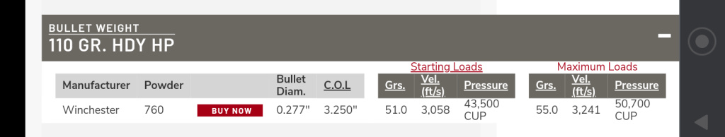

If I understand this following quote correctly you are NOWHERE near pressure (likely due to that spacious chamber Dave mentioned maybe?)
...yet absolutely no flattening and powder levels are 75% of max ( Win 760 ball 53.5 grns on these loads )...
Quick look at Hodgdon site shows 51-55gr to be a lawyer approved published range
And you are in the middle of this range with a spacious chamber... So my ASSUMPTION is that you could start a ladder moving up in say .3gr until you actually see some pressure signs.
At the point you start flattening all your primers and getting a little brass flow at the ejector you should be able to correct any issues with the ejector possibly holding the brass and with any hardness variance from case to case.
Basically... Put some powder in the case and it'll FIT that chamber
Now please don't be an over achiever on pressure, and when you see signs of pressure don't go higher for this experiment... back up for your normal load as well because things can get hotter as we get closer to summer

What is your velocity with the 110?
Where are you on the velocity range for your powder? Lower, mid, upper.
