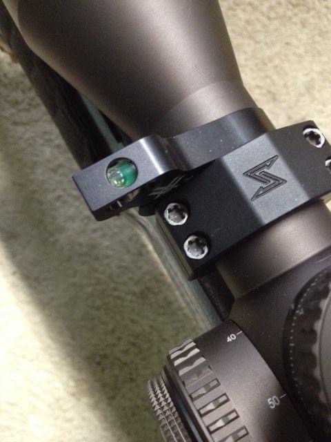

I have several of these on my long range rifles ... they are AWESOME (if you can afford the best).

I think so as you will know it’s level. I have seen too many rail mounted levels not be level due to machining tolerances. I don’t like levels on mounts as they are under the scope and you usually can’t see them when behind the scope. I mount mine so I can see it right over my parallax knob easily from behind the scope.
While SPUHR does come with a small level built into the rear of the mount, they are about worthless if you are trying to use them once you establish your cheek weld. I tried a level once but found myself not really using it so I took it off the optic.
