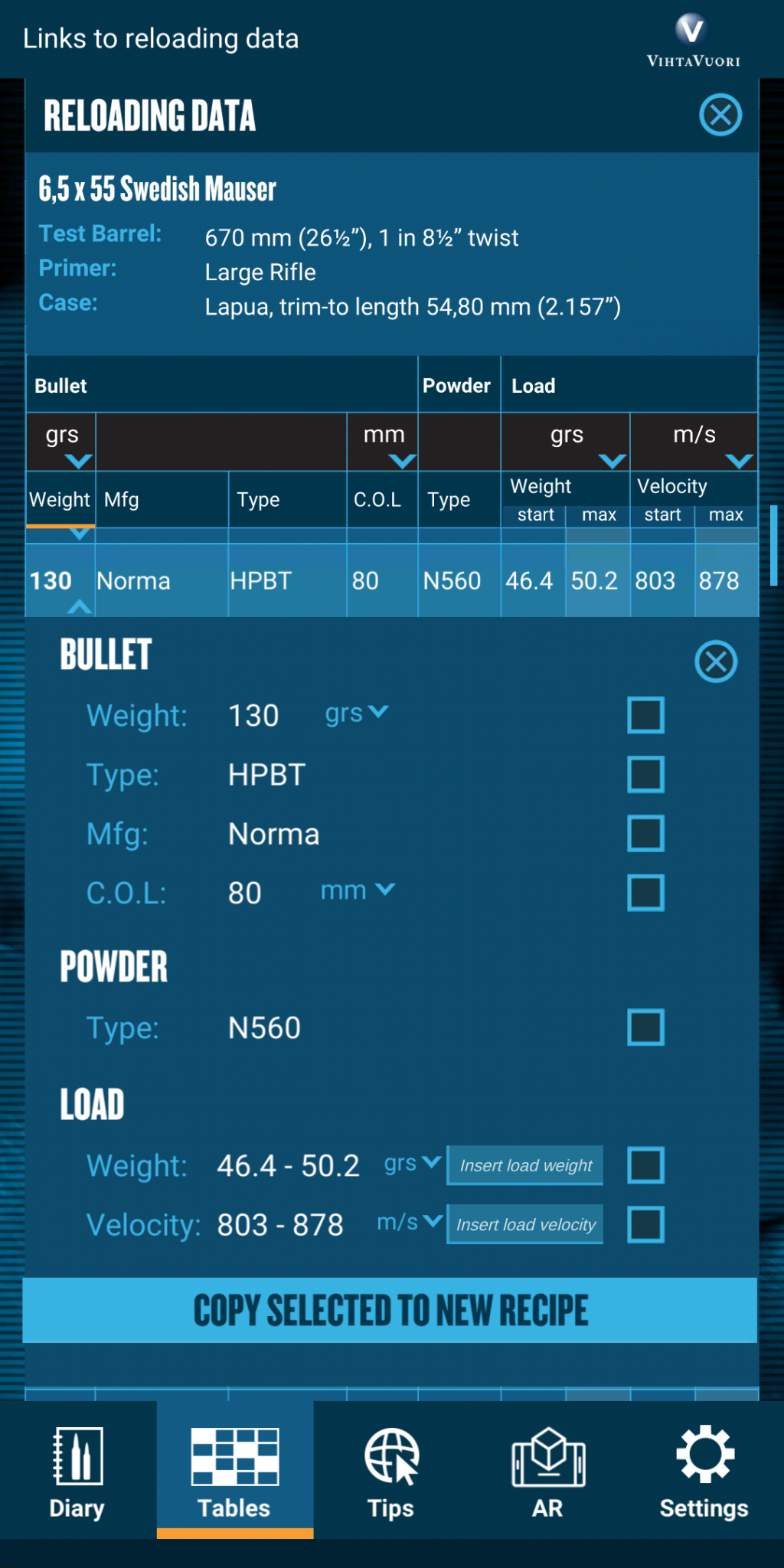

In Scandinavia the 65*55 is the standard. Way before anyone heard of creedmore😁
80mm have not been an issue in anyone of my rifles. But you can always reduce col. I believe factory Norma is 76mm but load data for same bullets are 80mm.
Not a bad idea to jump test and see what works best in your rifle.
Like I said vitavoury has load data on site and an app you can download.
From app

Yes, its a great round, I owned a 6.5x55 before the 6.5 creedmoor was in production or heard of. Researched the heck out of it before settling. I was a 270 fan and owner through and through before hand. I have the Vitavoury app and is awesome but no load data for Berger in the weight I purchased. I will follow what you have suggested. 80mm to start, low pressure charges, what could go wrong?? HaHa
