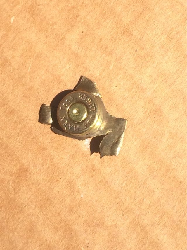

Hope everything is going well during this current situation (Covid-19). As for me, I was in the range today breaking in my newly build PCC (ar9) and at the 38th rounds the brass casing disintegrated inside the upper. Everything is fine, no damage to the firearm and no physical injuries.
Here's how the range time went down, the first 5 rounds (every round is barrel swabbing to remove the manufacturing drilling and rifling tool marking). The succeeding were 5 rounds, check grouping and adjust every run. Before the 26th round (6th run), I did another barrel swabbing. I notice (twice) in the succeeding runs that the hammer is not engaged with the sear. Until the 38th round, the brass casing disintegrated. I want your opinion on identifying what might have cause this malfunction. Does using a single endomag might have cause or contribute to the malfunction.

Can't make out the headstamp on the brass...I'm having a case failure problem with Browning once fired 9mm with loads well inside SAAMI limits...the brass appears weak just above the extractor groove despite fully supported chamber and shooting single shot...
The brass head stamp is Maxx Tech.
Questions for the OP:
  • What exactly does it mean that the hammer was not engaged with the sear? Would it not fire?

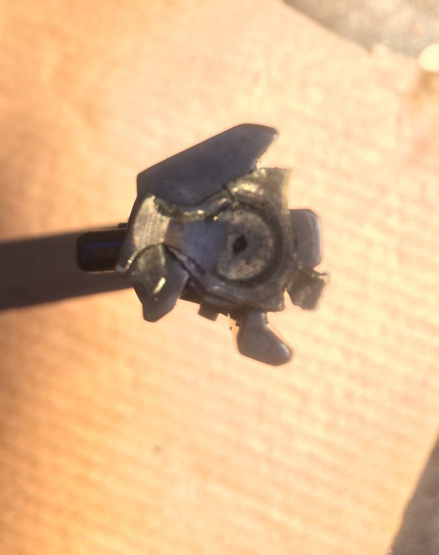

  • I cannot tell what the second picture shows. What is that?
As to the brass, it looks like that case was not supported when it was fired. Almost as if it wasn’t completely in battery when the firing pin struck the primer.

q1: Questions for the OP:
  • What exactly does it mean that the hammer was not engaged with the sear? Would it not fire? ----> will not fire / can't squeeze the trigger, i have to clear the round in the chamber and it will work again
  • I cannot tell what the second picture shows. What is that? -----> the second picture is the casing still held by the extractor / bcg

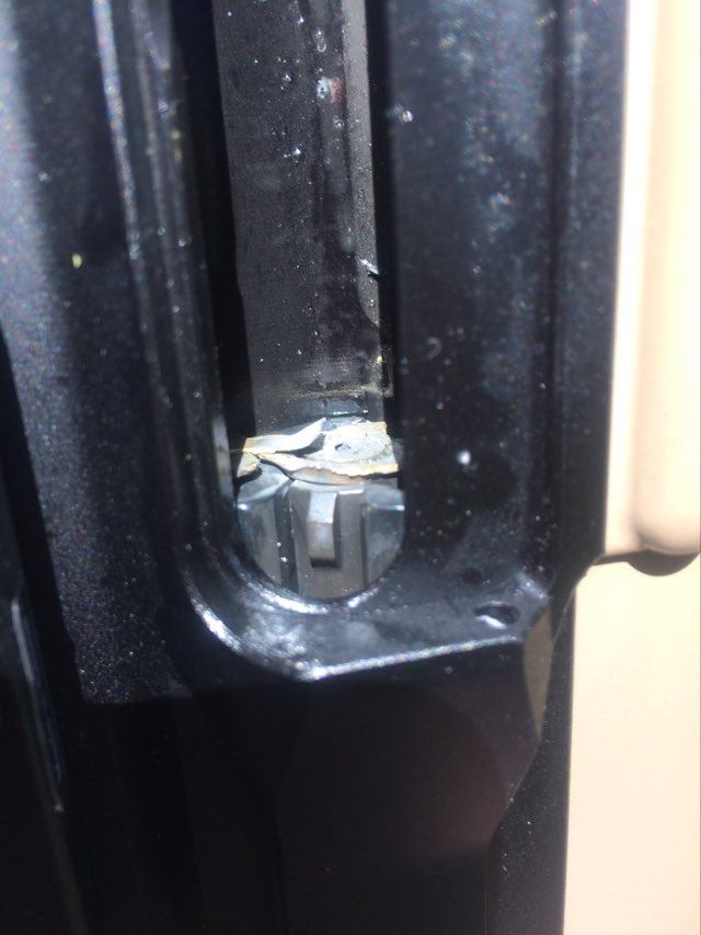

a3) just one round (38th round) and immediately stop. Tried to remove the BCG in the range but since the head casing is still held by the bcg, the bcg was a few millimeter inside the buffer tube and also not sure if disassembling the firearm is allowed in the range. Until I reached home that I reliaze that if I take both the front/rear takedown pin and have the upper slide forward, then I was able to remove the bcg.
