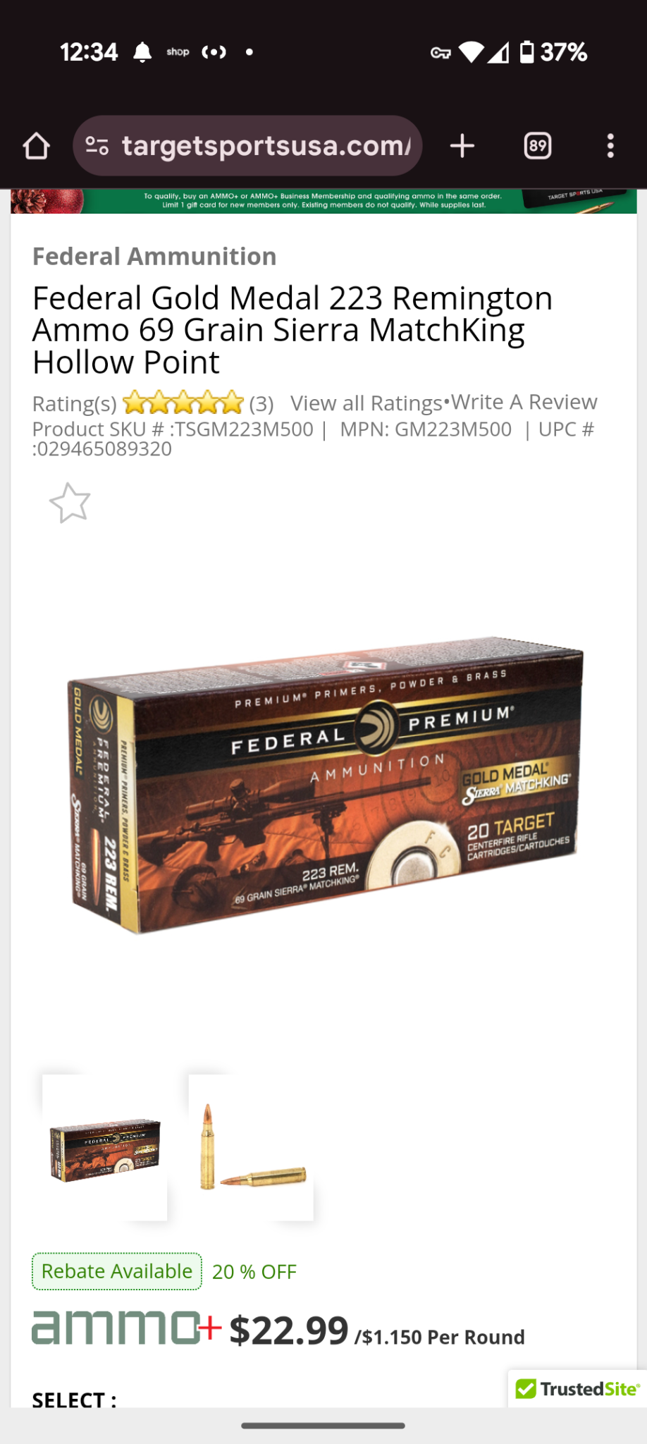

So this guy?
I'll put in an order.

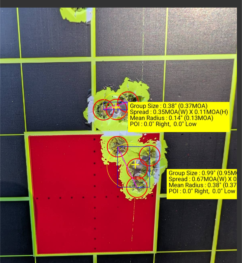

I had my LMT 308 out yesterday. Not knowing much about ammo and which ammo is best for her I was shooting 165 grain Hornady white tail 308.
My groups ranged from .38 moa to 1.05 moa when I did my part. Some were significantly wider.
The good ones I had probably would have been much better if I didn't keep getting a flyer or two.
I hope with better ammo and a better cleaning regimen to get some better results.
So please keep the ammo recommendations going!
