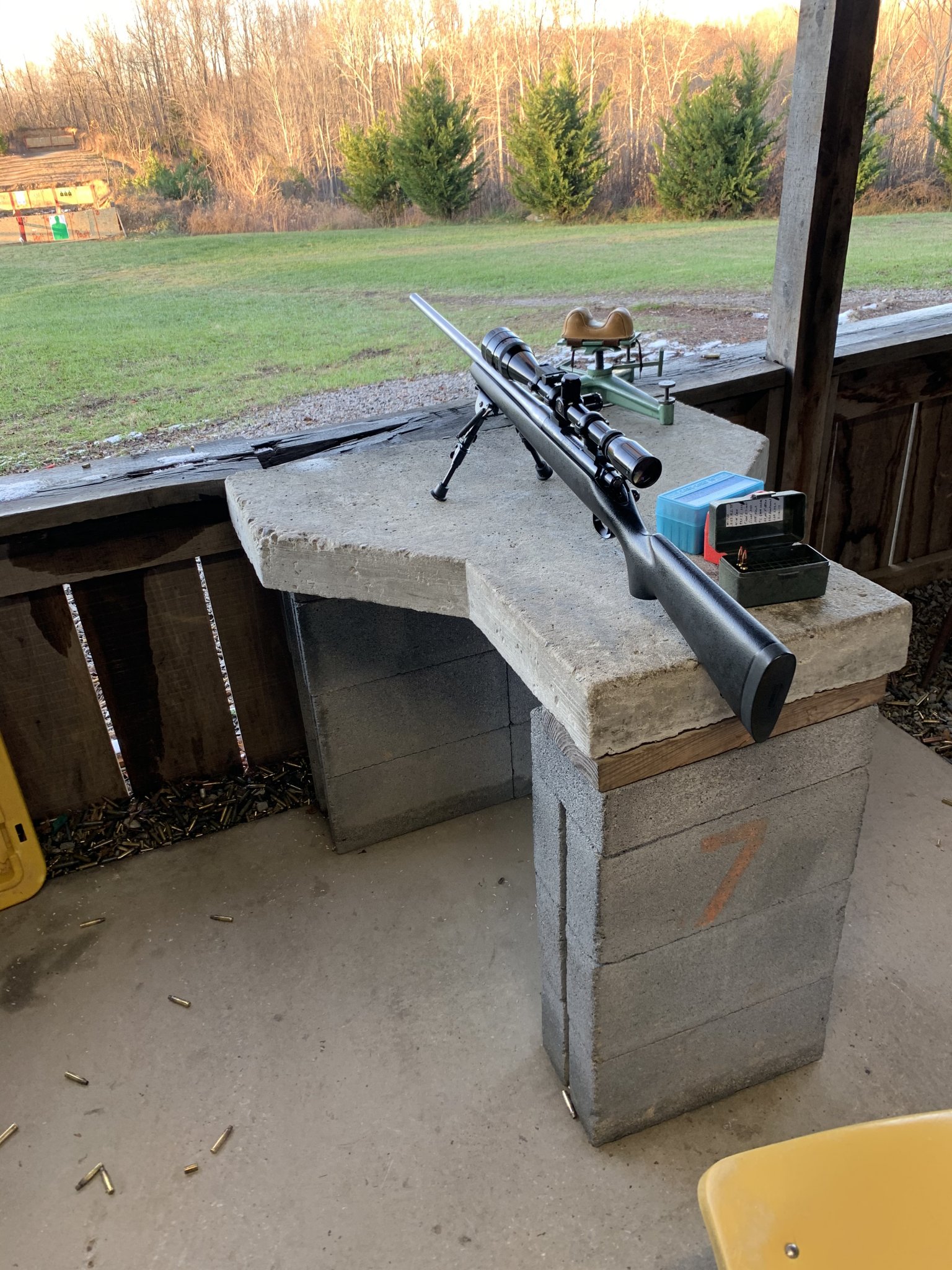

He was an avid shooter. He had tons of guns. I wasn't very close with him, as it was my grandmother's second husband. But it's still cool to have. I want something I can use moving forward though for sure.
Reactions: stello1001

Can't really tell from the picture but it doesn't appear there would be enough shank, big part of the barrel where it's threaded and screws into the receiver, to set it back and rechamber it to standard 223. If that is the case you really only have two options.
