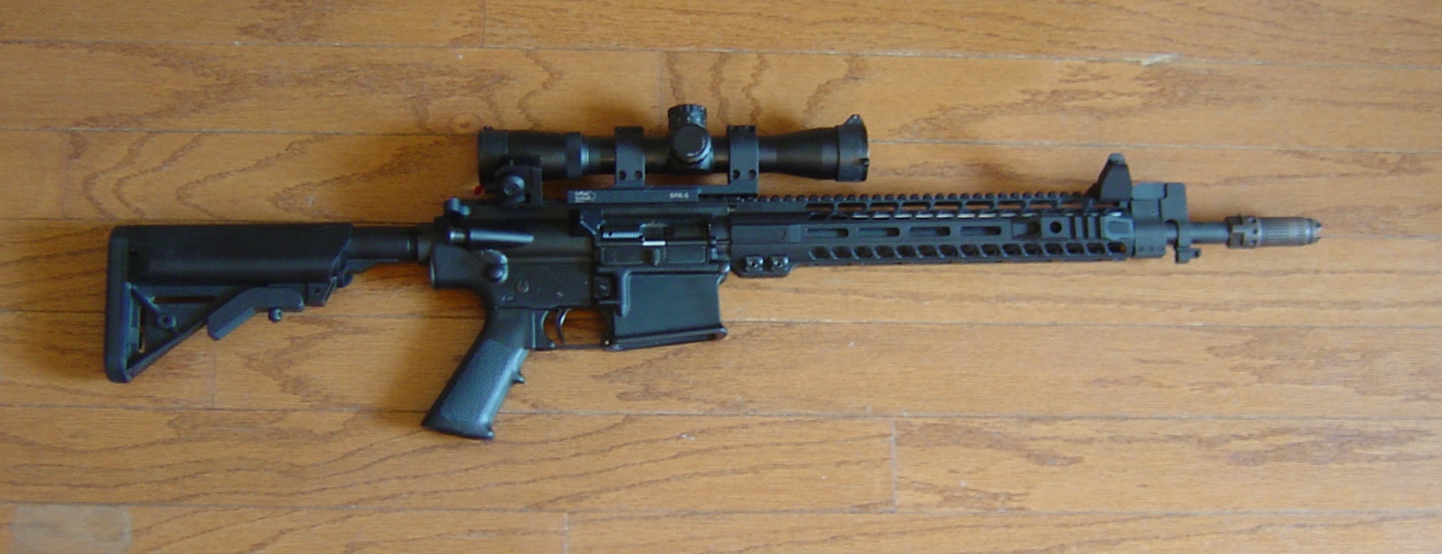

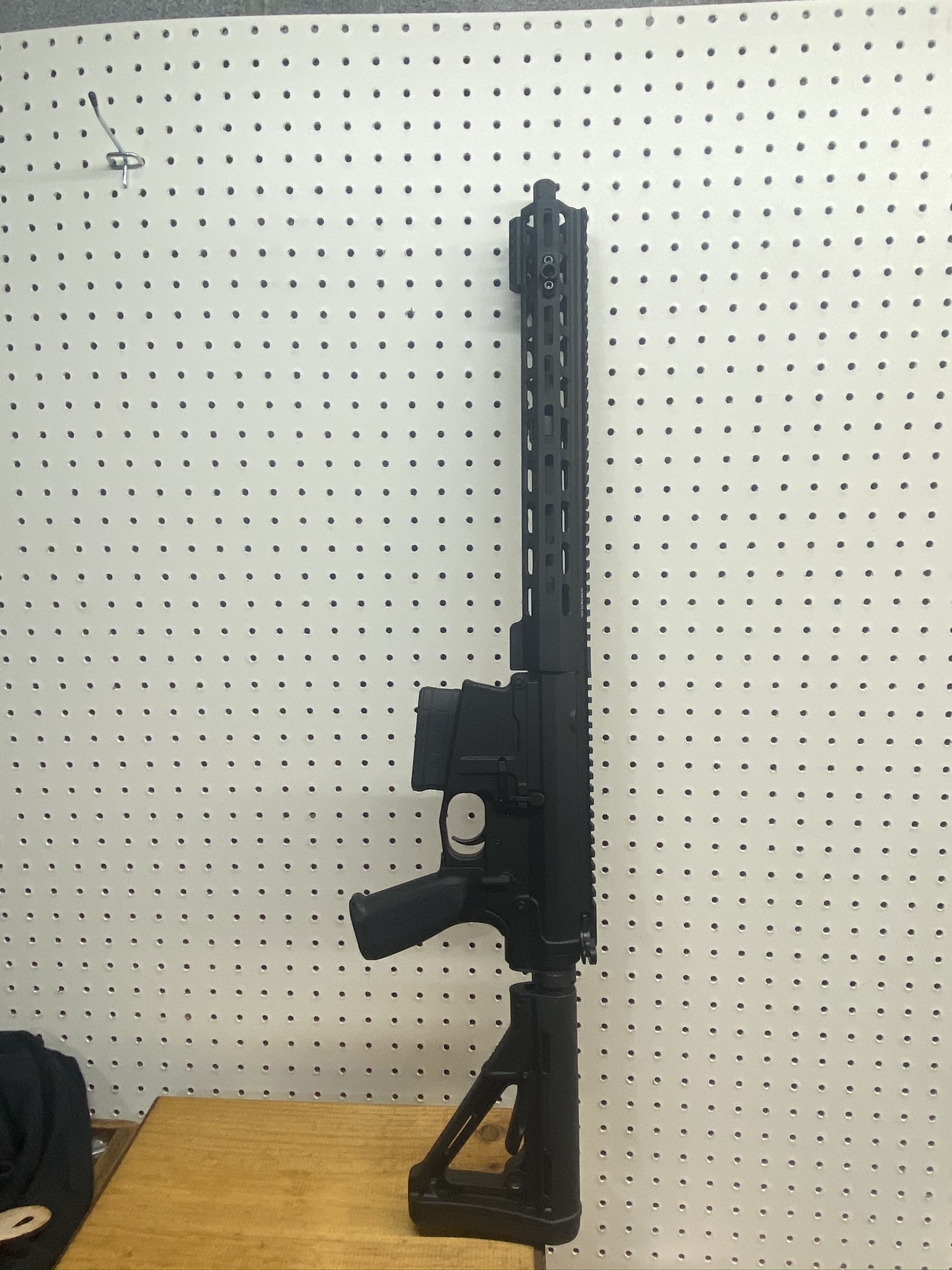

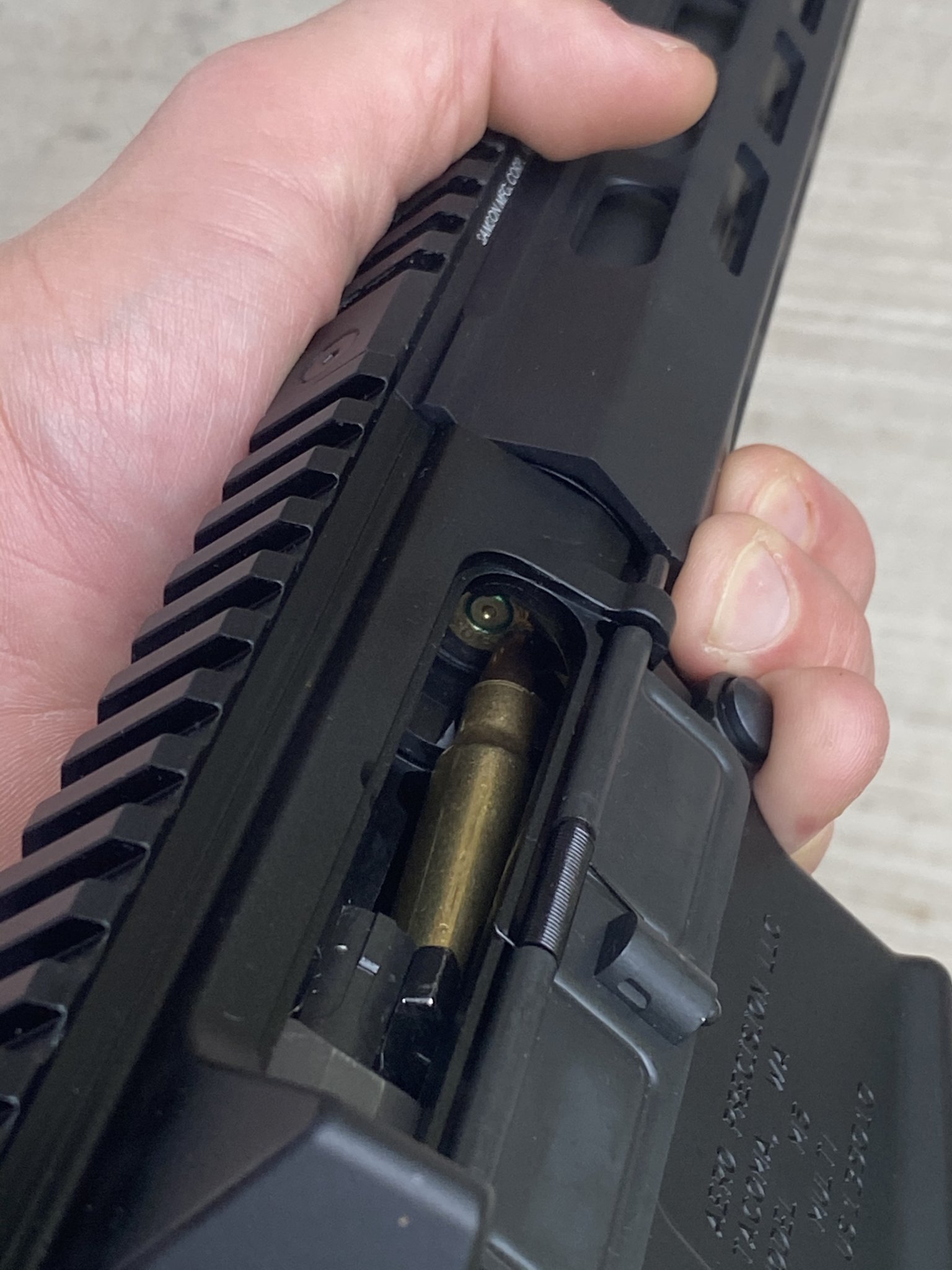

Hey guys, I’ll give my situation and any help you can give I would appreciate. I’ll give a list of my parts and go from there:
aero lower, vltor a5 buffer tube, Springfield orange buffer spring, h3carbine buffer 5.2oz, Gesielle ssa-e, aero upper receiver, dpms bcg, carbine length gas, 16”dpms barrel. .308
so when I shoot the spent brass stays right in the barrel and doesn’t extract. My bcg try’s to load another round that doesn’t make it into the chamber. I drop, clear the half loaded live round, and charge the bcg and let it go forward, when I manually pull it back it will eject the spent original case at that point.
I’m more of a bolt action guy so any help is appreciated. I don’t think it’s the buffer or spring ? I ordered a toolkraft dual extractor BCG hoping that will solve my problem. Any thoughts or direction? I don’t own a go/ no go gauge. The upper I bought was a complete upper off gun broker and the seller was vague but said it was built buy a reputable place and was on clearance so they were helping to move them.
Thanks for your time helping me troubleshoot this.

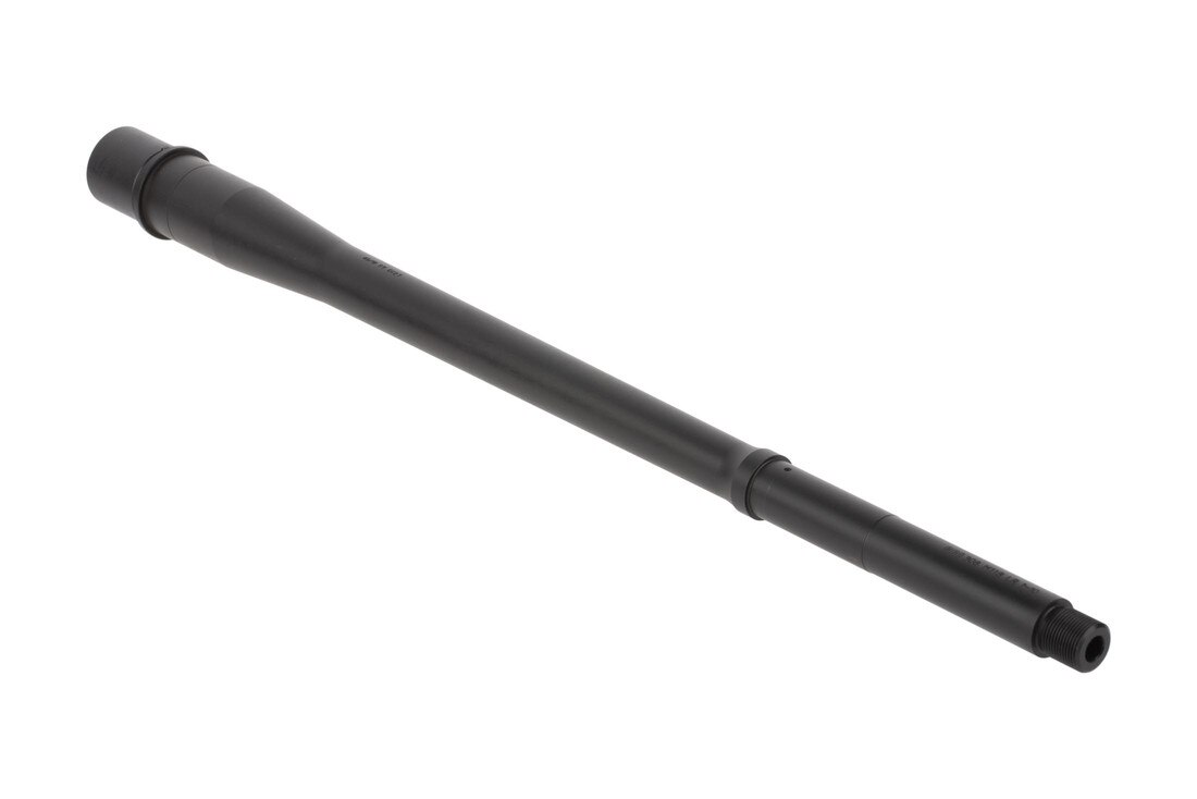

Carbine gas on a 16" 308, I bet it's unlocking while the case is stuck to chamber.

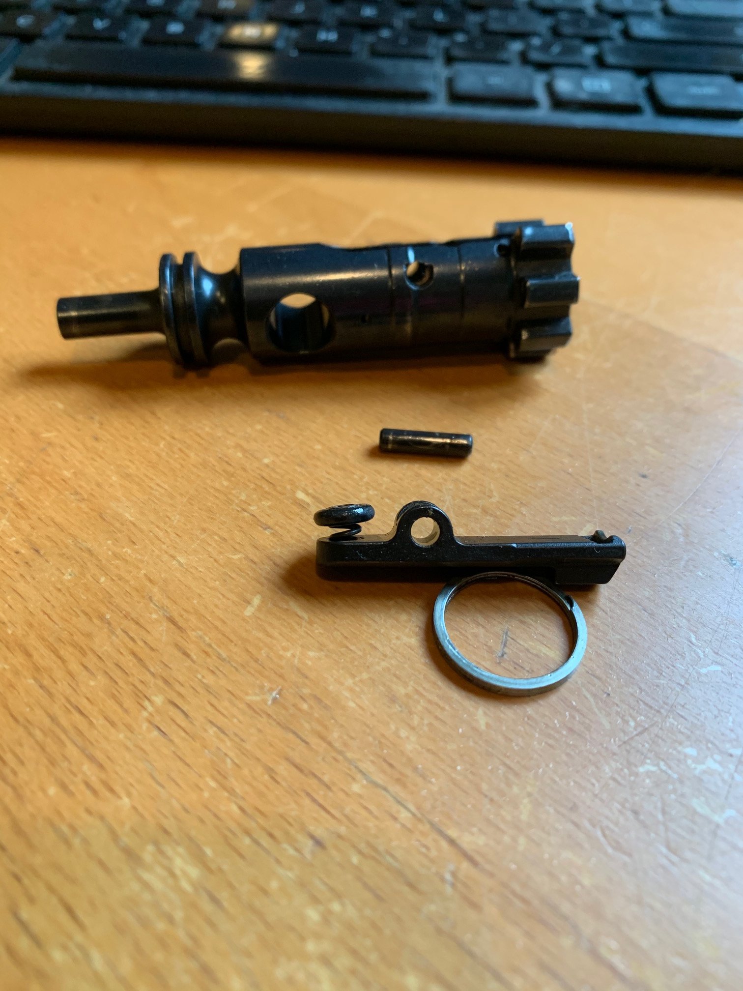

The first thing you should check is to confirm your extractor spring has an oring on it (it should)? If it does you'll likely have the same problem with the new Toolcraft. If it doesn't then try the Toolcraft before changing more parts. The Toolcraft extractors are sprung plenty stiff.
My money is on to much gas & trying to unlock to early.
If the Toolcraft doesn't solve it I'd do the following in this order.
1st - Add an adjustable gas block. SLR would be my choice.
2nd - I'd recommend an H4 carbine buffer 6.8 oz.
3rd - For a buffer spring I'd recommend 1st choice - ArmaLite #EA1095 rifle length buffer spring or 2nd choice - JP OSR 308 buffer spring + 7% pressure & OD ground
FWIW - I am running an A5 tube on mine with the rifle length Armalite #EA1095 and a Xheavy 8.5 oz carbine buffer. Mine is rifle gas on a 18" barrel though.
Reactions: UPSTATERAM
In an A5 tube try either the standard carbine spring or the Tubb spring for 30-caliber rifles.
Sprinco recommends the RED spring for 308s using A5 tubes and standard-length carbine buffers. The orange spring is for standard 7" 5.56 buffer tubes with shortened CAR308 buffers. They will slow the bolt carrier group from unlocking a bit, but will also slam the bolt carrier group forward quicker as well (out-running your magazine spring trying to push the weight of 30-caliber rounds into the feed-path , resulting in your described stoppages).
The short carbine and mid-length gas tube distances mean the pressure in the barrel is still rising / powder is still burning - creating expanding gas -- while pressure is trying to unlock the bolt and extract the brass while the case body is still obturated against the chamber wall. Check your case rims -- the extractor might be trying to rip them off the base of the case.
From Sprinco:
"RED Spring": EXTRA Power Buffer Spring, Best option for 16"+ 5.56 barrels with carbine length gas system platforms with standard front sight towers and H buffers, 16" + BBL gas piston guns, *some* suppressed shorties,and later generation Colt LE6920's, 9mm, 6.8 SPC, 6.5 Grendel, .458 SOCOM, 450 Bushmaster, .500 Beowulf, and assorted "Thumpers" using standard 7" depth M4 extension tubes. AR-10 Carbines (E.G. Armalite, Noveske, LMT) using deeper extension tubes and standard length carbine buffers to accommodate the longer .308 BCG also use the "RED" Spring. Please call us to discuss successful historical "recipes" for implementation of the RED spring in .308, 6.8 SPC, etc. RIFLE length extension tube platforms. Color Coded RED. NOTE: NOT for use in .308 Carbines using standard 7" M4 extension tubes and short, stubby buffers. (Use our "ORANGE Spring" below for that specific platform approach application.) NOTE: If you have a seriously overgassed .308 Carbine which has the deeper AR-10 platform receiver extension tube running an H3 buffer firing 175 Gr. Projectiles and / or suppressed, many shooters have experienced success using the "ORANGE" spring, as it is still heavier than a "RED" spring in that application.
"ORANGE Spring": The ONLY specifically engineered EXTRA POWER Buffer Spring for .308 Carbine Platforms using standard 7" Depth M4 extension tubes and .308 short 2.5" buffers (Including aftermarket "heavy buffers.") You cannot clip coils from any other commercially available buffer spring to yield the proper spring loads for this application, especially in heavily gassed .308 carbine platforms. We started from scratch on this design to provide Operators with a viable alternative to existing OEM and aftermarket offerings. Platforms known to exist using this approach include DPMS, Bushmaster (Post 2010), Remington, CMMG, Mega, SA Defense, Colt 901, Rock River Arms and many others. Color Coded ORANGE."

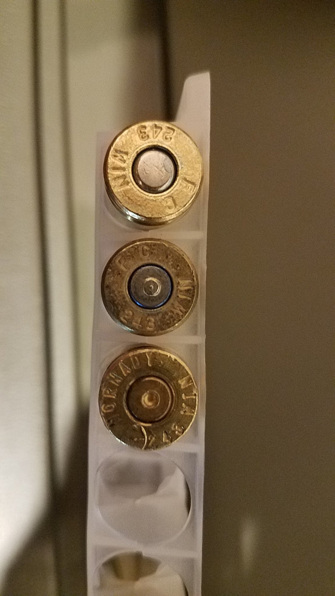

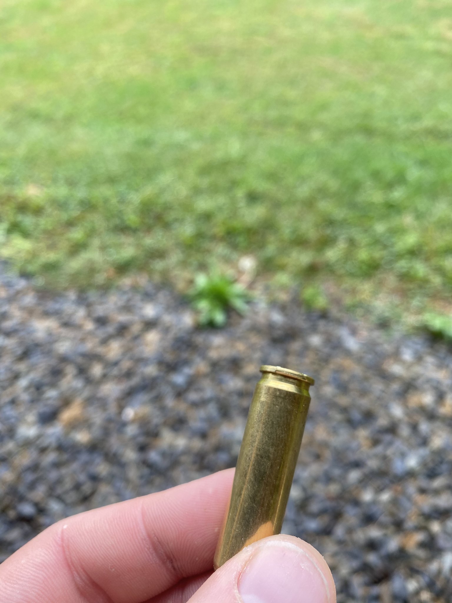

What does the head of the spent case that stays in the chamber look like? Pics of that would help.
I’ll take some shortly. I don’t know if it’ll be a true help since I had to manually charge it and pull the bolt back to extract the Empty shell. I’ll take a few pics shortly.
@sinister yea that makes sense. adjustable gas block being an option too? I’ll try this toolkraft dual extractor and and see where that leads me. I thought it was odd to have a 7.5” gas carbine but I got the complete upper for $699 which I thought was solid. I tried asking what port diameter they drilled but the guy who sold it said the builder doesn’t give that for some reason. I don’t have the tools to measure properly either. I won’t run suppressed since I’m in the communist state of NY. “Upstate” at least.
Make sure your barrels chamber is clean. If you could...Post a pic of a fired case , looking for any scuff marks.

@357Max Okay cool. The oring is pretty clear to see around the extractor spring? Sorry for the noob question.
Hopefully the toolkraft works. Will changing a bcg mess with fitment of the bolt and how it’s supposed to fit?
Thanks for the spring recommendation. I didn’t know a rifle length spring would work with this but that’s good to know when troubleshooting this setup. Also my carbine length gas block is mine is 7.5” if that’s meaningful at all.

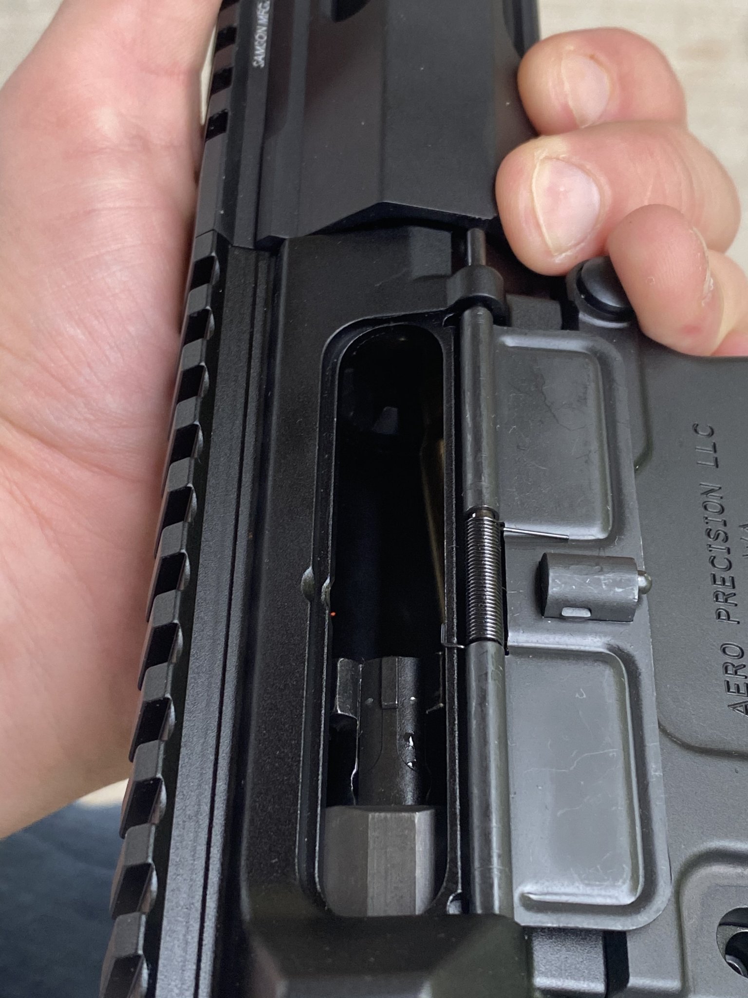

Yes the oring will be obvious. Pictured below is a Nitride Toolcraft extractor. As always you should check headspace with a Go gauge (with ejector removed). That said changing BCG/bolt should not affect fitment. Unless you've ordered the Boron/Nickel/trick coating flavor of the week. Those coatings can cause problems with head space. Nitride coating does not add much to the surface & is one of the better BCG coatings. DLC is best adding only .0001
Tom, it sounds as if your chamber is properly dimensioned and the extractor and ejector work as designed. I don't think there's anything wrong with your bolt carrier group.
This points to the gas system and your pressures. I'm interested to hear what your gas port size is, knowing it's already carbine-length.
If it was my rifle I'd swap barrels for one using a rifle-length gas tube, and an XH buffer for the H3. There's probably a reason it was on clearance.
A good gunsmith can salvage it by welding or capping the present gas port and locating and drilling one further out for a rifle-length tube.

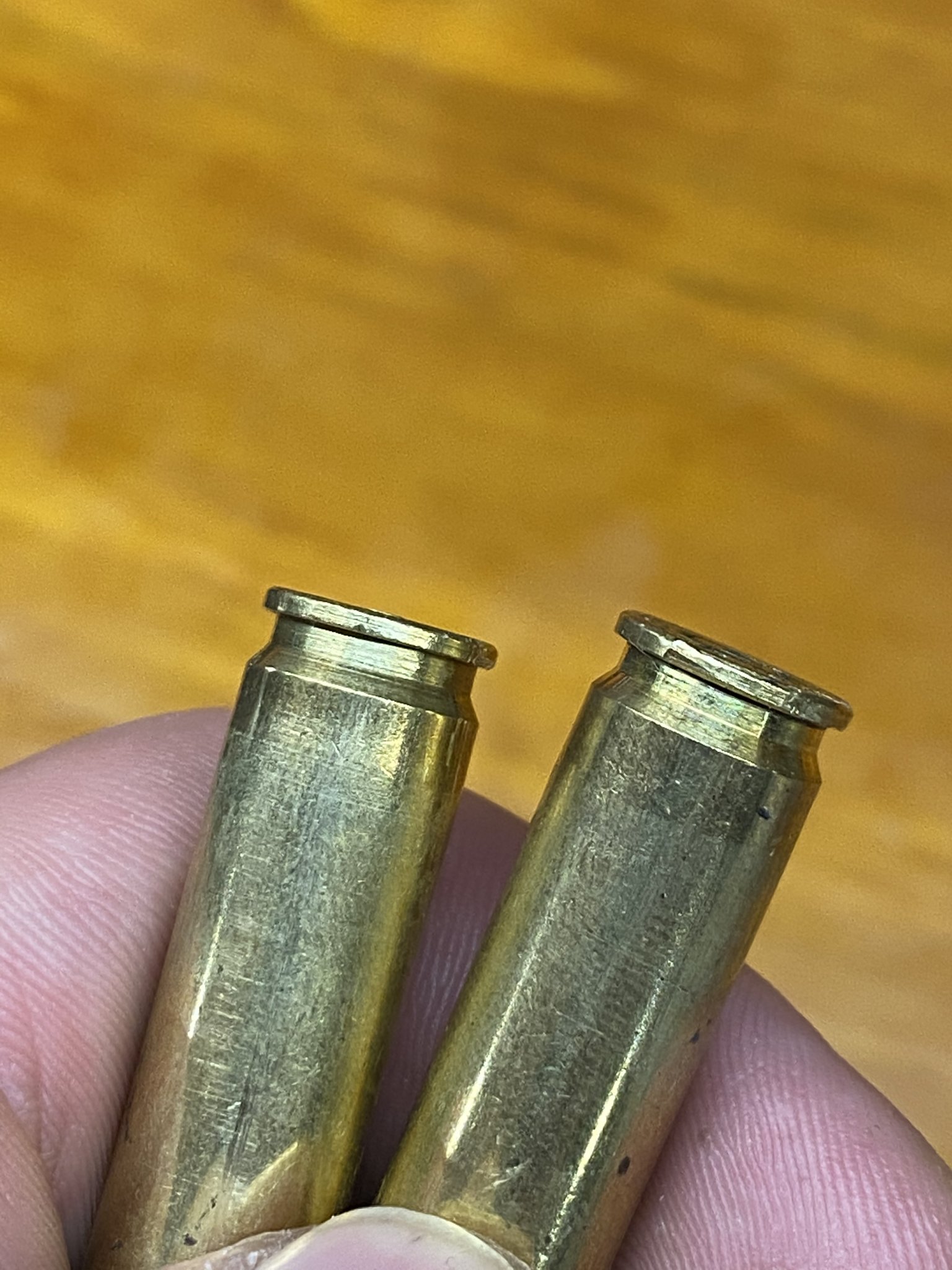

That makes total sense. I inspected all 6 pieces of brass and none has many marks at all.
I’ll try a a new buffer spring and see if this toolkraft helps the situation at all.
After seeing your pics, and I don't see anything bad, I'd still clean-up that chamber a little.
Doing that will "aid" easier extraction.... and allow your tuning to be more effective.
In for any gas port size readings... this will help decide the best solution.

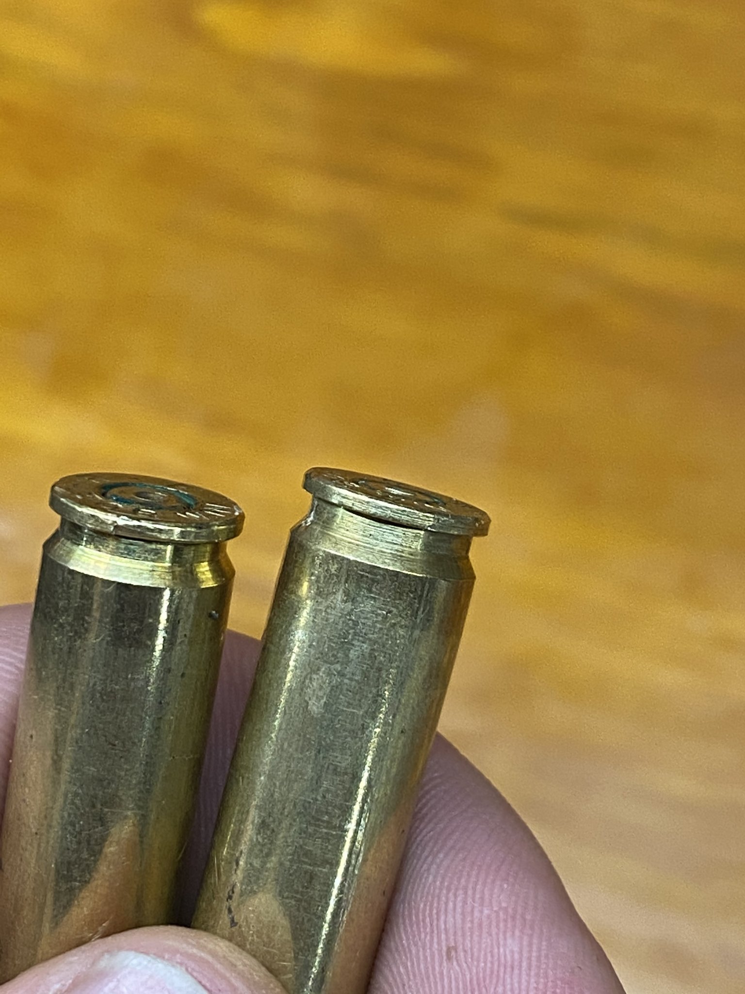

Looks like a pretty rough chamber, and timing might be off just a bit and unlocking early.
For comparison purposes, a few pics..
Top to bottom: unfired, overgassed, correctly adjusted. Note pressure signs on the primer- it's extreme and yours isn't that far out of whack. Hard to see, but the 8 to 10 o'clock position has a bit of smear and the rim is warped. Not a big obvious gash.
L to R: unfired, overgassed, adjusted. Rim damage is a bit clearer, with lots of carbon blowback. This was one of the ones that barely extracted, and the damage to the rim is similar to one of your pics.
My suggestion is to polish up the chamber and go with a stronger buffer spring for starters.
@Bolo thanks for the pics, I can see what you’re saying. Your brass that barely extracted is pretty similar.

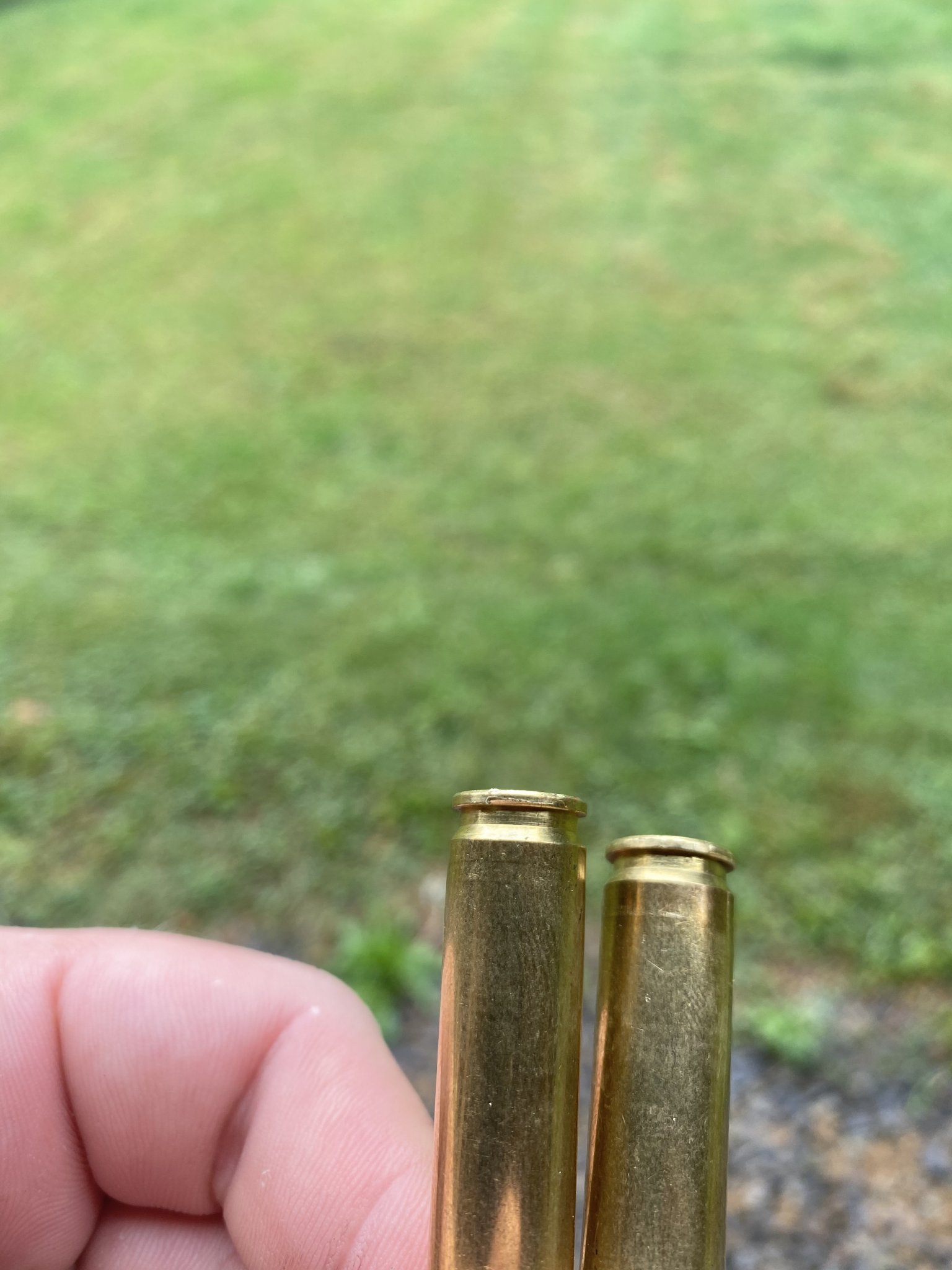

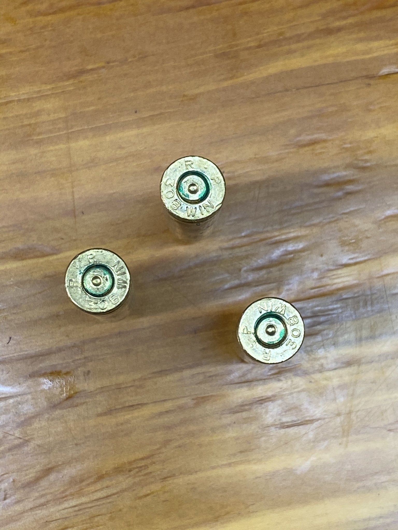

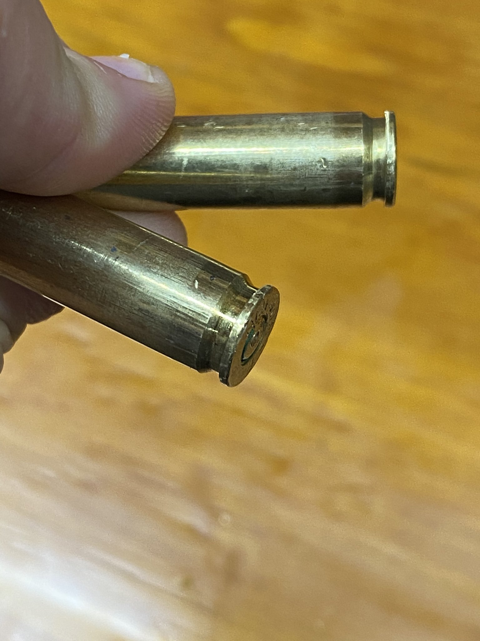

@sinister @357Max @Bolo
I shot 3 this am I’ll attach pics. First was a single round. It didn’t stayij the barrel it ended up almost over the empty magazine but slightly before it The 2nd round didn’t come out and was in the barrel I took pics as it sat. I shot the 3rd round and it wouldn’t come. I recharged the BCG a handful of times and it wouldn’t come out... ? I have to
Wait until I get home to put a cleaning rod down the barrel to pop it out.
Does this help at all?

Remove your bolt from carrier. Pull the extractor out of your bolt, it’s easy just put pressure In with your thumb tO relieve spring pressure and push the pin out with a small punch.
Take photos of the spring & of the lip portion that grabs the shell.
Regardless if the oring is present, beefing up the extractor is lipstick on a pig.
Needs less gas, delayed opening.
Even if you change barrels you’ll not regret the adj gas block and heavy buffer purchase.
Good looking rifle.
Certainly looks like a short carbine gas problem.
The hardware all seems to be doing its job as designed. The extractor claw is trying to pull the case out but rolls off the rim after trying to yank out the case while the brass is still swollen and in friction-contact with the chamber.
Again, a good gunsmith might be able to salvage this particular barrel. Mid-length may work OK since you're not suppressing the gun, while rifle-length gas would give you the most benefit. Besides not functioning, when you shoot it how's the accuracy? Worth keeping?
To get this rifle humming you're going to need to balance some patience and money. You have lots of barrel options (to include trying to salvage this one).
Primary Arms carries this 16-inch rifle gas Criterion for $278.99:
Something I didn't notice on the original pics, and I can't tell if it's camera tricks or the real deal... it looks like the case is wider in the rough area compared to the shiny clean area just forward of the case head.
Can you get a caliper on that and tell me if I'm nuts?
If the middle of the case is ballooning out, I'd think that chamber would be no bueno.
