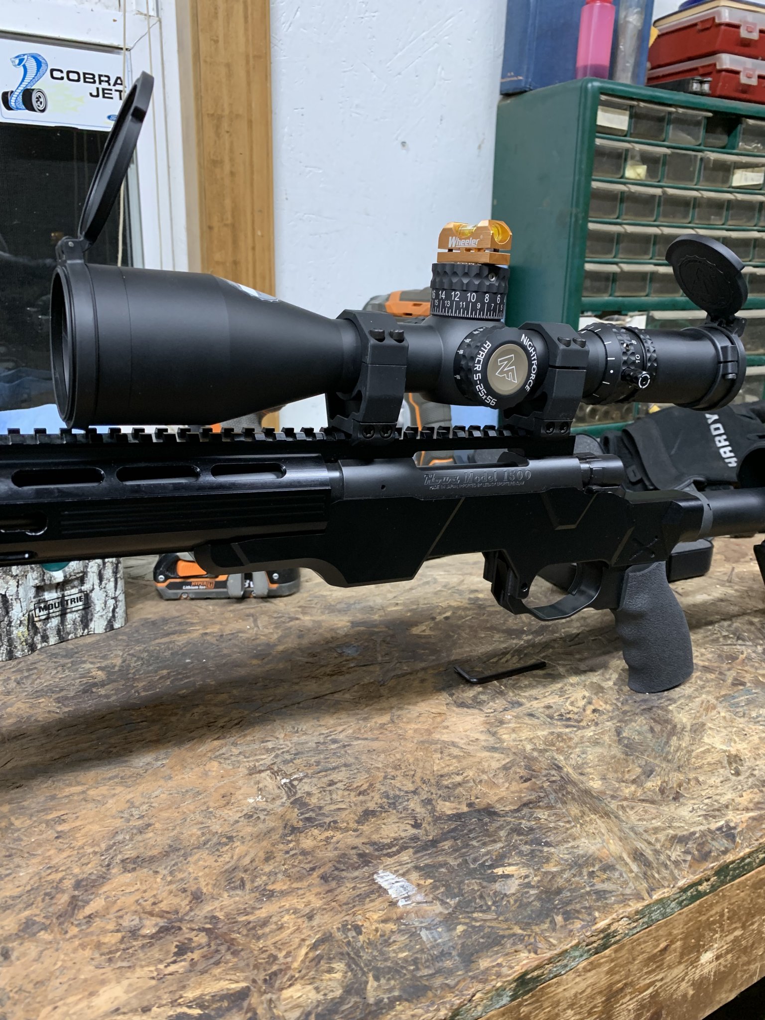

    Here is pic of the setup

    I wouldnt guess it’s the rings. Gotta be the barreled action in the chassis, or just the barreled action(crooked base hols, action face, or a wildly screwed up barrel).

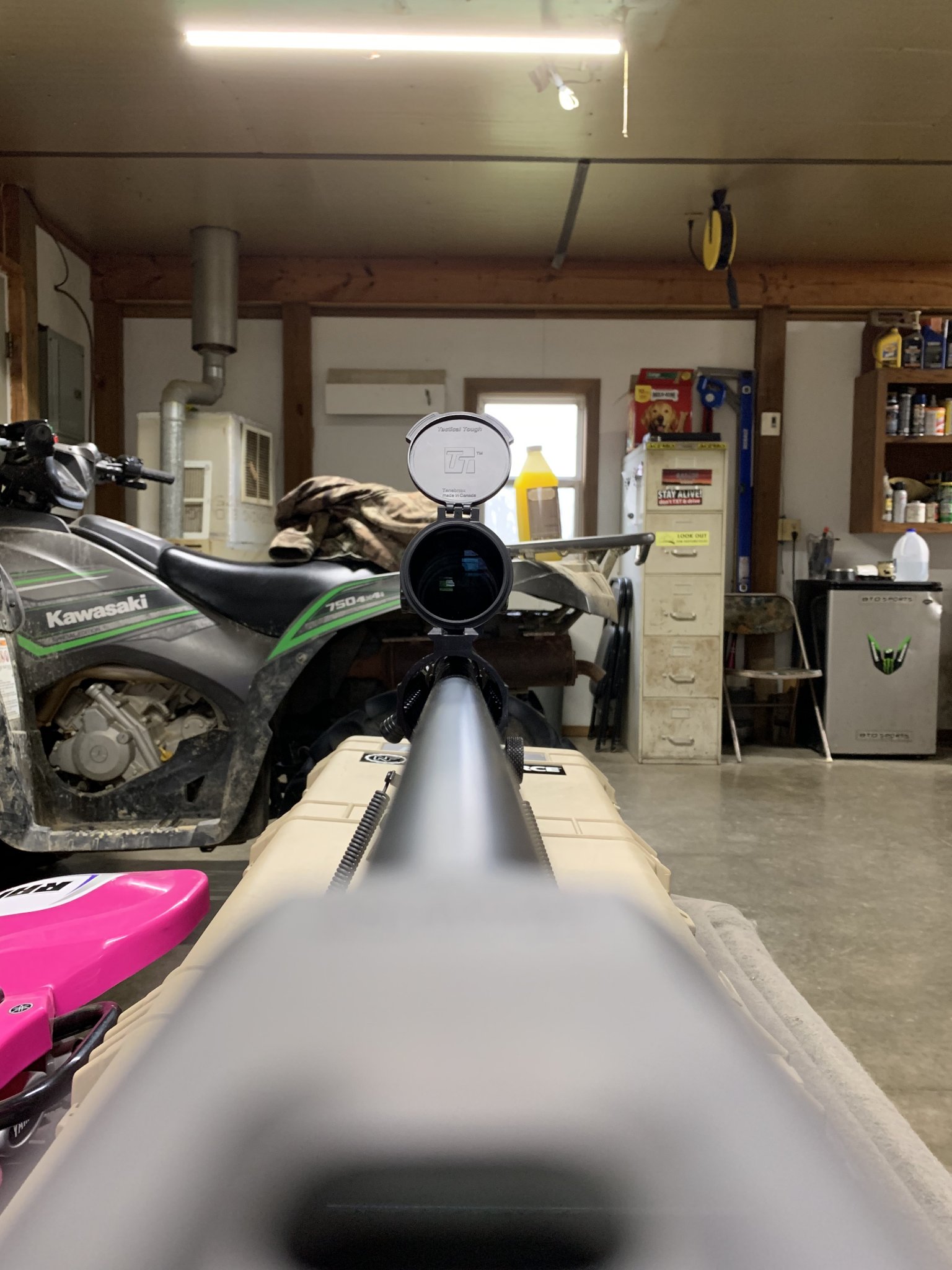

    Do you agree that there is a pretty serious misalignment between the scope rail and the barrel, as viewed in the picture? Use the gaps on the sides of the barrel, or just the scope rail and Zick pointed out. Pretty obvious.
    I see exactly what you’re saying supersubes and I measured it and the left side from the shooter perspective the barrel is 1/8” closer to the chassis than the right side

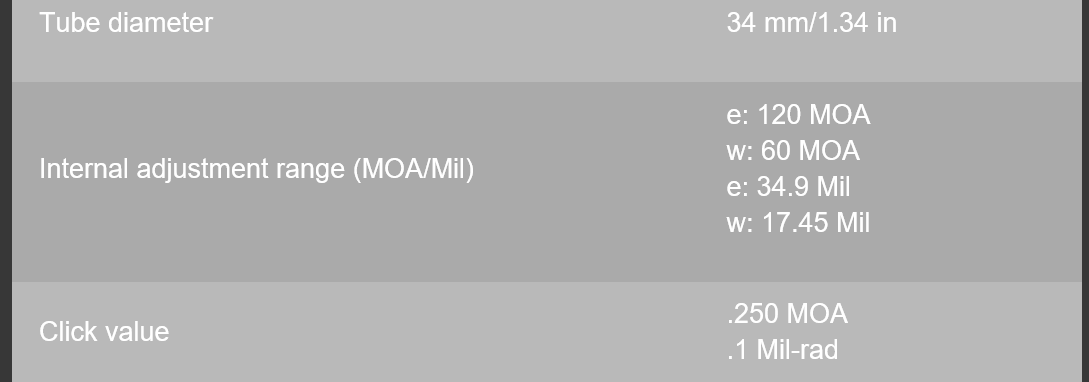

    Yeah I am only getting 15 moa of adjustment to the left and 15 to the right and it has a total of 60 Moa of adjustment so it has to be the stops
    No they did not but they all did shoot to the left from the start. as supersubes stated the barrel is sitting in the Chassis to the left and I measured and it was an 1/8 in difference
    You may want to address that before going further with the scope. I would loosen the action screws and try to center the barrel before snugging them down again. May not work, but worth a try. In the pic you posted, it looked to me like the scope was off-center as well.

    Right, but how would loosening the action screws and readjusting it do anything? Scope still pointed in that direction.
    The barreled action is not centered in the chassis. Maybe I'm looking at it cockeyed but in the first picture it looks as if the rail is part of the chassis. If that's the case, getting the action centered will help by not requiring as much windage adj. If the scope base is separate and not part of the chassis, then please disregard all previous statements. ;)

    The chassis is 2 seperate pieces and the what you guys are seeing isn’t all one piece. The action has its own rail sepeprate
