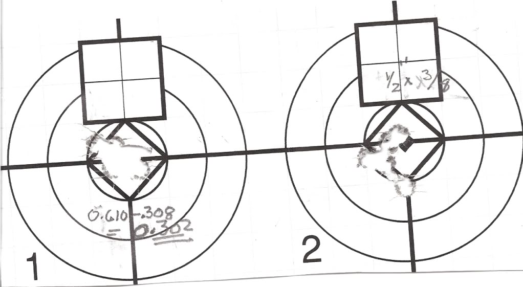

I'm a fairly newer hand loader as well. I was faced with the same decision, progressive or single. I opted to go single stage. I simply don't have the time to load bulk pistol. I shoot .40 S&W but not to the point where I need to justify bulk reloading. I do however shoot precision match about 70 rounds a week. My choice was the RCBS Rock Chucker master single stage kit. It is a rock solid very well built press, and there's a $50 rebate on a $300+ purchase. I scored my Chucker on Ebay for $300 shipped, so my net cost was $250, awesome deal for someone like me starting out from nothing. I load .223 and .308 match and am very happy with the RC kit. My main reason for not going with progressive presses was the initial complexity which as a new hand loader would have made my learning curve more frustrating. Your in a tough spot as you want to load bulk pistol and match... you will most likely end up owning both styles of press... LOL
I use my Dillon 550B for my precision loads. I take the the case out at the 2nd position, throw the charge with an RCBS Chargemaster waiting until it cycles thru the round count to see the final weight. Usually right on. Then add or subtract if any additional powder is needed. Reinsert then seat with Forster micrometer die an very lightly crimp with Lee factory crimp die. I also loaded some 308 rounds on my Rock Chucker and found no difference in group size. Below is a typical group I now get with my TRG 22 once I settled on my go to load. I use 168 SMK's, IMR 4895, Winchester primers in Lapua brass. I have the Dillon 1200 trimmer on my Rock Chucker now.

In the 308 Win.......I agree with everyone IMR 4064 at 41.75 with 175 Sierra MK and fed GMM brass with Fed 210 Match primer
The 3 best powders that I have used in the 308 Win.....IMR 4895, IMR 4064 and Varget
