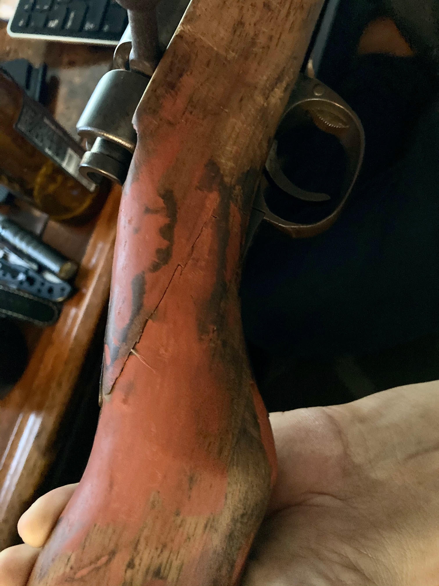

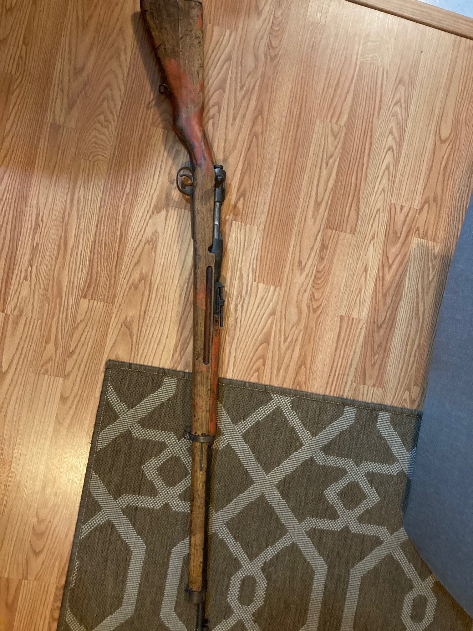

A family member found an Arisaka Type 38 no mum, tokyo arsenal in a foreclosed home closet. It looked like crap until I got some of the surface rust off and cleaned the action and decades worth of dead spiders and insects and webs from the barrel. I was surprised how good the barrel looked and got an itch to see if this thing shoots. The bolt body was intact and after a good bit of cleaning I was able to get the bolt removed and thoroughly clean it out. Found a firing pin assembly online and safety knob and from what I see, this gun should run just fine. My issue is a crack through the grip of the stock. I am not a formal gunsmith but I think this is an opportunity to learn some stock restoration. No intention of selling this and just want it functional. So before I hunt for the stock on Ebay I want to see if anyone has any tips even if its "don't waste your time trying to restore that." Thanks in advance.

The crack.
Spread it withOUT having it go further.
Fill it up with good wood glue.
Wipe off squeeze out with warm water.
Wrap it tight with surgical rubber tubing.
Reactions: jd138 and RTH1800

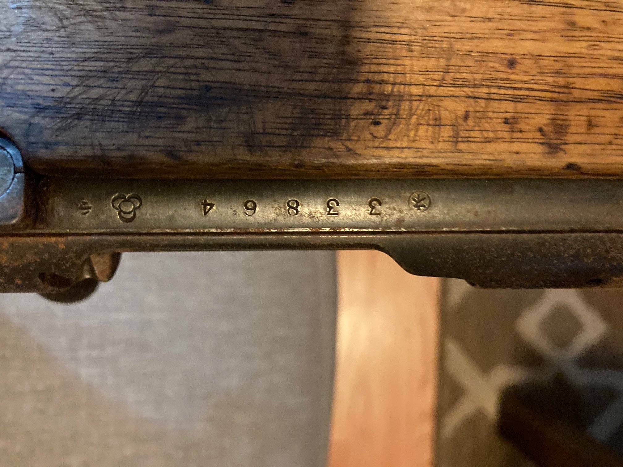

No such thing as a "last ditch" type 38. The OP's was made at Tokyo Arsenal, so DOM would be before 1934. Post '34 the Arsenal was known as Kokura.
Also no type 38's had chrome lined bores.
The stock finish is called Urushiol and bush from which it is made from is in the poison oak family. If you're allergic to poison oak sanding a Urushiol finish will cause you to break out.
From the pics the stock looks to have severe water damage and may even be rotten in places.

Im not 100 on jap rifle years but Tokyo arsenal also made parade rifles which are unsafe to shoot.
Could be wrong but worth a double check
fill the crack with glue like Pmclaine explained, then reinforce with some all-thread.
Came to make this exact suggestion once I saw the crack. You do NOT want to be firing that rifle or any rifle with a crack in the wrist area like that with just a glue joint holding it together. The joint will eventually fail in shear and send the top half of that rifle straight back at your face with a nice sharp freshly cracked stock as its leading edge. It needs reinforcement as outlined in the quoted video.
That said looking more closely at some of these pictures, I will send that it looks water damaged. Id be wary of rot.

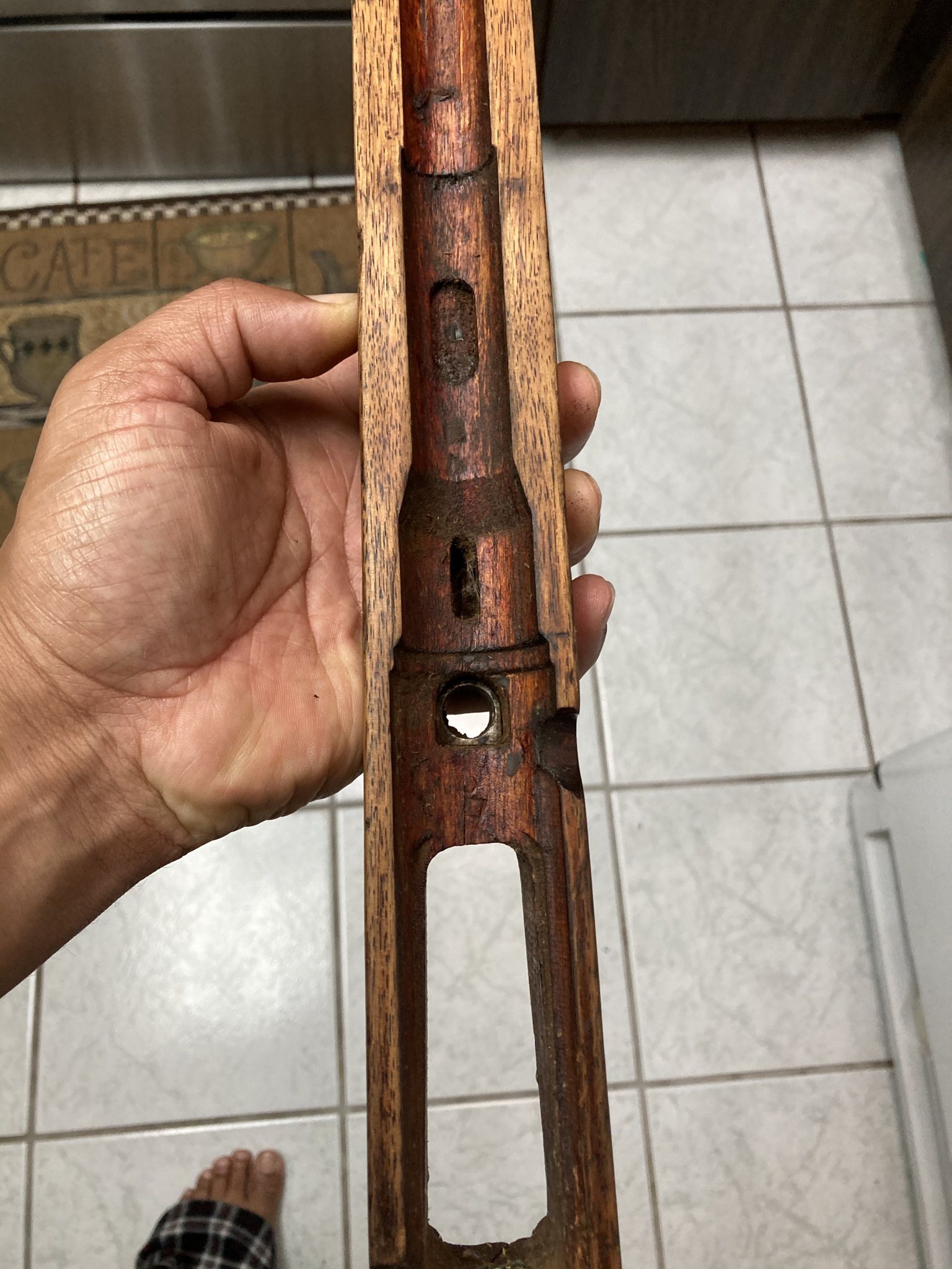

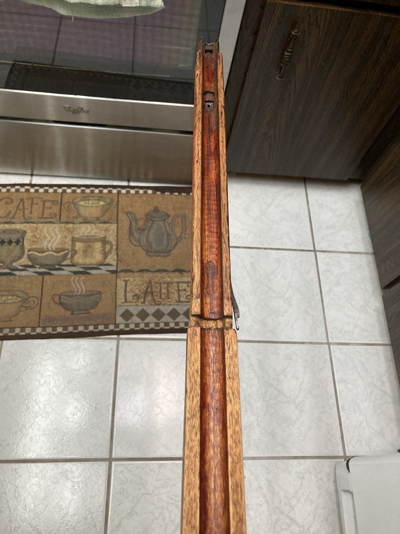

Here is the stock. Looks like rot through grip. Any solutions or need new stock? Leaning toward new stock but curious about any tricks out there.

Your stock is repairable. I've done worse. It needs to be done professionally as it will need to be reinforced internally and the external cracks made as transparent as possible. If your not concerned about originality look for a replacement stock. Should not be difficult to locate in USA.
Ron (Canada)

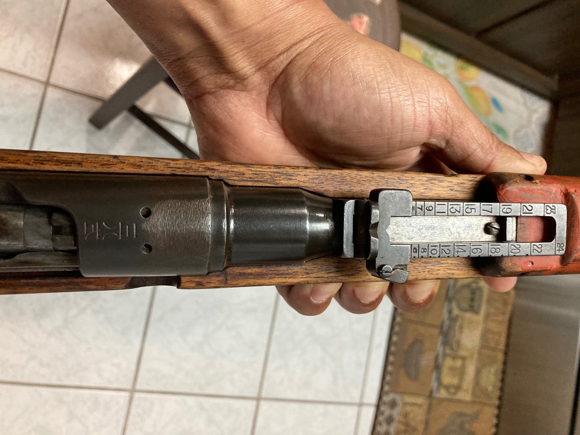

The more important question is, does your receiver still have the mum or has it been ground off?
Some military guns have particular bedding issues, like the SMLE/No. 1 MkIII. Ground mum. I have no interest in accurizing this gun, I just want to get it into a state of being safe to fire and to look the part of being a Type 99.
