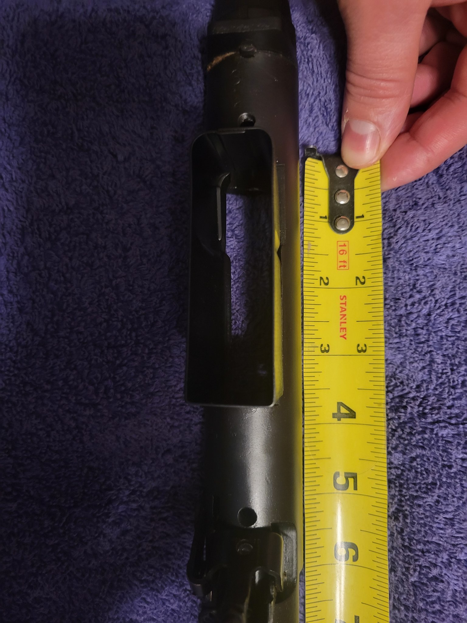

Need help recently purchased a mdt chassis for this gun now returning it because I'm being told won't work. I have a savage 110 308 staggerfeed Long Action top bolt release, non axis, mounting bolts for action are just over 5" apart on center. Does anyone no of a way to modify chassis to work? Or a company that makes one? Thanks all

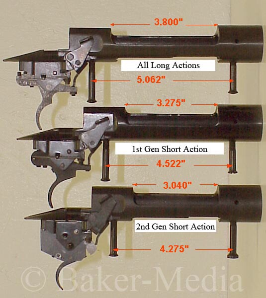

I have several Savages, 12FV in .308, an Axis in both 6.5 CM and .308 and an Axis in 30-06. Was told that long actions start with 30-06, and CM and .308 are all short actions, regardless of rifle brands....
Yes this picture shows my exact spacing. But being it's a 308 chambered in LA, MDT says this though "It will physically fit into the Savage LA inlet however you are not going to be able to use a magazine in the chassis"
Why wouldn’t long action 30-06 AI mags work?
On the old 11X series they were all long actions but the receiver bottom isn't cut for the longest cartridge it will take.
You can see it in his pic with the internal magazine liner.
I don't think it is impossible to modify one, just don't know anyone who offers the work.

IIRC everything was long action from around when they filed for bankruptcy in 1988 lasting to 1998 when they started calling short actions Model 10, 12 etc.
I have 112 in .223 that is a long action but with the .308 size cut out, the magazine liner has a spacer in the back and lips sized and positioned for .223
This is good info guys. Exactly what I'm trying to figure out. I see that people have just placed there action into the chassis and scribed the area on the receiver that needs to removed. Then cut area out. Just nothing about how to accommodate the mag at that point.
The MDT use the AICS 3.715" length mags for Savage long actions.
The cut in the receiver would be to allow the top of the mag and feed lips to present into the action. The mag is held in place by the chassis.
Where you are getting into the unknown is how much to cut and if that length .30-06 mag will work as is or can be modified to feed .308
With a DBM the receiver doesn't need the cuts to hold the liner like yours has, it needs the clearance for the top of the mag to present the cartridge.
Doesn’t the mdt uses aics mags. If so you can feed 308 through a long action mag with a little adjustment.
So If I'm understanding what your saying. I would most likely not have to modify the receiver all that much. More just figuring out how to modify the mag?
Oh no, it's going to require cutting the bottom of the receiver quite a bit.
It may be worth your while to buy one of the .30-06 AICS mags so you can see where you need to cut.
