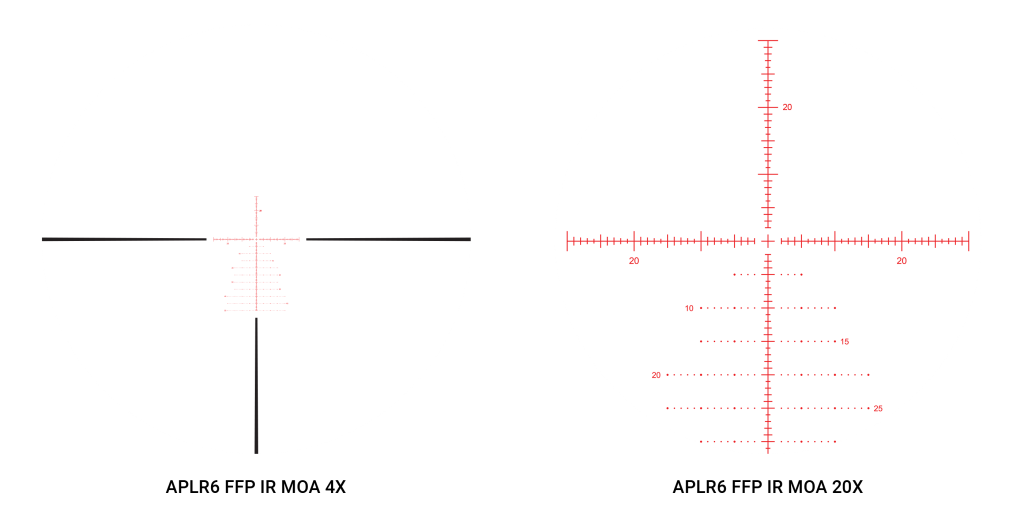

So I did find the Athlon 4-20x50 Helos BTR Gen 2 30mm Riflescope which ticks A LOT of the boxes, but the MOA version has the weird floating crosshair in the center and the MRAD version has the center dot. Am I missing something or what?
Does anyone have experience with the floating crosshair in athlons scope and do you like it?

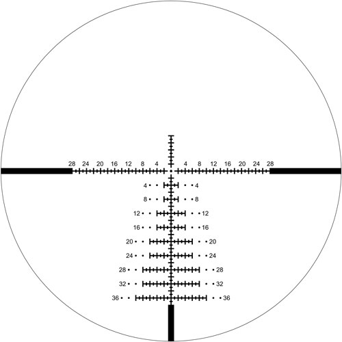

Hi - Just a suggestion. I bought a Covenant (cabelas/BP) 6-24x50 FFP-SF MOA in 30mm. It has a 'center-dot, but the MOA hashmarks are numbered which helps making 'holds' for diff ammo, etc. Fine hair reticle and FFP variable size. I had a Bushnell Engage Deploy 6-18x50 SFP-SF w/MOA in 1", but the hash was not numbered and I had to 'count' bar to get correct holds. I'm using these on a B-22 SV (Not SR) which is the heavy barrel, that I just have about 500 rounds thru. Still getting used to the 'new' scope, but w/ the Bushnell I could get around 0.5" @ 50yds most of the time with average ammo like SK+.
