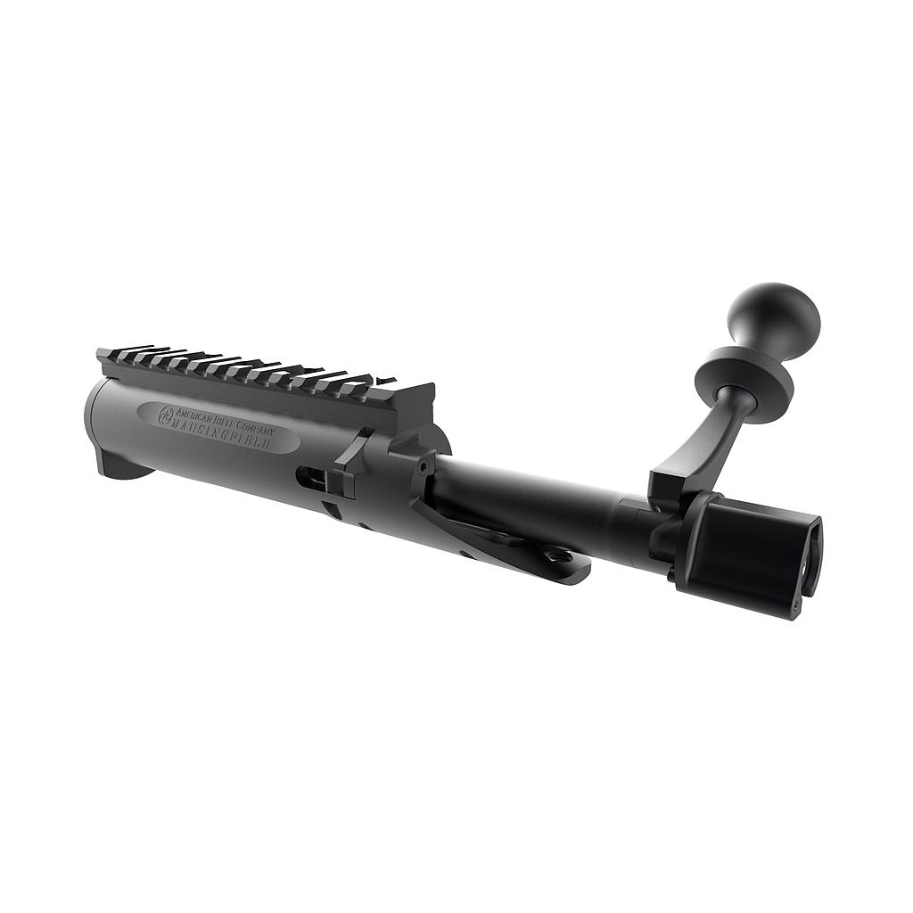

Op, if you’re asking an open ended question like this I’ll list my dream rifle. I’ll try to live vicariously through anyone
Long action Mausingfield with at least the 3 largest bolt heads. This gives you the flexibility to shoot cartridges ranging from the BR Norma all the way up to Lapua Magnum & Tubb XC rounds.

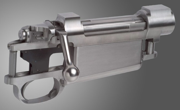

What I would want in a custom long range action is:
Integral Rail, and choose what MOA you want.
Integral bolt handle.
Integral Recoil lug.
Flat bottom
AW cut out mag well
Two Stage trigger
Found a photo of an Surgeon XL... but Kelbly Black Bear and maybe others have these features.
Still the most expensive actions made today, a Custom Mauser M98 action, costing $5-7000 each has:
Integral Mounts
Integral Bolt handle
Integral recoil lug
And these where first made in 1890s..
Anything else, is a downgrade...
