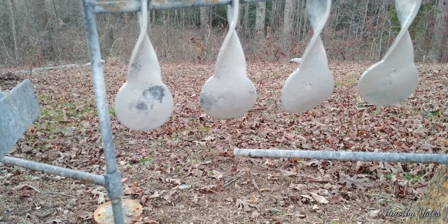

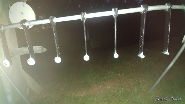

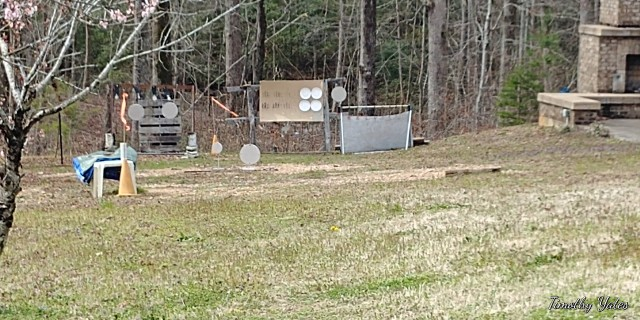

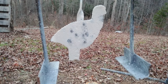

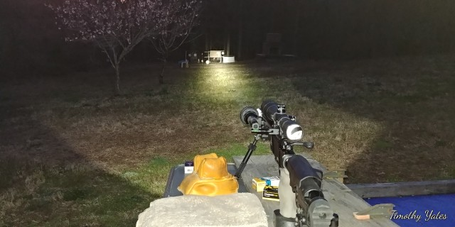

I have had a Vudoo in the Grayboe adjustable stock since January and shoot it off my back deck almost daily. I probably have 15 different rear bags including both you mentioned, and the full sized Gamechanger in waxed canvas gets used the most (you might consider the sticky hybrid if you intend to compete in the future). I bought a 5000 round case of CCI Standard Velocity ammo along with a couple of boxes of every premium match ammo I could find to see what my rifle likes best (so far I'm about half way through the CCI and haven't tried any of the others, which I will do if I decide to do an NRL .22 Match). I occasionally shoot paper, but mostly steel. I bought the 50 and 100 yd. KYL racks from Sturkis here on the hide, both .22 spinners from D&M Targets and a puzzle/wind target from Fry Targets. Some of the best $ spent was to order additional magazines from Vudoo for a total of 10. Stopping to load mags while shooting is a PIA. I load at night and shoot during the day. I really enjoy the steel targets, but some of the best training is shooting at small rocks in the dirt of yonder hillside (+/- 180 yards). Have fun with your Vudoo!

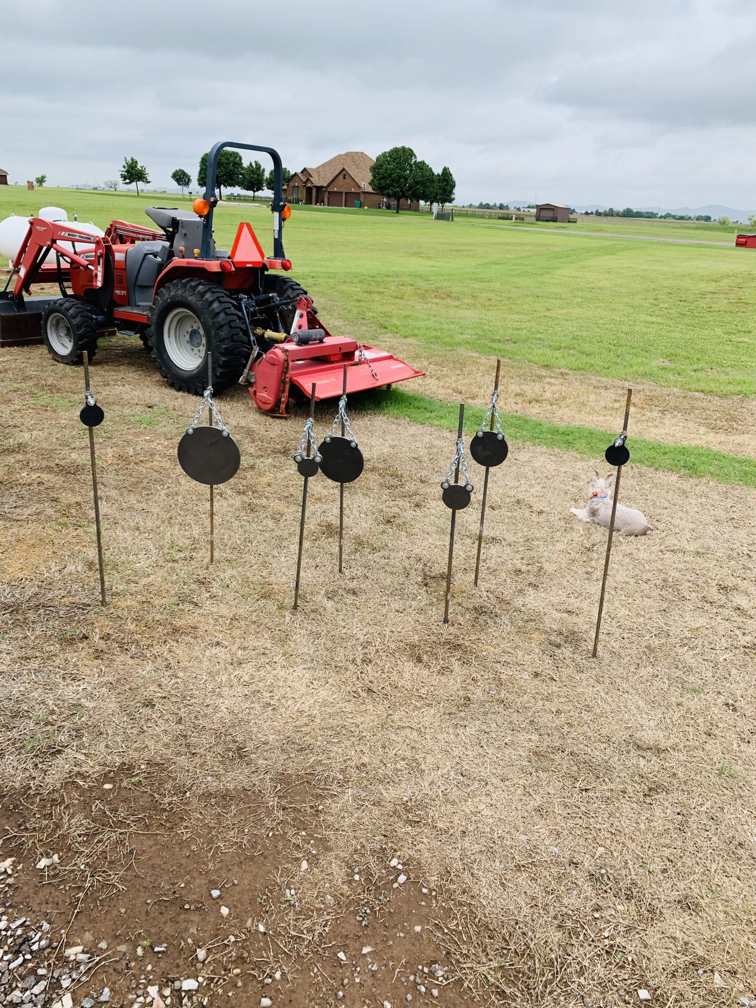

Targets we use Shepard’s hooks and buy animal steel targets with no base drill hole in animals and hang them quick and easy.
I made a Kylee rack for about 50.00 it is so much fun.
Also saw blades hanging on Shepard’s hooks are very nice for long range the really ring.

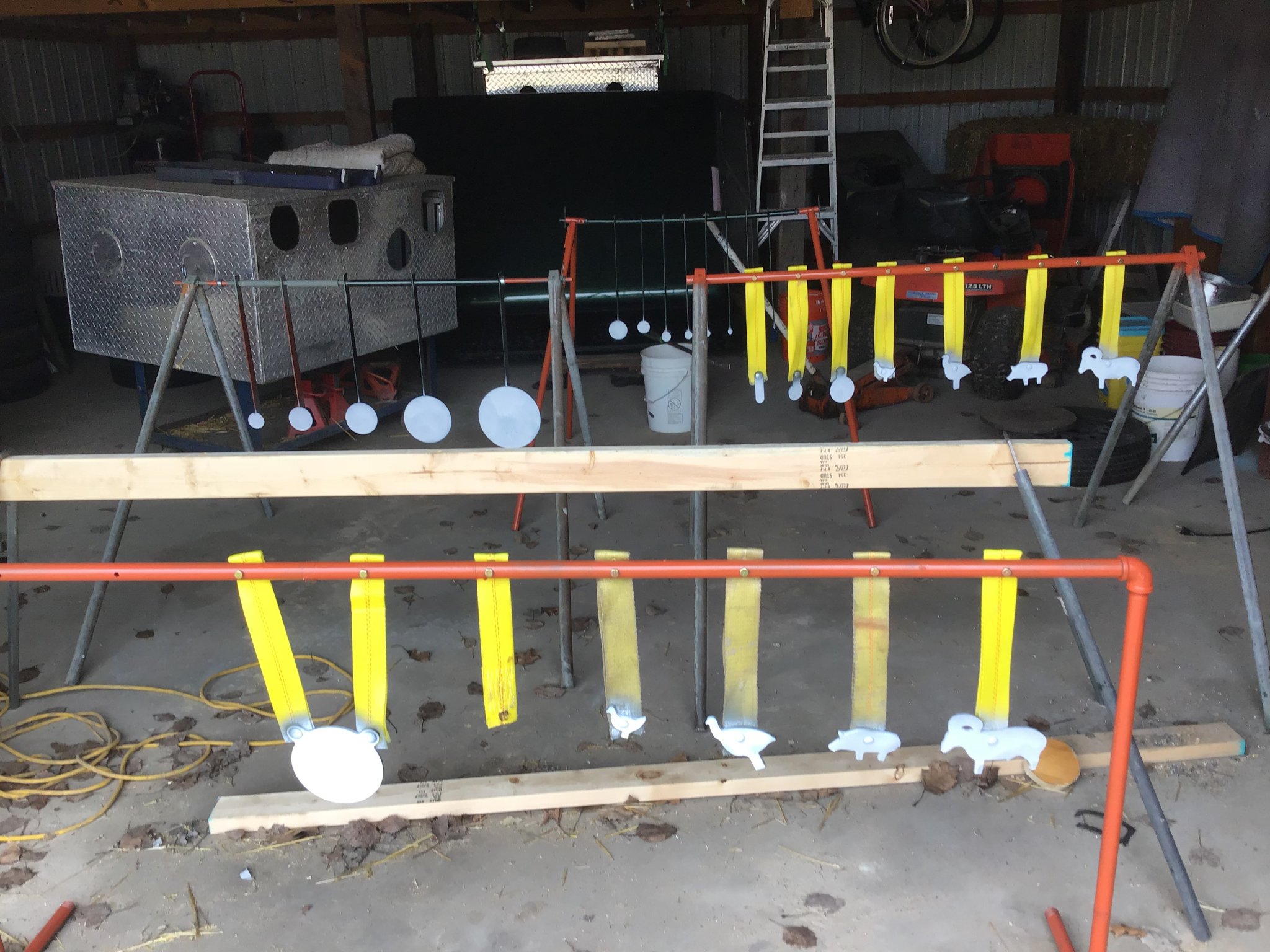

A center hit will spin the 5/8" it several times. A edge hit will rock it, but not spin it. The others will spin with any hits. I have a full kyl, but find it is a cake walk at 50 yds until you get below 1" target, I found myself just shooting smaller targets. so I built this one for 50 yds shooting.
