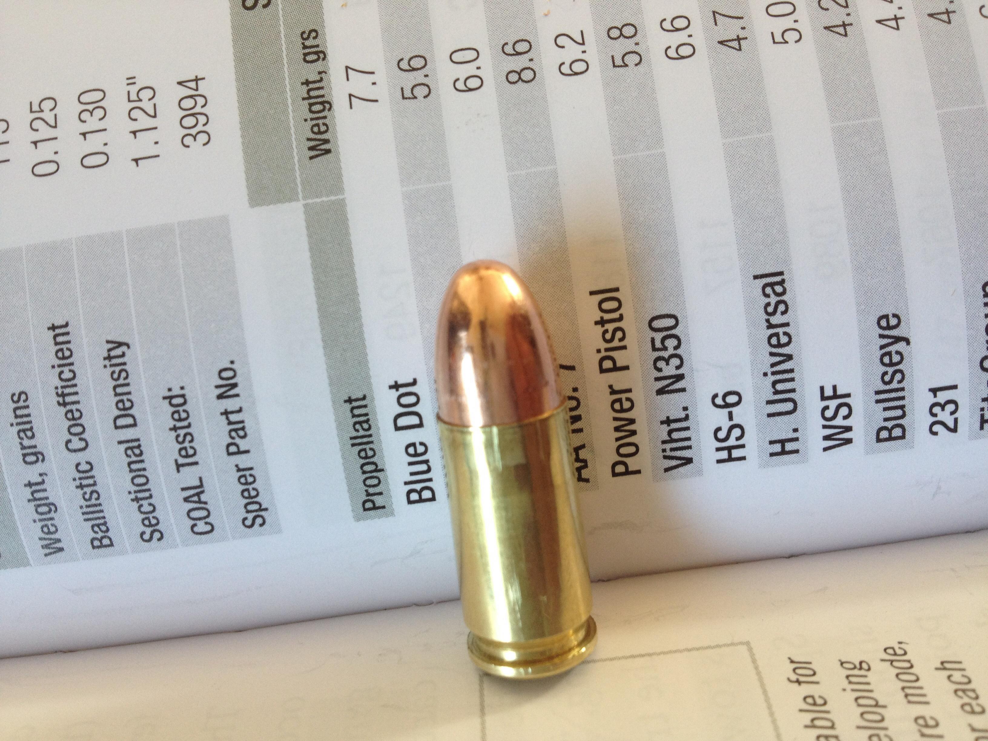

I just test fired two. The first shot was good but the second round is getting jammed, I never pulled the trigger on the second round, just want to eject by hand to see it was cycling ok before I pulled trigger again. It is leaving scratches on the bullet and case near the bullet. The shot brass is showing no sign of over pressure. image.jpg
Well I just cycled a couple by hand now and they were ejecting hard. I notice rifling on the bullets so I am going to seat them further until they cycle in my gun. I am about 1.168" right now, I'll try .010" more. Must be a different ogive
