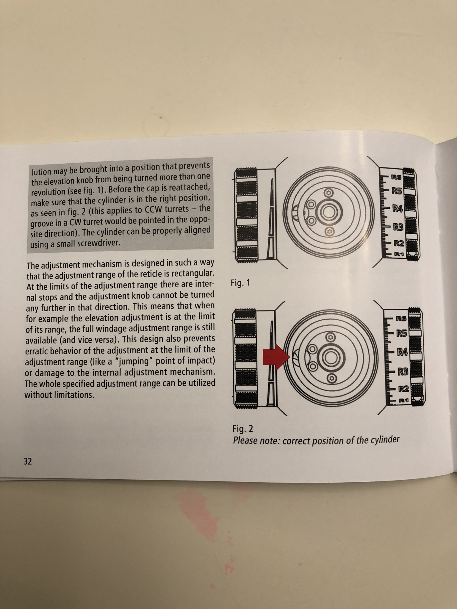

There is a part in the instruction booklet that talks about what I think your problem is. tjere is a small piece of metal that you can see if you take your turret cap off. It is shaped almost like a half moon. If that is not lined up correctly it will stop you from going to your second rev. Take your turret off and make sure that is aligned properly.
The Spuhr mount is on correctly (bubble level in the rear). I was able to flip the internal switch (noted in the manual) in the opposite direction after taking the elevation cap off. Once I did that, I was able to gain almost an extra mil (now 14.7 mils) and the 2nd rotation indicator started to come into view.
I may have to do a video showing what's happening so I am not confusing others.

I believe I found my issue... Shaking my head from this but... I purchased a Badger Rail off of eBay that was supposed to be a 20 MOA base. The packaging has it listed as a 1005-306-06, 20 MOA Rail...
Out of curiosity, I took the scope off the rifle and looked at the model number on the rail itself. It shows 1005-306-06F on the rail which is their 0 MOA rail...
Got to love honesty when dealing with others. There's my missing 6 mils...
Reactions: Dthomas3523
