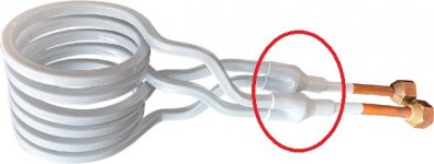

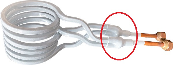

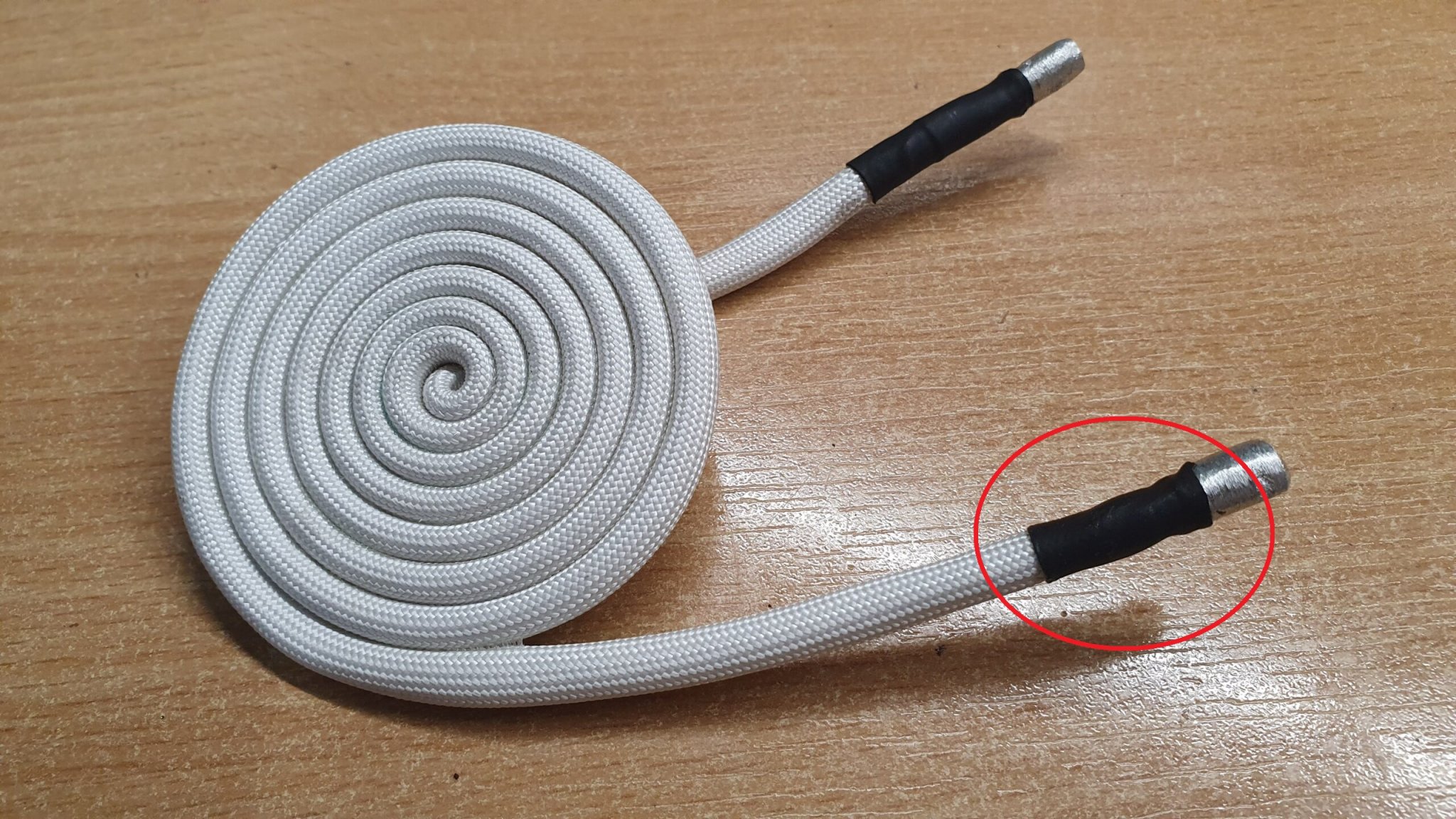

I 'built' an induction annealer based on the video from North East Texas Tactical on YouTube.
The annealer is absolutely fantastic and works better than I ever thought it would.
That being said I bought some materials to custom make my own coils. I got the heat sleeve (good to 600 degrees C) and some 10 gauge solid copper wire. Since the coils themselves get fairly toasty I definitely want the heat sleeve on there, but what I don't know is what they use to secure it to the wire to keep it from fraying or whatever.
I would use regular old heat shrink tube but I think it will melt. I think they do offer some higher temp rated stuff but I have no idea what I am looking at or where to find/buy it.
If anyone knows please let me know. See the photos below for a reference.

I ended up calling one of the online electrical supply companies online and I think I found something that will work.
I got some 3/8" PTFE shrink tube that shrinks 4:1. It says you have to shrink it with a blow torch but once installed it is good up to 500 degrees F.
Hopefully it works out.
Reactions: E. Bryant
In your third picture, thats called "Pants".
Honestly they call it pants,some of the supply houses like DigiKey would probably have them.
