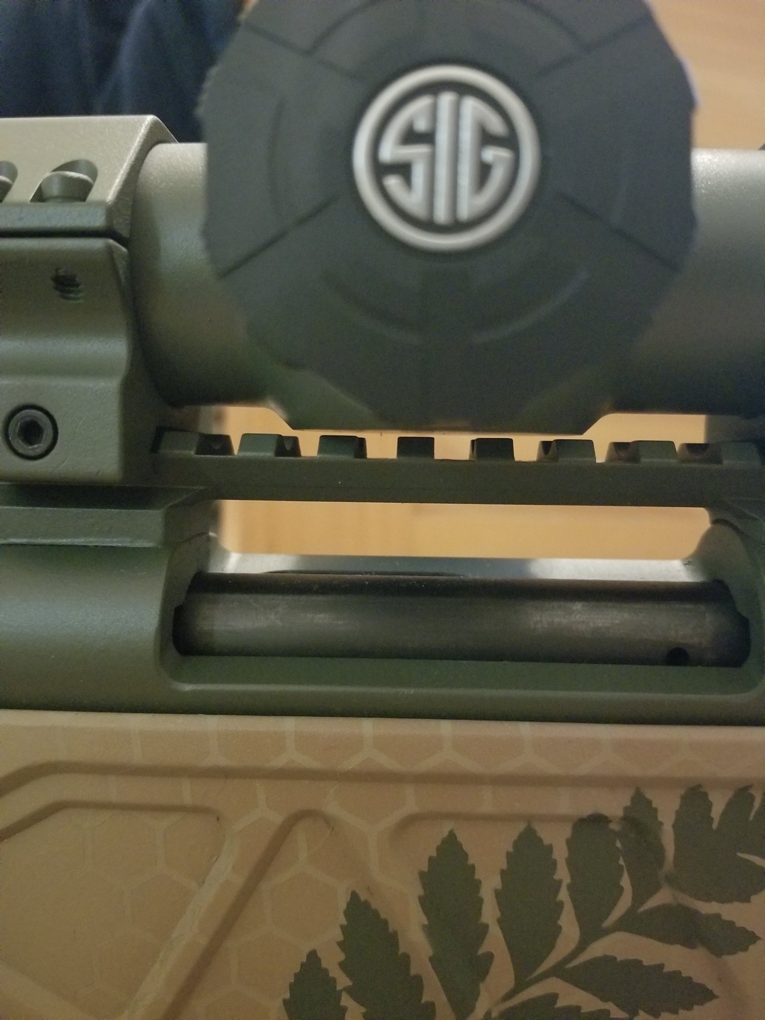

I have the 4802 on a tikka tac a1 with a S&B 5-25X56, I was able to zero at a 100 but left with practically no space left between the bell of the scope and the optic
So looks like 30 moa and 1.18 height or possibly 40 moa at 1.5 height?
Angel0632 i see how close your a1 is with the rail.i am guessing since mine is a CTR i would have plenty of clearence with the 4802

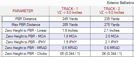

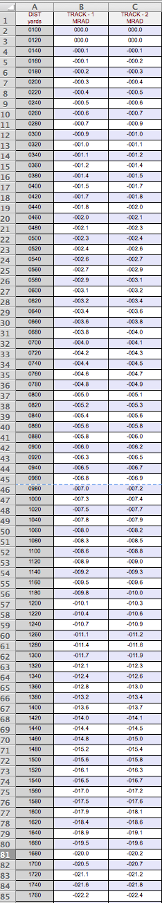

Here are the same 6.5 (mine) one run with AR hight SPUR and one with hunter super low rings SOB 1.5" Can anyone tell what is better... ??
Here is the classic hunter argument run with CB -- Hunters NEED PBZ right?

Who knows what column is the hunter rings?
  • CB1_Ballistics_Results_scope hieght Sheet1 Sheet1.pdf

For the same reason we still wind up trying to chase the lands on factory rifles shooting factory loads at 1/2" moa... an article said we need to somewhere, and internet articles never provide bad info.
As far as the question, "Can you tell which one is better?" Yep. Whichever one doesn't give you neck pain to get behind properly.

:) Yes, and that happens to be the first column with the better PBZ and a few extra click (to small to actually matter) to use on the long end.. Science vrs traditional wisdom/emotion

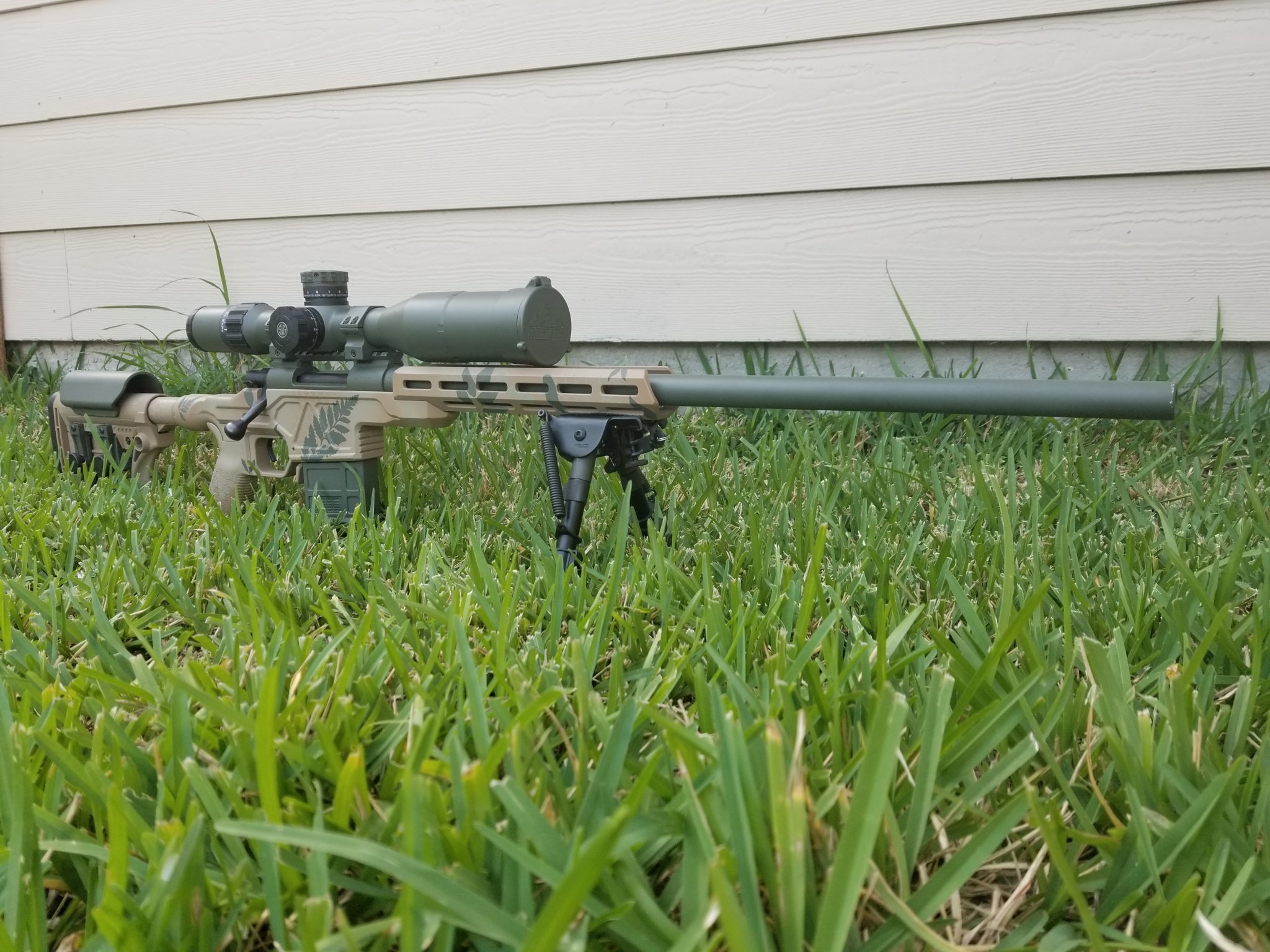

I for the life of me can NOT figure out why everyone on a forum with so much available knowledge, would ever try to mount their scope as low as possible.. unless they only had a non-adjustable hunter stock.
Because I'm not rich to be buying and exchanging new scopes and rings like many others here. I'm not hating on them. I'm glad for those that have the luxury or buying a new scope one day and then selling to buy a new one in a month just because they already want to try something else. Hopefully that'll be me one day. For now, I have to buy what I want/need and get it right the first time. Since I'm gonna be spending so much I'm gonna make sure I'm going to like it, not somebody else but me. And me personally, I like my scope mounted as low as possible. I think it looks better aesthetically. That's why I do it. So long as I can still get behind the scope and rifle properly and comfortably I don't see why it matters. On my set up, it affects nothing!
I was not even commenting on you.. Your image while the scope looks low it is not as low as some without the forend handgaurd - and your rest doesn't looked jacked-up
No issue with me nor does it really mater what I think. -- I get that.. AND I have no idea how you set and feel behind your rifle.. I wrote what I did to try to help those who may not understand why we do certain legacy things, especially when they have more down sides than up.
That said, one very common issues people create with precision (positional) rifles as people use super low rings and adj combs/cheek rests that are set a bit too heigh, is they need to offset their head more, often this results in them with turned hips on a barricade, bench or off at an angle when prone. More often than not, these people have no idea they are NOT fundamentally squared away. Oh, and they feel very comfortable :)

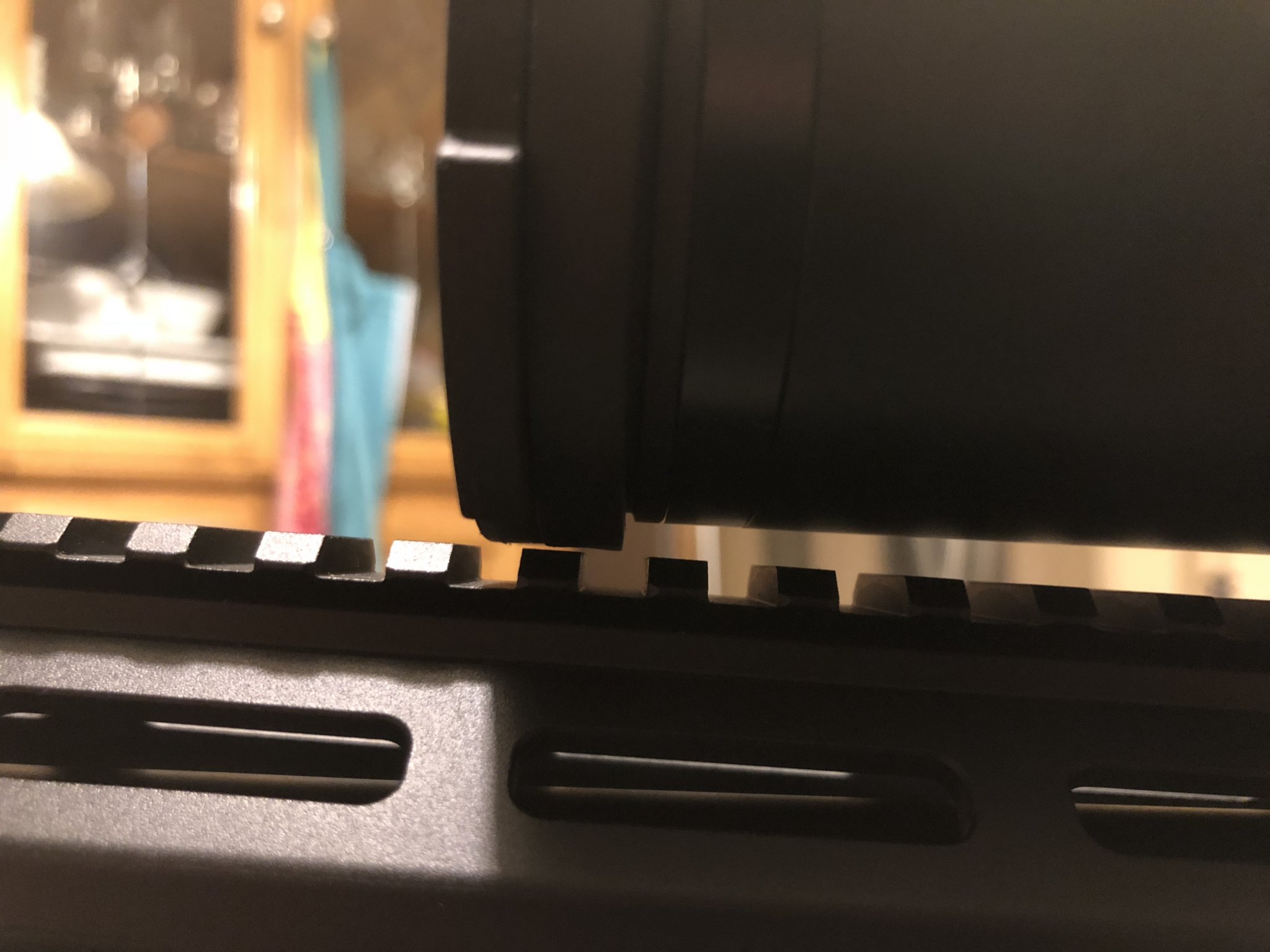

Haha, I didn't mean to sound too attacking lol. You mentioned you didn't understand why people have such low setups and I simply responded why I DO IT. Others might have different reasons though.
To Deadman’s point (lol) about not being able to remove the bolt without removing the cheekpiece or folding the stock. Depending on which Manners you get some of their non folding stocks have a cutout to in the cheekpiece to aid in removing the bolt if memory serves. Something to definitely be aware of in stock selection.

To the OP. I have a Tikka CTR with a Cronus BTR using a 30 MOA rail. I have no issues having a 100 yd zero. There is 32 mils of usable elevation in the Cronus. I have 24.5 available now. I don't use a spuhr but I think you're ok with at least 30 MOA of inclination.
