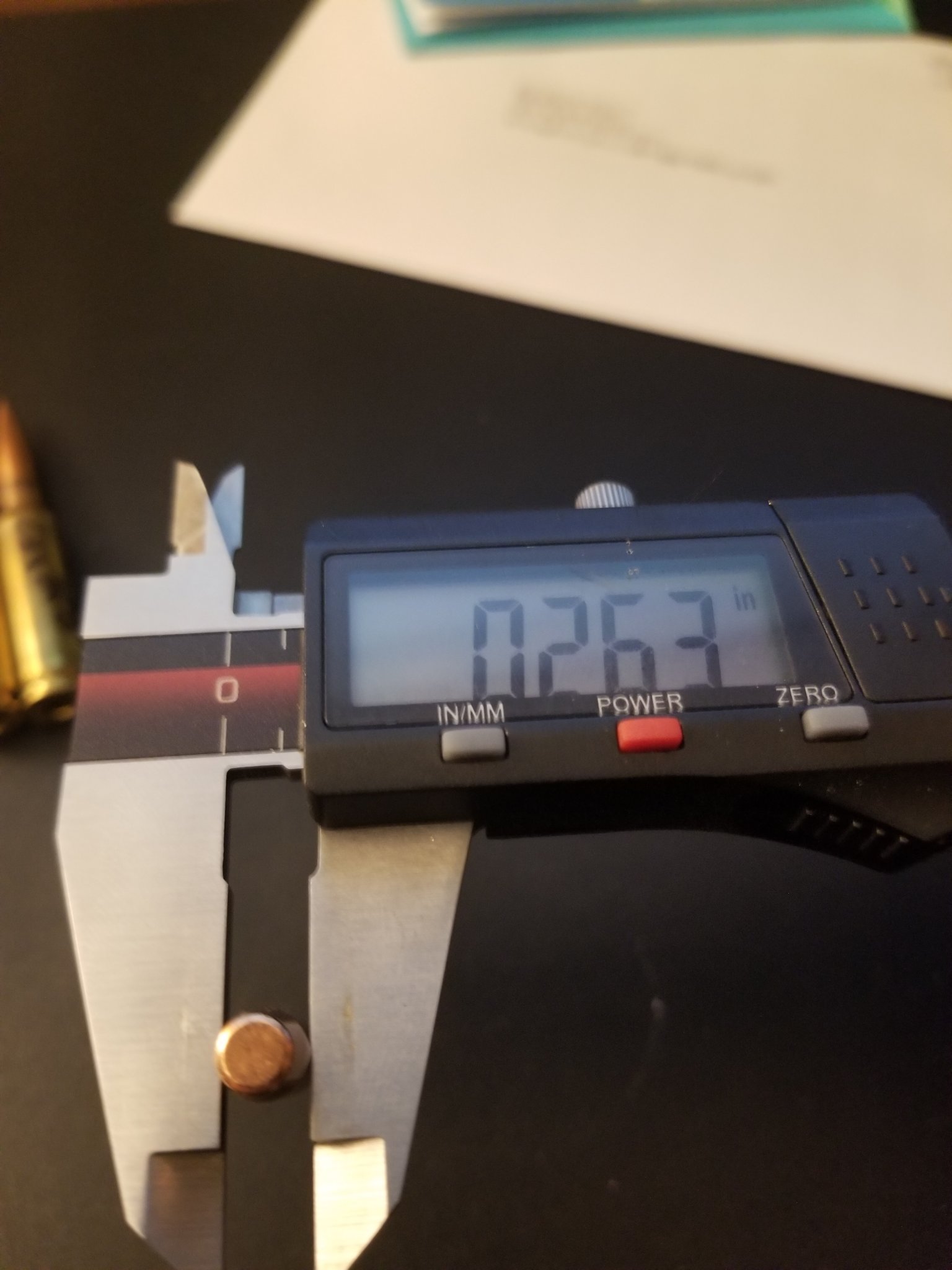

Here are my current case / bullet measurements as taken best with a digital calibers:
Barnes Match Burner 140gr bearing surface diameter: .263"
Hornady 6.5CM average case thickness: .013"
Hornady case outside diameter after resized in Redding die: .289"
Dummy cartridge (same components) neck diameter: .290"
I think I need to read some more publications on these calculations. I guess I'm just needing some guidance on where I'm at currently. I feel like I'm over thinking the process.

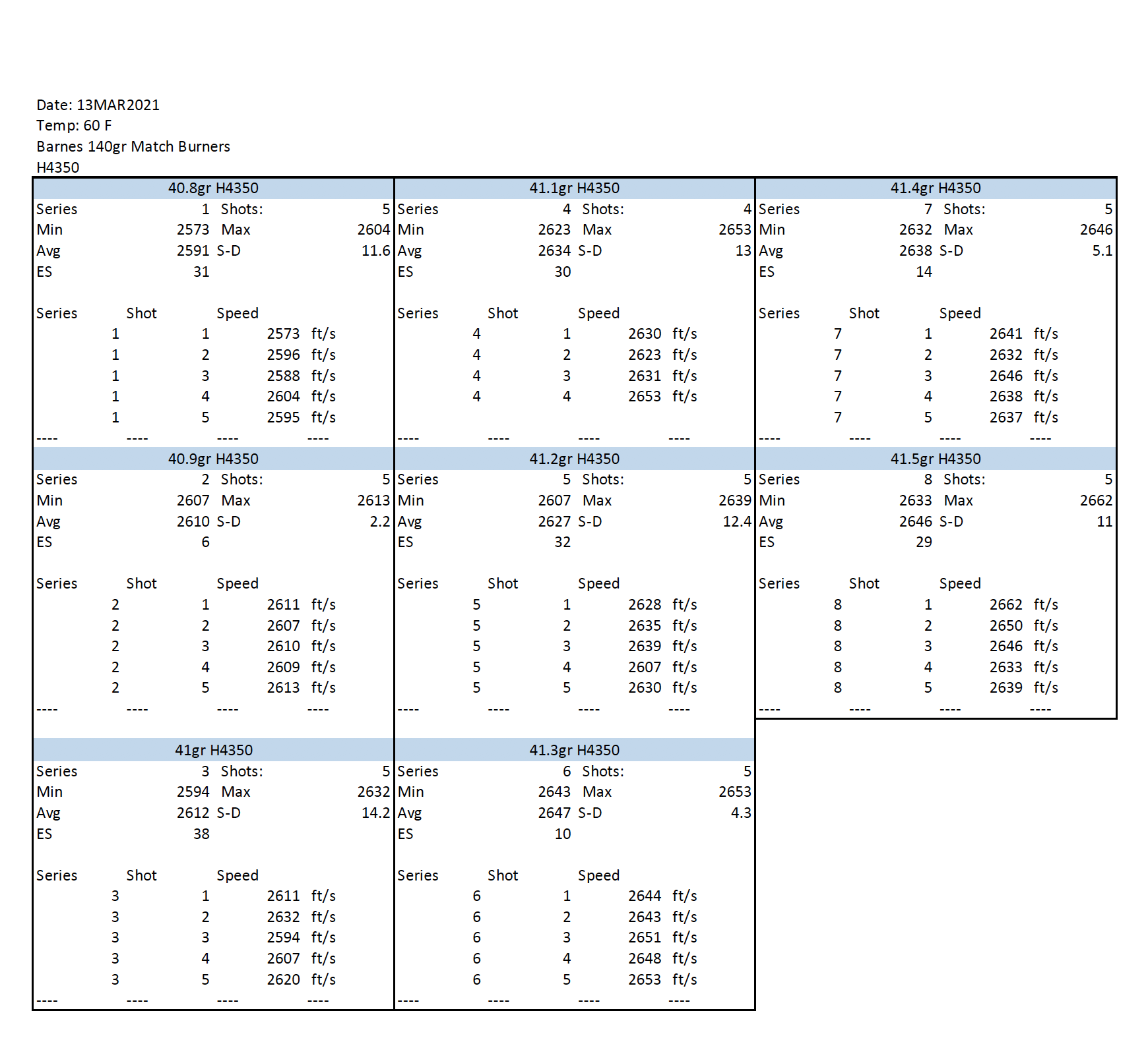

MagnetoSpeed Data:
To give context to this load, I believe I identified a velocity node at approx. 2620-2640fps. My goal was verify that my suggested charges from Gordon Reloading Tool were giving me near accurate real-world velocities. It was pretty close.
To answer your question on whether the SDs are causing the fliers or something else, IDK anything for sure. I was doing my best to watch the Chrono data as I shot. I witnessed a theme of fliers followed by velocity deviations being recorded, so I naturally associated them as cause and effect. A decent grouping for me was approx. 1moa at 100 yards. The fliers seen would break the 1moa cluster an be like 3-4inches out.
My goal is to obtain the most repeatable results at 100yards, so I can get to the 700 yard range without it being a complete disaster lol.
MagnetoSpeed Data:
You’re probably gonna need to take the chrono off to see on-paper performance, just FYI, although 3 MOA fliers probably aren’t the Magnetospeed unless you’re getting bullet strikes on it.
MagnetoSpeed Data:
As I suspected, the magnitude of the SDs you're getting are in no way large enough to cause the performance issues you describe. Look for another cause.

Your measurements may not be correct.
"Barnes Match Burner 140gr bearing surface diameter: .263"
No way are they .263 they are .264 maybe your caliper is bad.
I would never rule out that as a possibility, since I've never measured it against a calibrated surface. Any idea on how to verify this? It's a Hornady branded calipers. I understand that its not a fancy Mitutoyo. Maybe the battery needs replacement.

I wouldn't worry too much about it, since most of your measurements using calipers are gonna be comparing things. I also suspect my calipers of underreporting sizes (they mic'd my turning arbor one thousandth smaller than it's supposed to be), worried about it for a while, then realized it didn't matter.
The vast majority of your caliper measurements are gonna be for things like headspace when bumping shoulders (comparing fired vs bumped shoulders) and bullet seating depth (comparing seated bullet vs target, which you'd have determined using these same calipers), and as long as you don't change calipers all the time, your tool's error will be irrelevant. You'll very occasionally check neck OD when sizing cases, and other stuff you might end up curious about, but one thousandth off at 0.264" (less than 0.4% error) in absolute numbers isn't gonna hurt you (or me lol) anywhere I could think of.
