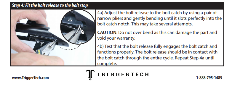

Did you try this ?

Did you try this ?
Yes. I bent the piece appropriately. But the plate (bolt release part) seems to fit too loosely on trigger and it just deflects outward when the bolt stop pushes it. So it doesn’t go back to the “start position”. Of that makes any sense. If I pry it up I can then depress it to pull bolt out.
Who the hell designed that bolt stop and release. Haha.

You need to seat the tab from the triggertech into the grove on the bolt release. If there is slop, it seems that there is metal binding and it does not operate smoothly. I had mine out yesterday and it worked flawlessly. Post #3 is exactly what I did. Let us know if it works. I really like the trigger one I got that issue figured out.

Make sure the bolt stop doesn't bind in the slot or on the trigger pin first . It seems like the tab has to be all the way to the tip of the lever if it has to slide on the bolt stop it doesn't work
