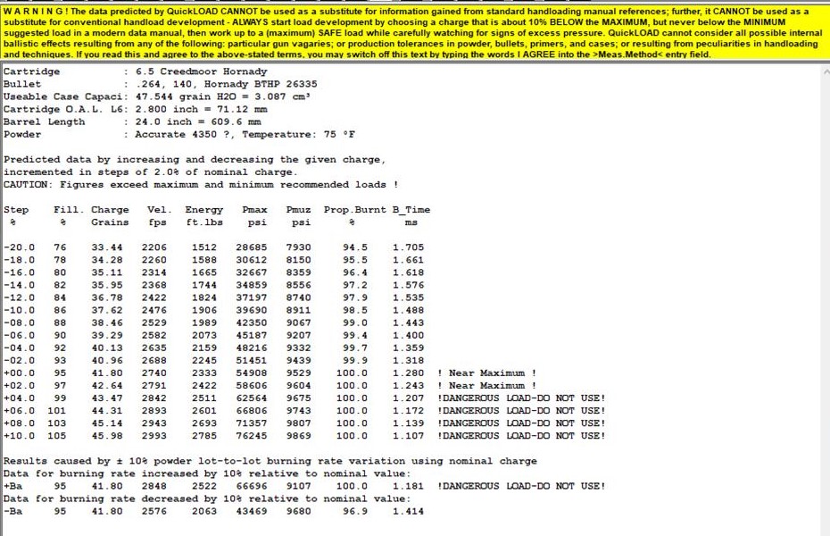

Something wrong there. QuickLoad predicts 2770 FPS with 41.8 gr. Accurate 4350, Hdy 140 BTHP, 24" barrel. Other values are defaulted to a COAL of 2.8" and a case H2O capacity of 51.5 gr. Predicted pressure for this load is about 5000 psi under the max.

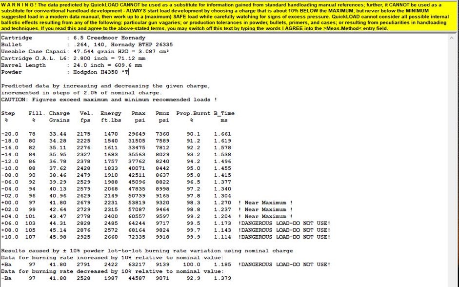

Here's some numbers for you to look and and maybe give you some perspective; burn rate factor here is a default rate and actual can be higher or lower, which would changes the numbers of course, as would different seating depths:
Compare that to estimated numbers for H-4350:
Reactions: jafo96 and zabada

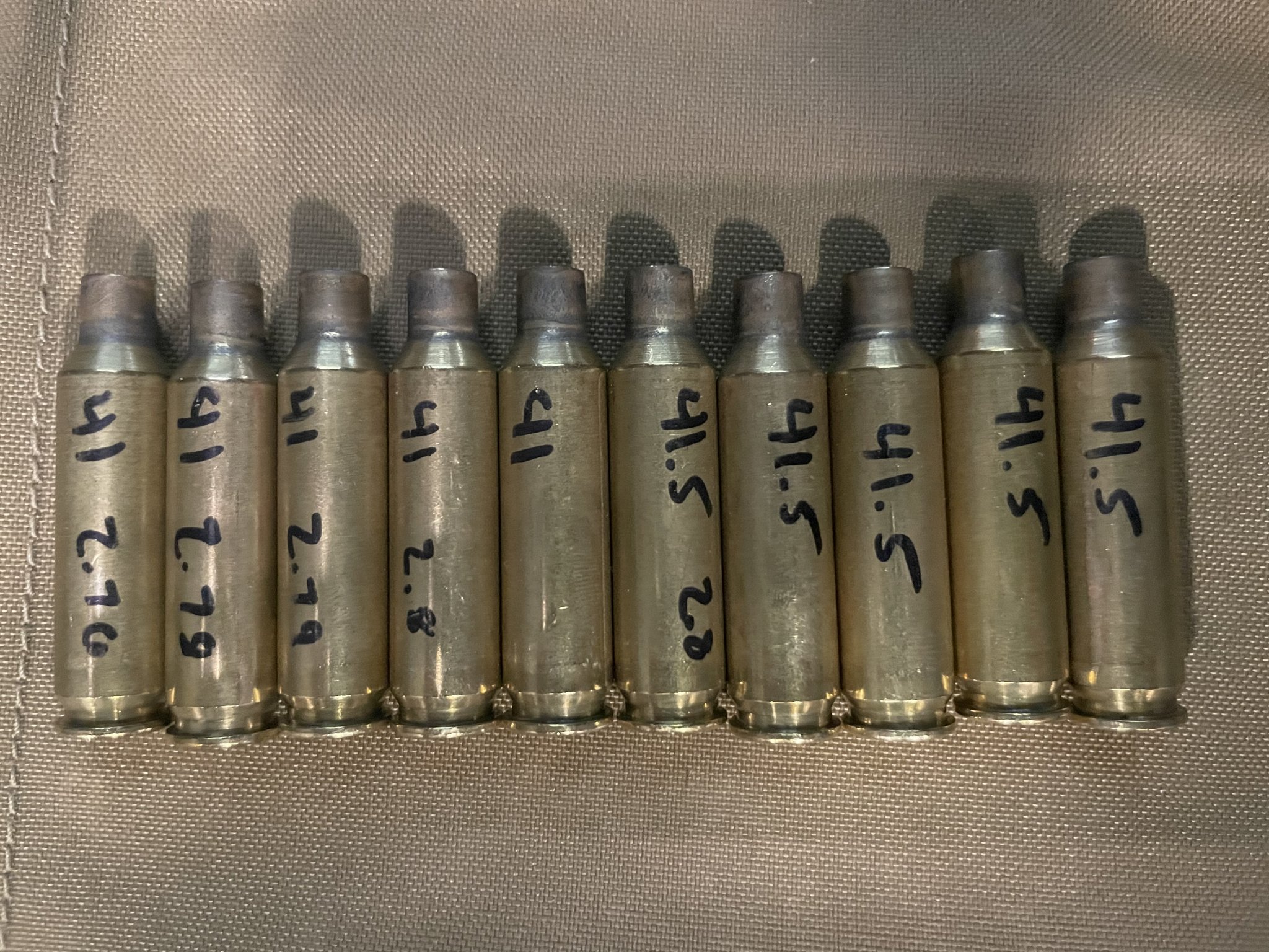

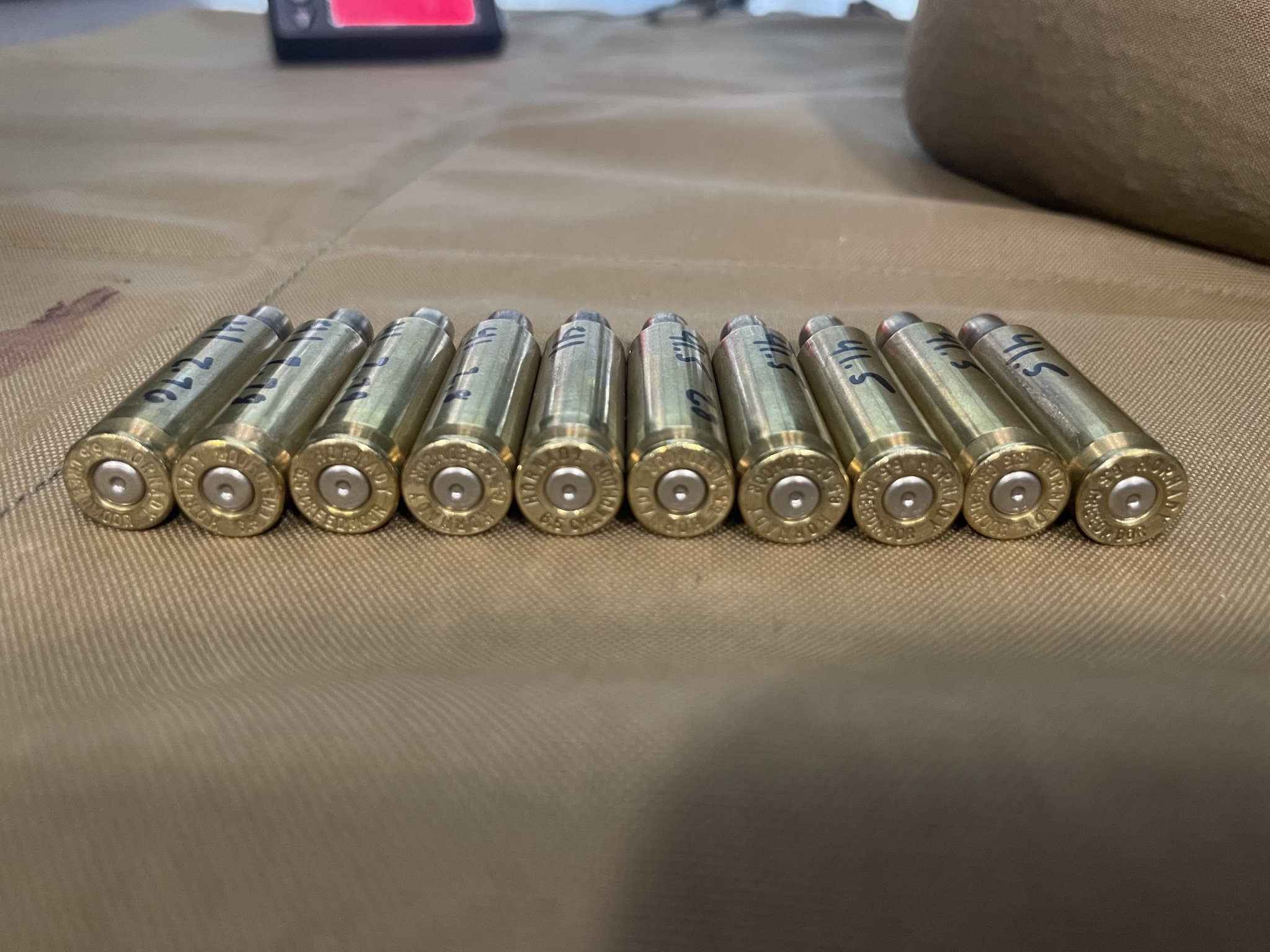

This is great info, thanks. It turns out my COAL was 2.76”.
I’ve adjusted it to 2.805” and loaded some with 41gr and some with 41.5gr.
Based on quickload’s warnings, and not being an experienced enough loader, I will not be going over 41.5. I’d rather crack open the H4350 I have. I just would rather be able to get a good training round with this Accurate 4350 first. Results in a few hours.
Reactions: 357Max

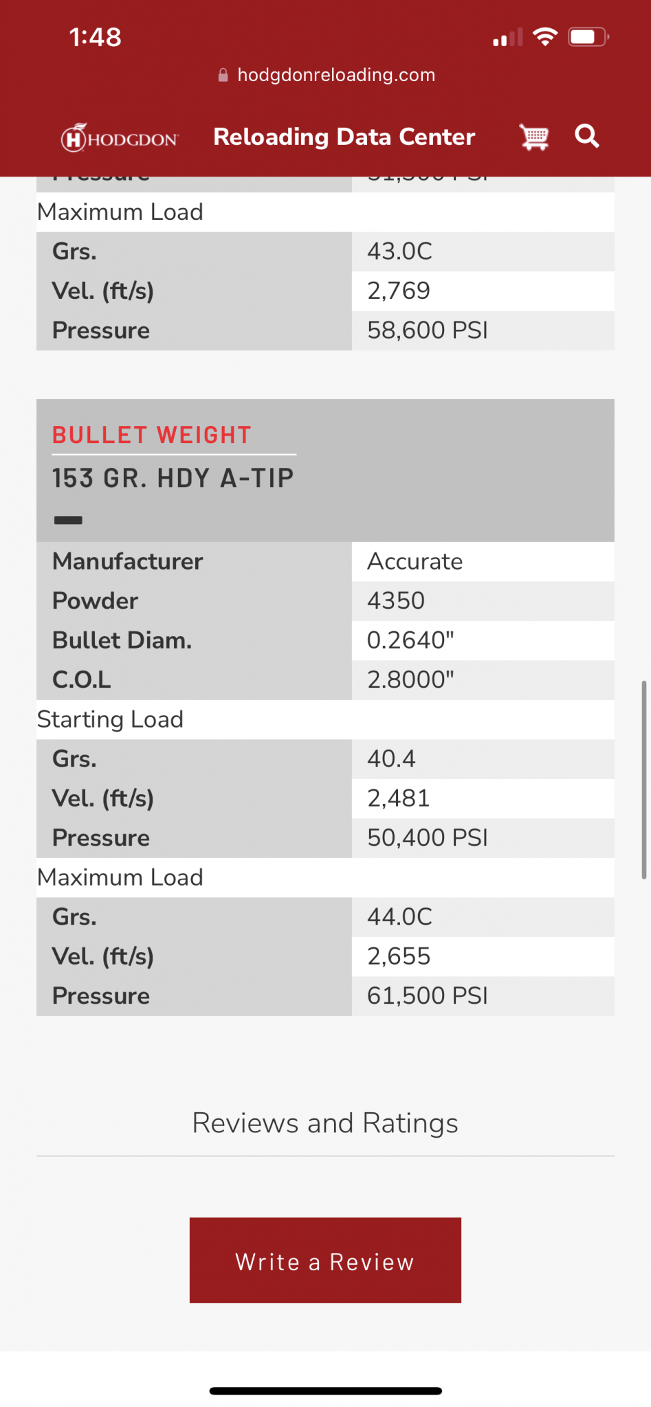

Can I get confirmation that there are no pressure signs on this brass and that I should move up in charge weight?
I have the hornady app and bought the 6.5 data and it doesn’t have anything for Accurate 4350. Where are you seeing this?!
The book is so underrated for safety. You have super slow speeds, and not even the slightest sign of pressure beginning. Up the charge. You’ll see primers start to flatten a little, which is still fine.
Go up to 42.5-43 and see what you get.
You won’t blow up your rifle lol. Promise
Reactions: Simonsza1
Even their website shows 44gr of accurate 4350 with a 153gr bullet!
I’d start at 42.5 and go up to 43.5-44 after seeing this.
You’re being waayyyyyy to conservative with the powder.
There’s a lesson here about using actual tested and published data, NOT Quickload, as well as using data for the correct powder. Don’t mix up data between the three different 4350 powders, they are not the same thing.
Accurate publishes data for their powder, and it’s free online. Western Powders 8.0
Their data for AA4350 and the old 140 Amax (which became the ELD-M) shows a max of 43.5gr at 2.740”.
Hodgdons free online data shows the same thing.
Use real data and back away from the Quickload; it’s the least reliable “data” you’ll find.
