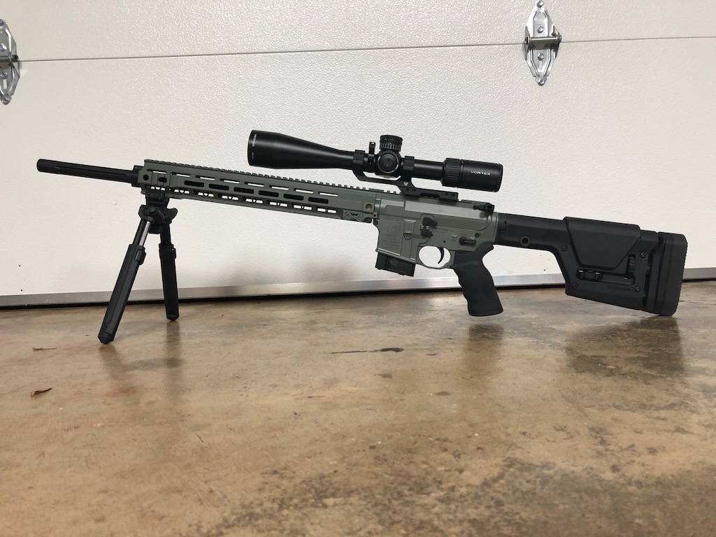

Hey guys,
Wondering if anyone has any ideas about this situation. Buddy of mine wanted a 224 Valkyrie AR. He doesn't usually like AR's, he's more a a bolt gun guy. Anyway, I tried to talk him into getting a factory 224 AR but he wanted me to put one together for him. I've built 7 AR's previously, never had any issues. Here are the specs/parts.
-Bartlein 22" +2" gas system medium heavy barrel (.875 at the muzzle), straight flutes, threaded with thread protector from Craddock Precision.
-Vltor MUR upper
-Aero Precision BCG
-Mil-spec lower
-Geissele MK4 15" rail
-Geissele SSA-E trigger
-A5 Receiver extension
-Magpul PRS Gen 3
-Colt and Geissele other various small parts
-Vortex PST Gen 2 FFP 5-25x50, in a vortex scope mount
I recently re-barreled my precision AR with a JP 224 Valkyrie 22" barrel, same +2 gas system. Mine has a JP bolt in a Noveske carrier.
Prior to us going to the range he installed the Area 419 Hellfire system on this new 224.
We went to the range and shot both for the rifles side by side. We shot factory FGGM 90gr SMK ammo. Mine shot pretty good grouping well under 1" at 100 yards. My buddies rifle on the other hand wasn't grouping at all. I don't have pictures of the groups but they were all well over 1". Like 1.5"-2" with that same ammo. We shot it both with the muzzle brake on and off (area 419 adapter still on of course).
Then my buddy went back to the range a week later with another friend and shot the same factory FGGM 90gr SMK ammo AND factory federal 80.5gr bergers and it still did not group well.
Now for some questions that maybe y'all could help us out with:
-We need to remove the area 419 hellfire system from the rifle and shoot it with just the thread protector as a base line correct? Is it possible that if the area 419 adapter was screwed on too tight or too loose to affect accuracy this much?
-With this Craddock Bartlein barrel I have only heard great things. What should one expect accuracy wise with this set up?
-Is the brand of bolt an issue?
-What other ideas/things to check do you have that could fix the group size? We're open to all suggestions.
Thank you for your time and thoughts.
Zack

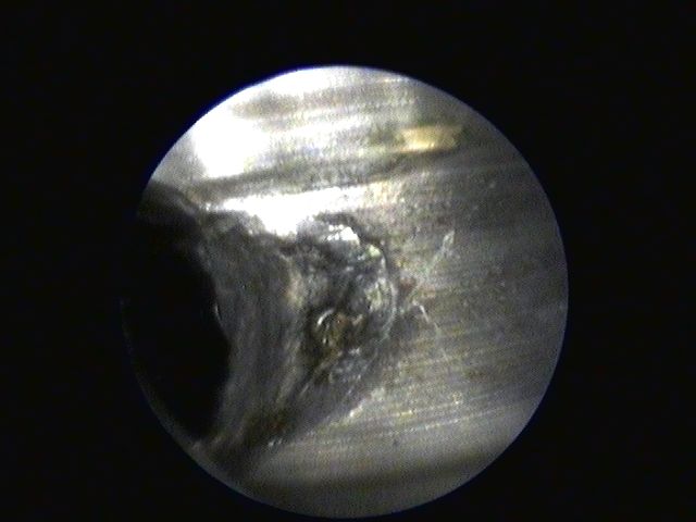

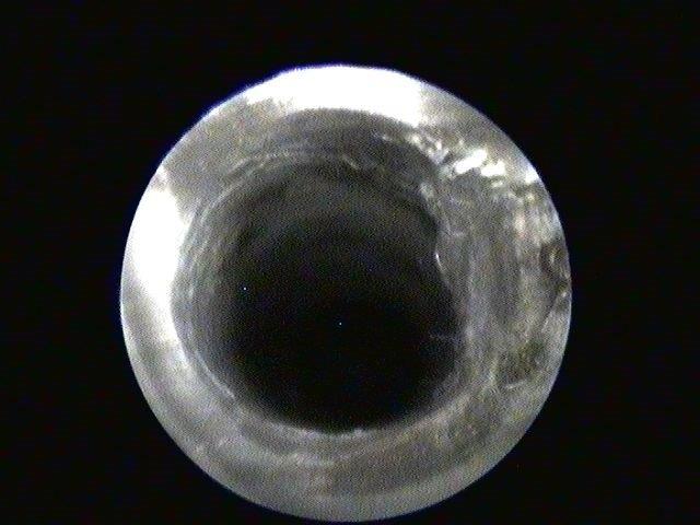

Out of curiosity what would you estimate the round count to be on this barrel judging by the gas port erosion? I’d like to limit responses to people familiar with gas port errosion if possible.

I wondered if there was any chance that the barrel they sent my buddy was used based on the amount of gas port erosion. I'm not suggesting they intended to do that. But if the erosion was excessive for the current round count (210 rounds total of factory ammo) I thought it may be a possibility. Not to mention the fact that my buddy ordered a heavy barrel and they sent him a medium heavy. I don't know what normal gas port erosion is for a Bartlein barrel like this with this round count which is why I was asking.
I contacted Bartlein and they recommended the same thing regarding "bedding" the barrel extension as well as torqueing the barrel nut to 70+ foot pounds. I don't know if barrel nut torque would apply to this build since I'm not using the same rail system they use and Geissele recommends 40 foot pounds.

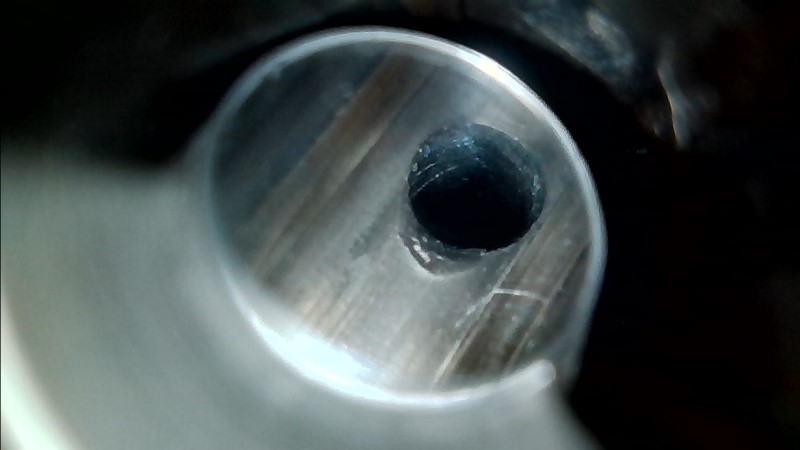

I have a new ARC barrel that I just put into service and the round count is at 200, my port erosion looks to be almost identical to the one you pictured. I did not capture a picture when I scoped it. They usually erode a little fast at first then tapper off after the sharp edges and burrs melt away.
Edit: to add photo of barrel

I am having similar problems with a 224 build. I sent the first barrel back and they gladly replaced it. The problem as I see it: the gas port. I didn’t scope the first one until after load dev was a disaster. There was a chunk hanging proudly into the bore. No amount of brushing or abrasives would cure it. Still showed with shiny copper on it. The 90’s were by far the worst. 88’s right around 1 MOA with Varget, but a modest load 23.6 grains. The new barrel has 100 rounds and developing the same chunk hanging in the bore. How did your project progress. ????
Edit: to add photo of barrelView attachment 7619767
