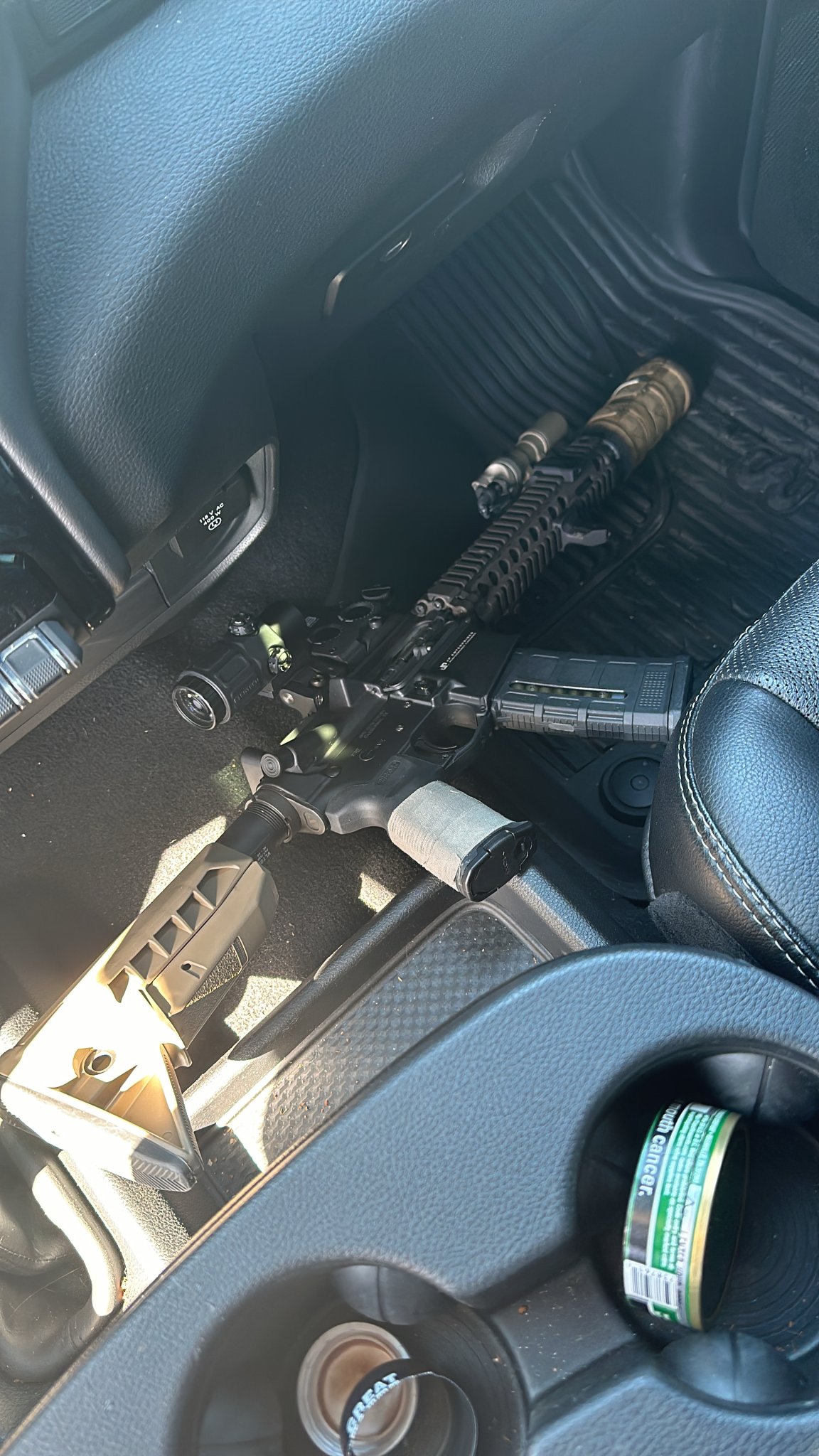

Not an AR guy… snagged sopmod clone upper DD upper with the smaller diameter port I think, threw it on a JP lower, rise trigger, vltor carbine length buffer (A5 I think?) whatever…only cause folks always ask for details.
It’s 10.5” with an RC2 in 5.56 in it…rifle is an absolute scatter gun ever at 50 yards off a bipod. Given, it’s just got a 3x magnifier and a exps on it, but shouldn’t it be a bit tighter than that? Talking 2” at 50 yards with about anything I can find to feed it.
I’m probably going to pull the barrel, but what are some obvious things to check for? Proper torque, nothing loose or touching the handguard, brake/mount is tight…anything else? Not sure how to trouble shoot an AR
Optic is fine, same results after I pulled the eotech and threw it on a riser as well, but everything is shrugged up.
Don’t need it to drive tacks, it’s a truck gun mainly, but anytime I let someone shoot it, they say the same, a DD should be more accurate than that. I shot a 10.5” colt in a class about a decade ago and we were on steel at 400…no way I could do that with this rifle. No Rise trigger in the photo…JP trigger there, but no change for the better when swapped.
Any suggestions appreciated.
