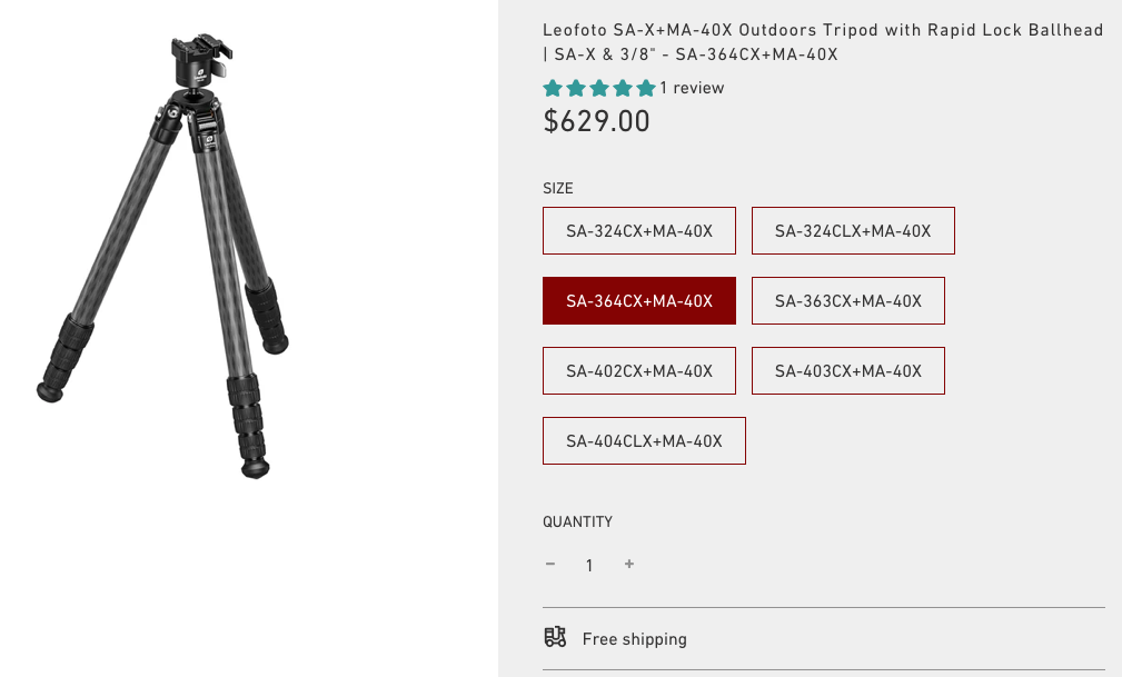

Instead of buying the tripod and ballhead separately, you might consider this Leofoto tripod and ballhead. It will save you about $120.00...
Also, if you "subscribe" on their website, you'll get a 10% off coupon. There is a subscribe textbox and button at the top of the webpage.
Leofoto SA-X+MA-40X Outdoors Tripod with Rapid Lock Ballhead | SA-X & 3/8" - SA-364CX+MA-40X
I have an older version of this tripod ballhead combination and am very happy with it.

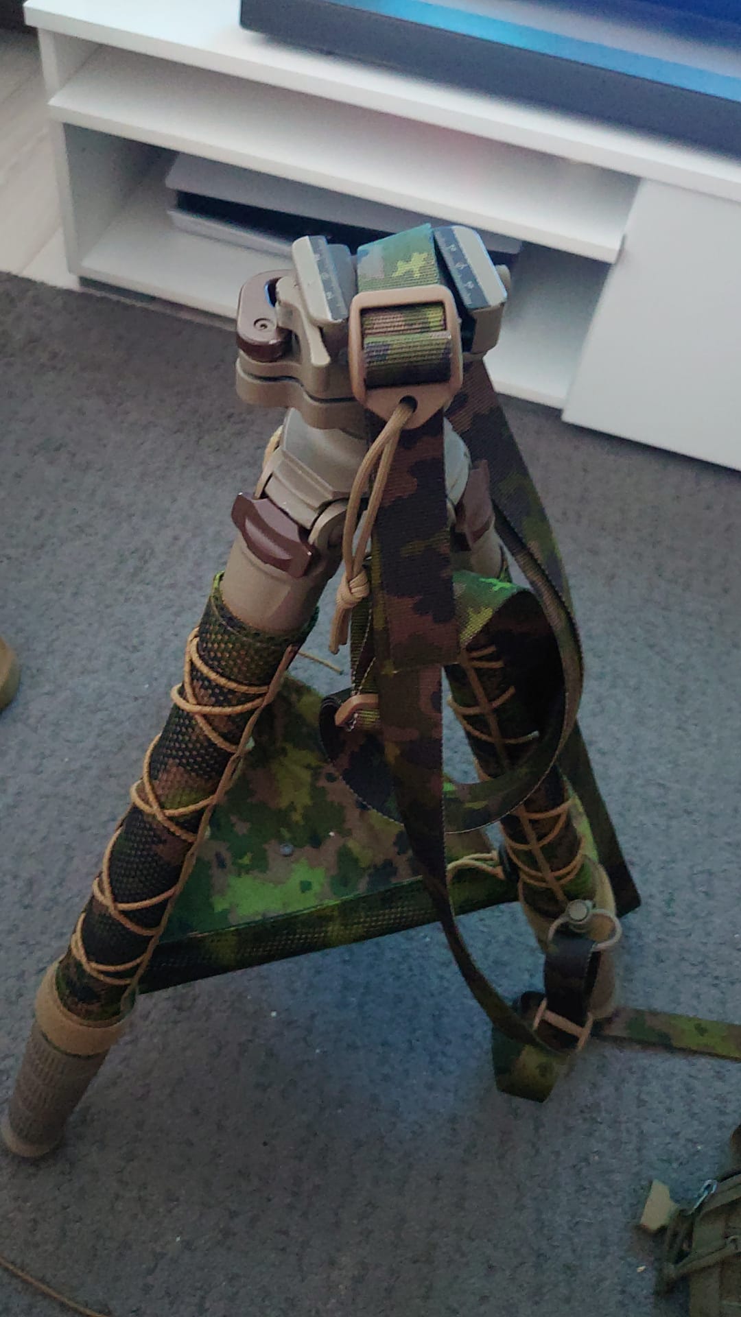

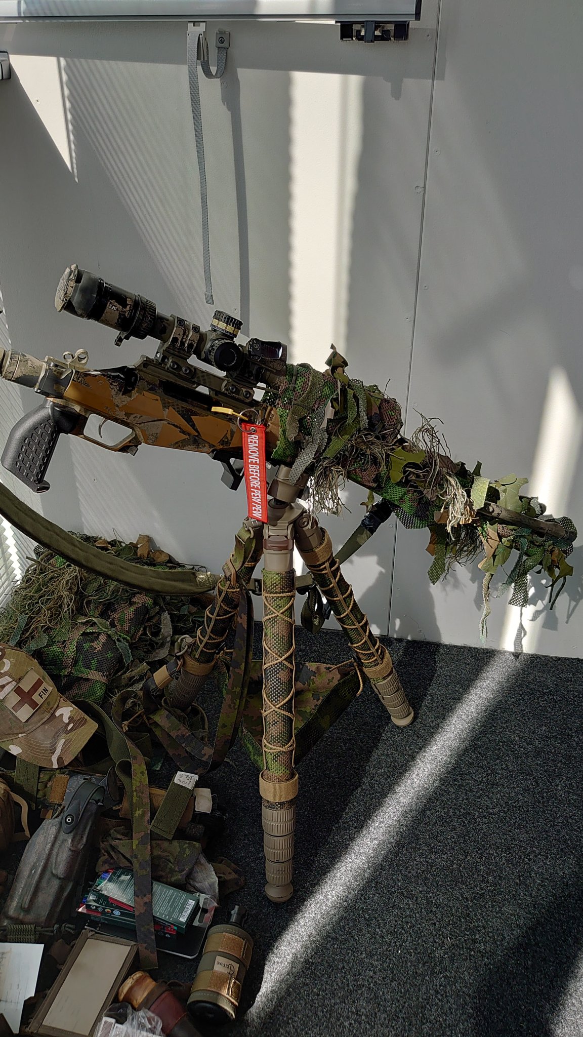

I have the Leofoto SA-364C-tripod with MA-30L-head. There are sturdier tripods around, but this one gets the job done.
I also have my bipod attached with a picatinny rail but I have a shorter ARCA-rail for the tripod (never needed a full length and I have a Tier One bipod that can't be or needed to be shifted, hence the picatinny). The MA30L takes both ARCA and picatinny.

What is the wrap you have on your tripod legs?
