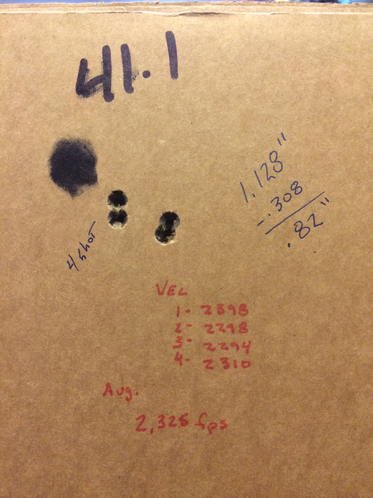

Update 1- I performed a secondary cleaning after the first major cleaning. The fouling removed was much less than the time I posted about before. I would guess 20% of the last time. Total rounds fired would have been the same as the first outing that resulted in the extremely fouled barrel.

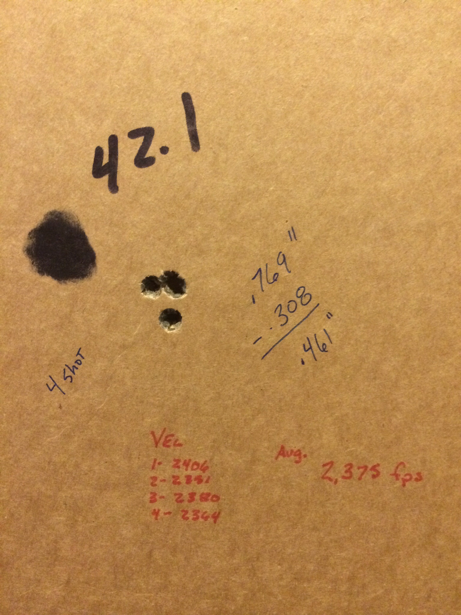

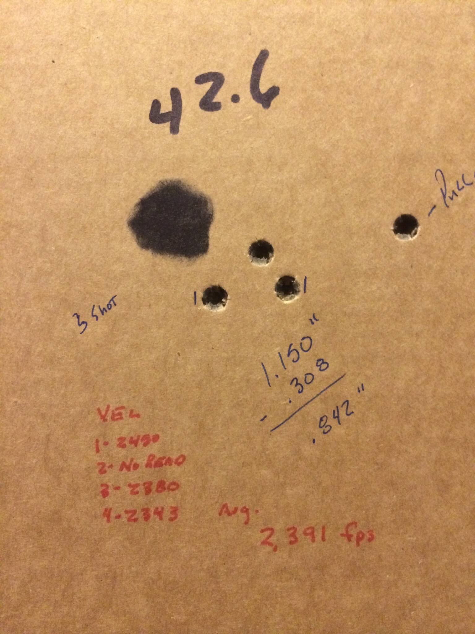

Update 2- I decided to change my load recipe from 175 SMKs to 168 SMK loaded over R15. Long story short I believe I found a load that works. 42.1 grains of R15, 168SMK loaded to 2.800 OAL. I completed the OCW Method, one round at each target all the way through lowest to highest. I was only able to complete 4 of the 5 strings due to the range closing. The best load resulted in a average 2,375 FPS and a center to center 4 shot group of .461 inches.
I am a little concerned by the velocity, but honestly I really never shoot past 600 yards. I completed JBM ballistics on this round and it goes subsonic at 864 yards.
For now I am satisfied and I hope that I continue to prove out this load. The accuracy node for the other groups with a half grain over and over resulted in .80" 4 shot groups.

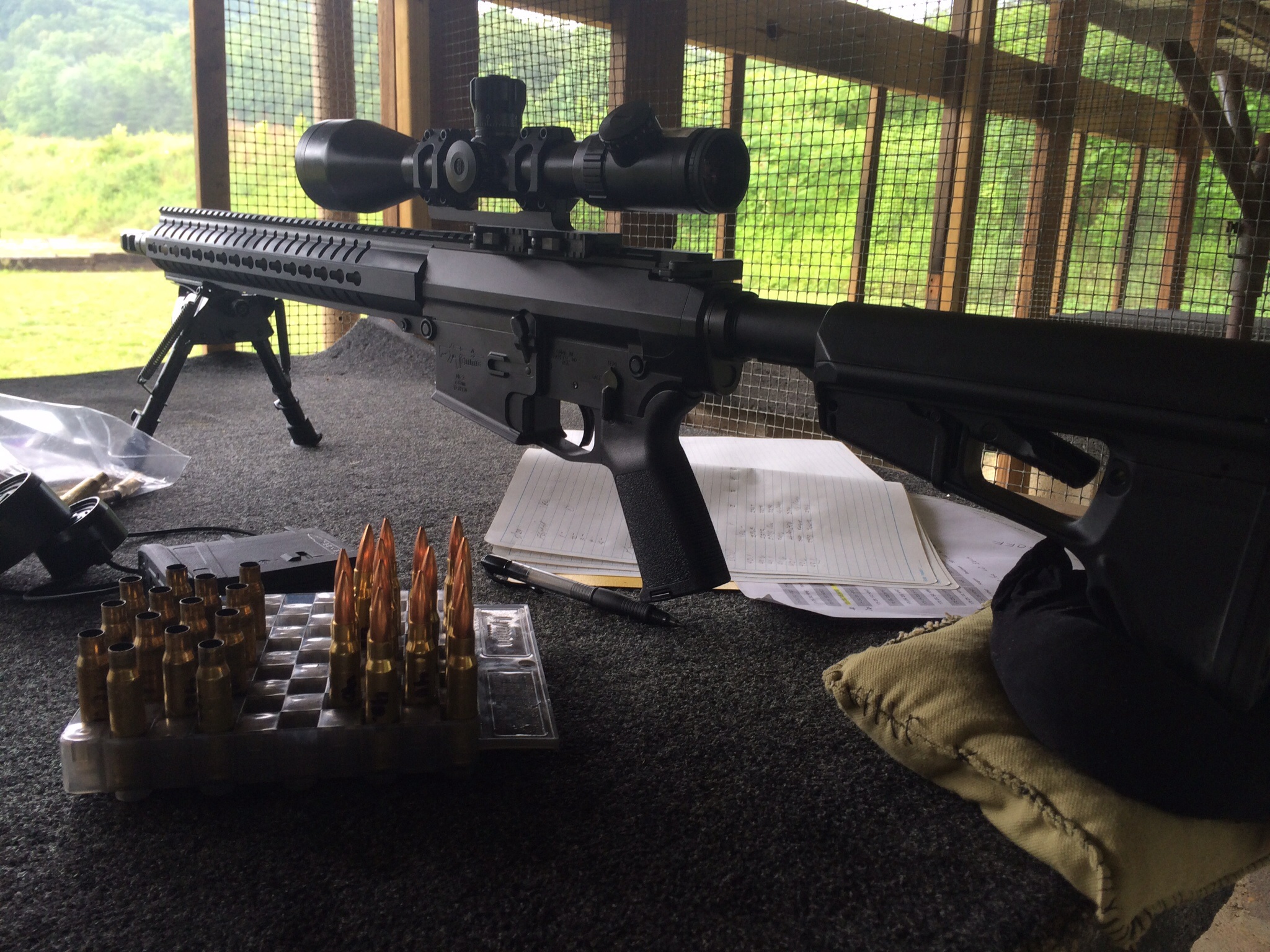

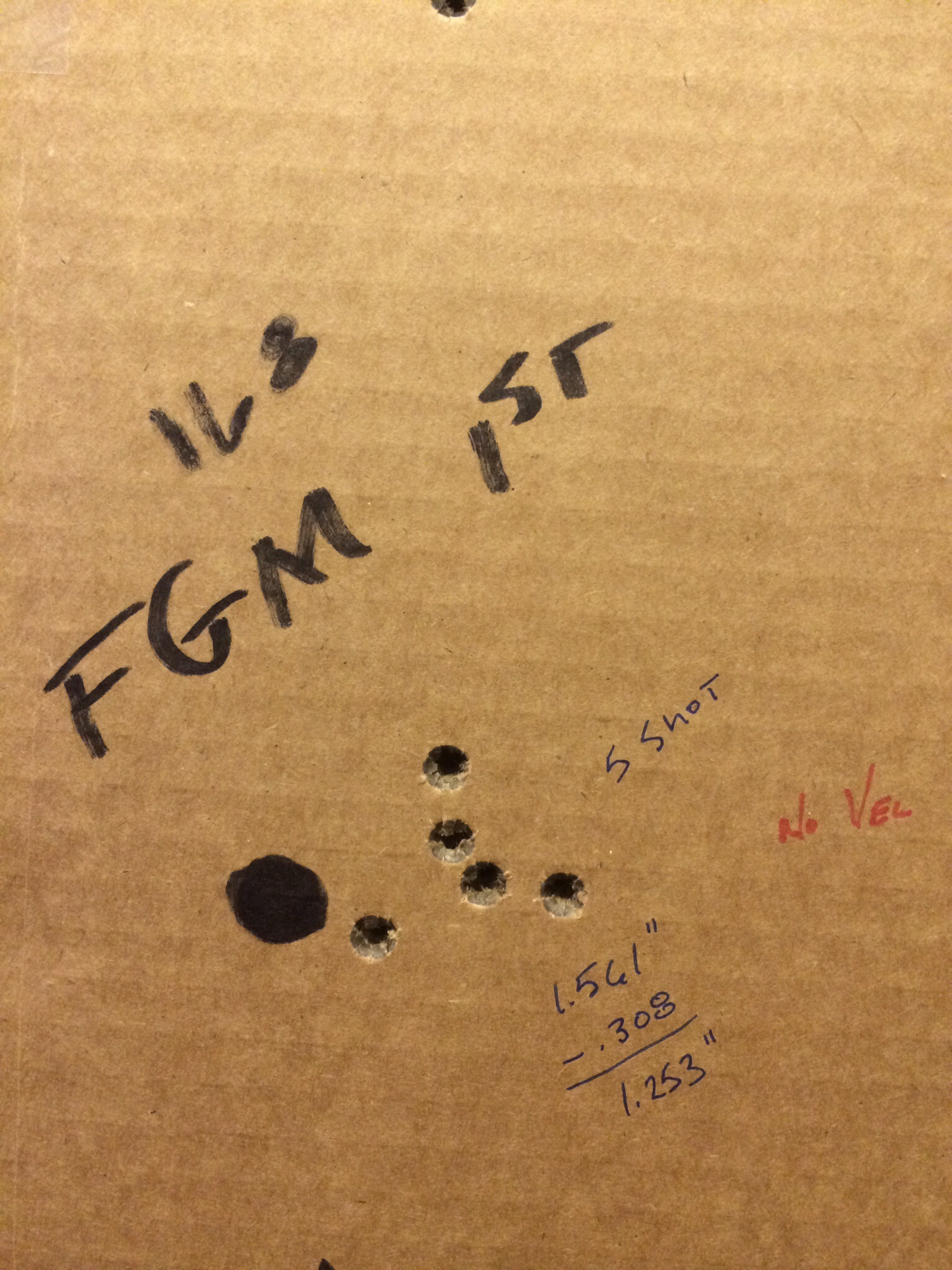

Any suggestions would and are greatly appreciated. Hope my pictures load!
