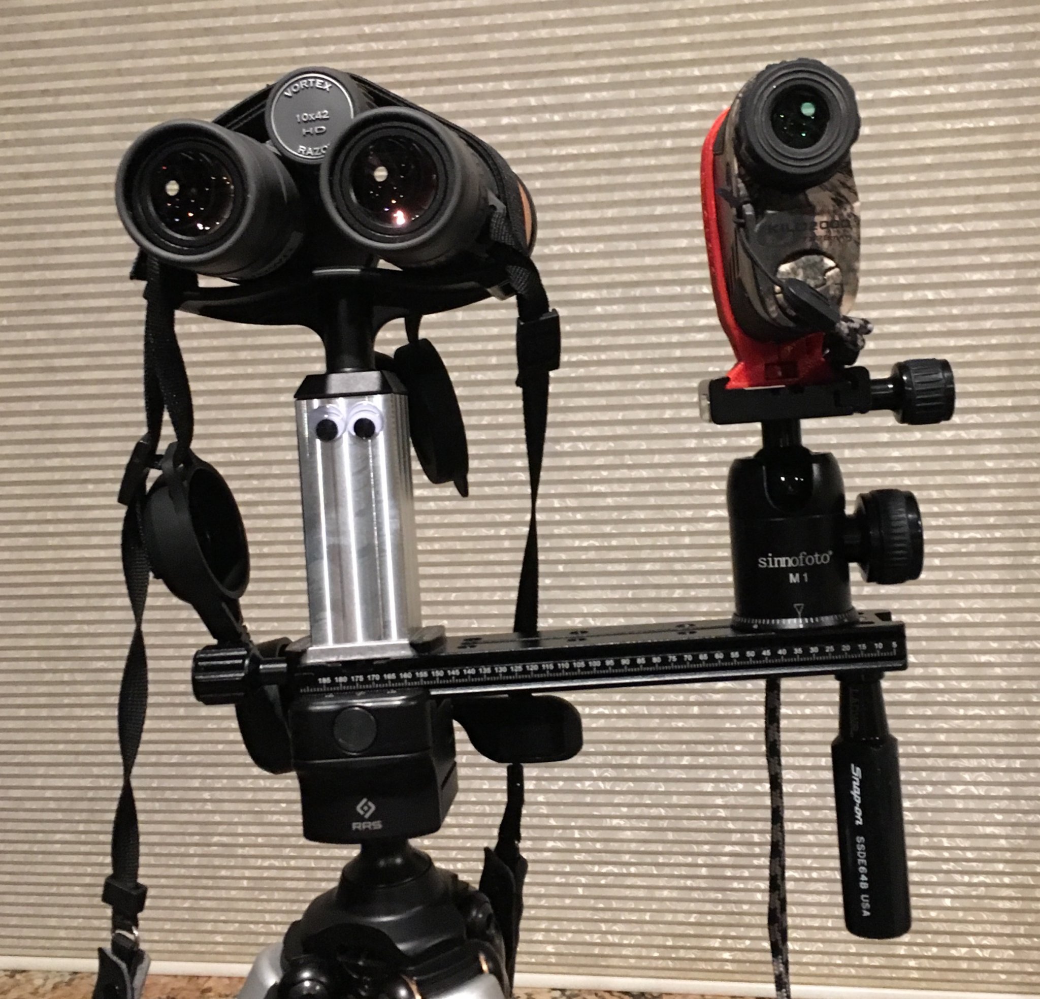

    I've been playing around with just this idea. How to mount my spotter, or binoculars, and my rangefinder. All at the same eye level. Each able to move and point as desired. And be easy to attach and remove.
    The question isn't what tripod. It is what rail/mount to put on it. I have a RRS with the new Anvil30 head. So it accepts picatinny or Arca. I found on Amazon a Neewer rail for about $20. It attaches to the tripod and also has an Arca clamp on top to accept my spotter or binos. The rail is about 8" long. At the other end, I found a small ballhead that has an Arca clamp on the top for my rangefinder. My thought here is that I won't always be able to range from the position of the tripod. So I want to have a way to easily remove it. Oh, and I also put a vertical handle under the rangefinder to help control the movement of the whole setup. You can see in the picture the binos are sitting on top of a pedestal we had to make in order to make the eye levels the same. The spotter doesn't need to be as high.

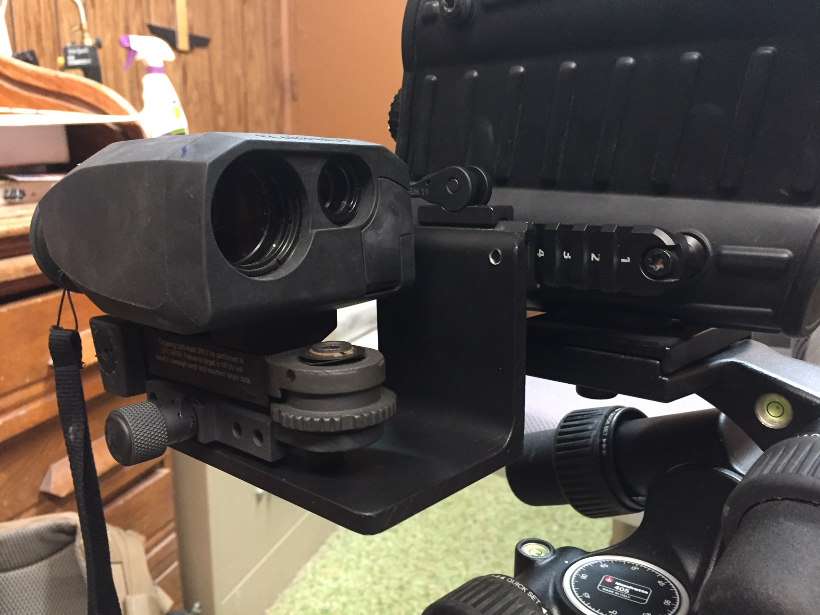

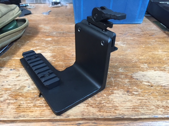

    Had a similar issue with pairing my LRF with my spotter. Looked at numerous possible solutions online and none of them seemed to work. Finally built an adapter to attach to the rail on Spotter 60. Co-witness the LRF with the Spotter using an APO mount. Used it the second time I took the Gunsite XLR class and worked great when mounted on a gearhead. Quite a different setup for the USO spotter but may give an idea of some options.
    Idea was to have the eye pieces for both at the same level and just move side to side, When the LRF is mounted on the top rail it is too awkward to use. Use a trigger cable on the LRF tethered to a Nomad running FFS.

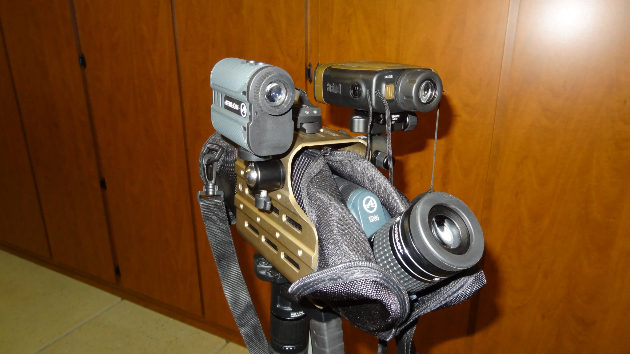

    Another option is the Abel Table from Abelcousa.com
    Here's a recent thread:
    https://www.snipershide.com/shootin...ble-by-abel-company-usa.6889615/#post-7082831
    The table is Mlok compatible and has the Arca rail built in to the bottom.

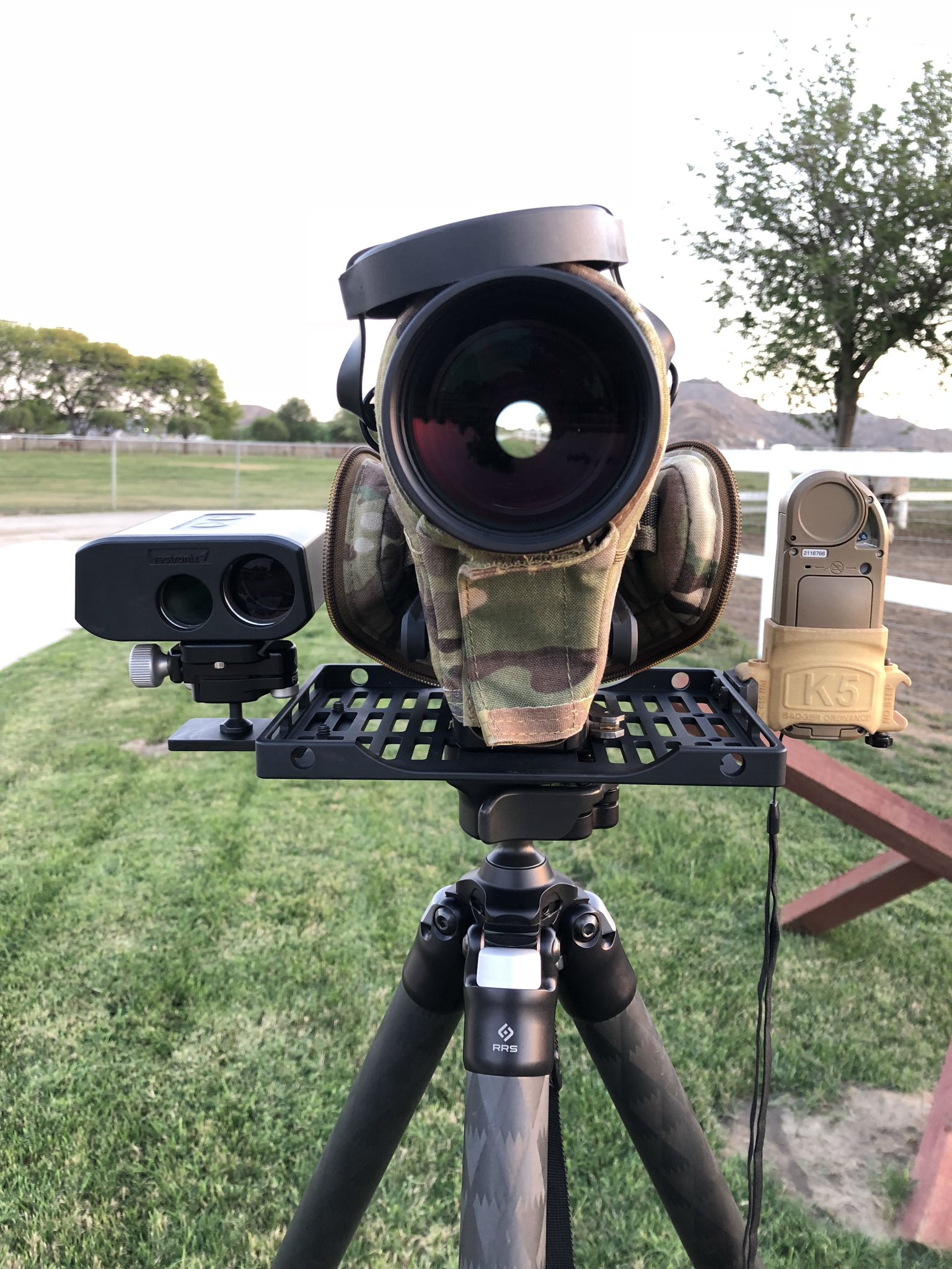

    In the following pic, the attachment for the Vectronix Terrapin is a prototype microball head that they will be making soon. These photos are of the Abel Table that belongs to Mike from Abel Company.
