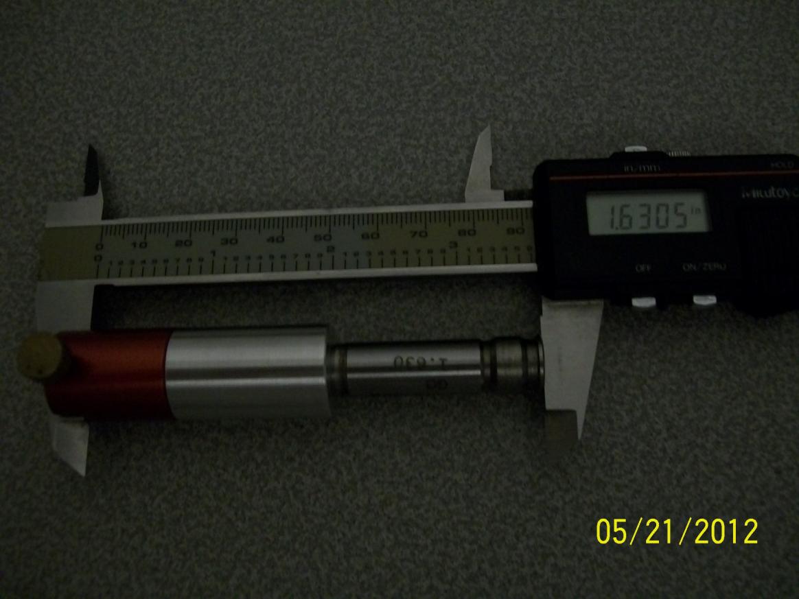

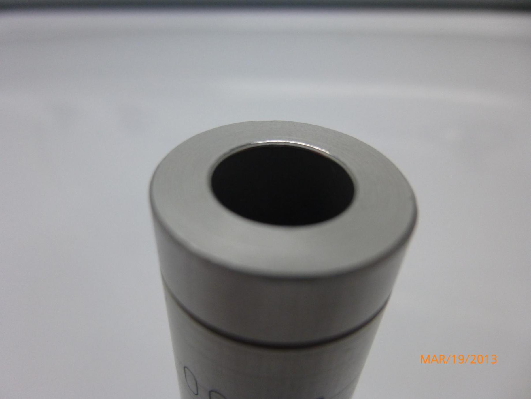

You really need to calibrate a Hornady gauge before use if you want to measure anything but fired cases for setting up a FL die.
The 0.400 bore will read undersize for headspace if placed on a 1.630 "GO" gauge. This base was bored to 0.396 and reads closer to to actual length.

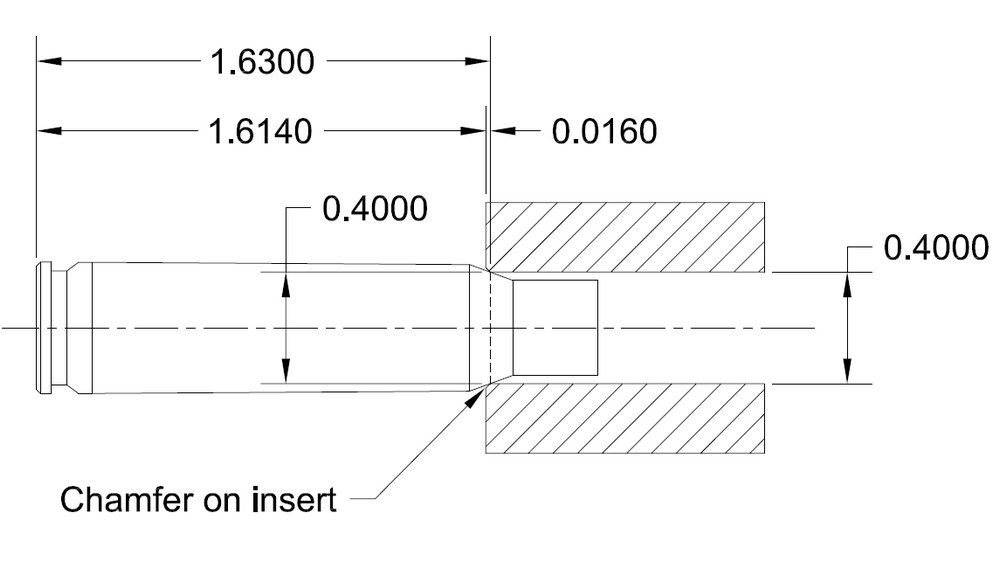

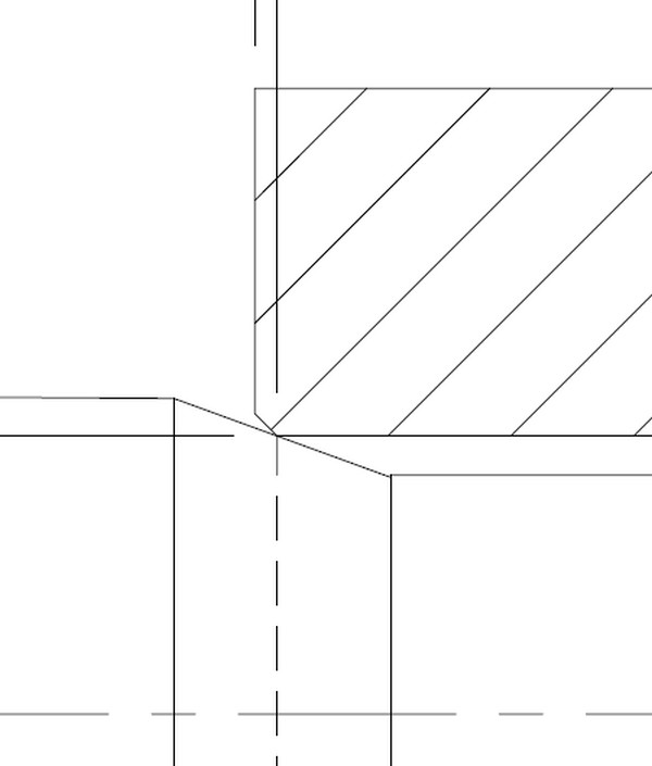

The Hornday bushing is the reason you are getting a small reading and the below diagrams
that I made show you why. The Caliper is being zeroed to the "FACE" of the insert, however there
is a chamfer on the inside of the lip that changes the actual datum point inward from the face of the tool.
Thus you are not getting a good reading based upon the 1.630" headspace that everyone references to.
What you can do is insert a "GO GAGE" into your setup and see what the difference is from the 1.630".
That will be you setback dimension for the chamfer on the inside lip of your tool. Back off that dimension
from the face of your tool and re-zero your tool and I bet the number will be more acceptable for what you
expect to see.
