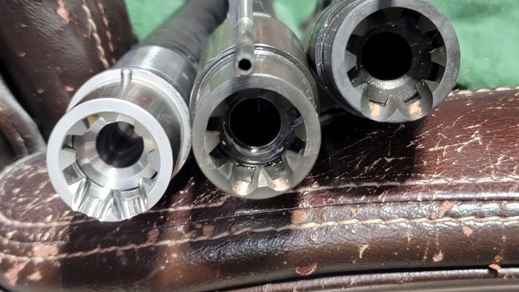

    I noticed the feed ramps on the 6.5CM barrel is significantly different than the 308 SS LMT barrel. Here is a pic of a new Proof 6.5CM carbon barrel with the LMT 6.5CM in the middle and the LMT 308 on the right. LMT said the different feed ramps was to help a specific berger bullet to feed.
    I was having issues with bullets jaming into the left feed ramp (including Berger 130s) . Got clearance from LMT to polish the ramps with cratex and now that problem is fixed and it feeds like butter now with its mirror finish.
