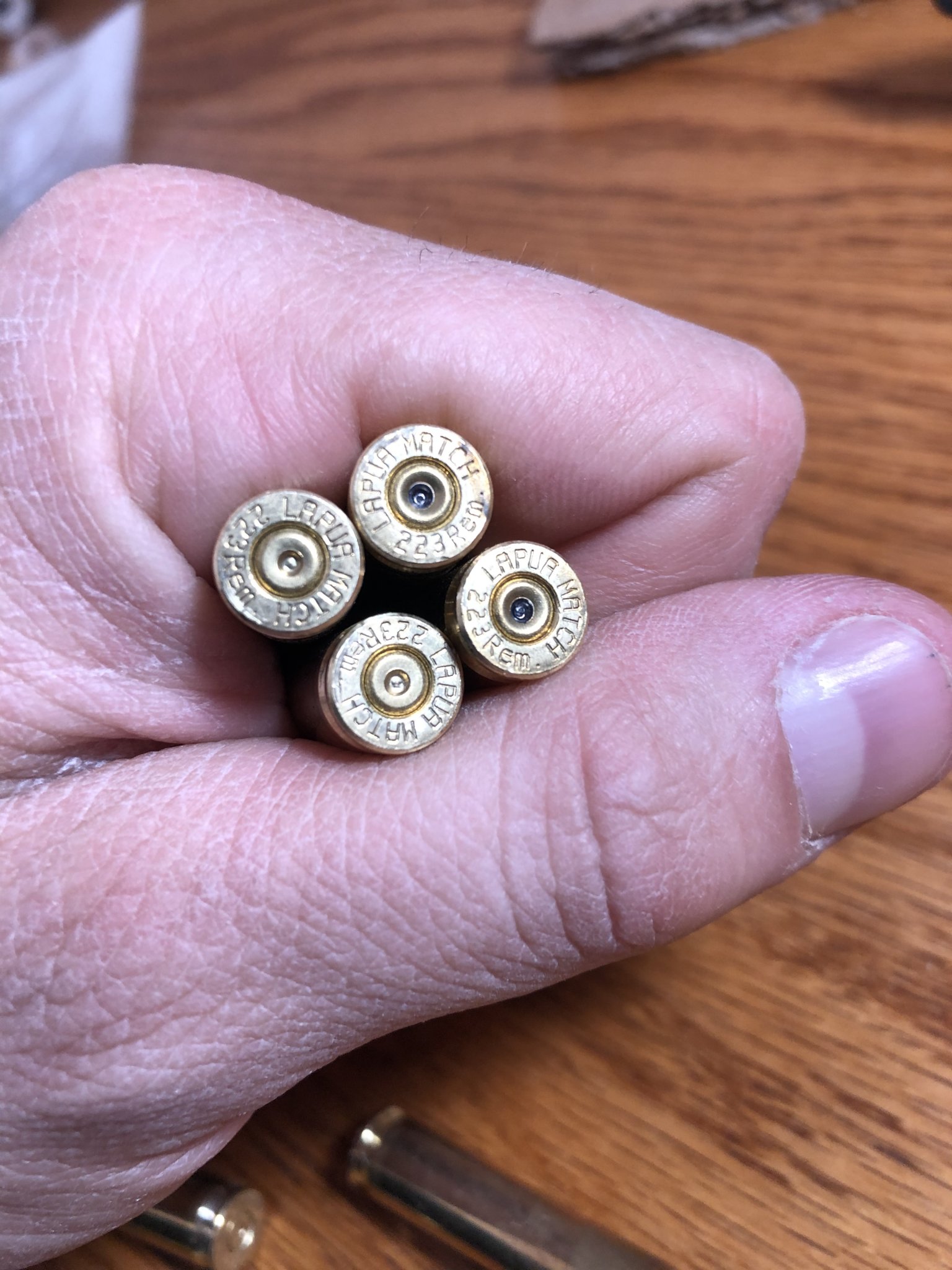

2 primers from where I stopped vs lower ones. Blown/pressure signs correct?

I would check out your firing pin protrusion. Primers don't look like your pressure is too high. I see no brass extrusion.
Winchester. What do you mean by check it out? Are you thinking it's out of spec?
I saw now other signs of over pressure other than that. Bolt was not sticky at all, no extractor marks. Also the velocity was only 2700ish. It shouldn't be at max pressure with a velocity that low right?

I know that this not the time for this advice, but I would change primers to Rem 7-1/2 or CCI BR4 or 450. I do not use Win primers but it seems that most issues that show up on forums are with them.
Pin could be rough or protrusion to much. Definitely try other primers as suggested above. Winchester has had problems with their primers a while back and I'm sure there are some bad ones still out there..

I’d like to think it’s the firing pin and not pressure, but I’ve only seen it on the ones above 24grn and never on the lower ones.

Correct be if I'm wrong, but from the images it looks like the primer is concave all the way down to where it pierced? Usually the primer is flat, minus the indent from the firing pin - I'd strip the bolt and measure the firing pin protrusion and double check that it hasn't become overly pointed before I start chasing too much else.

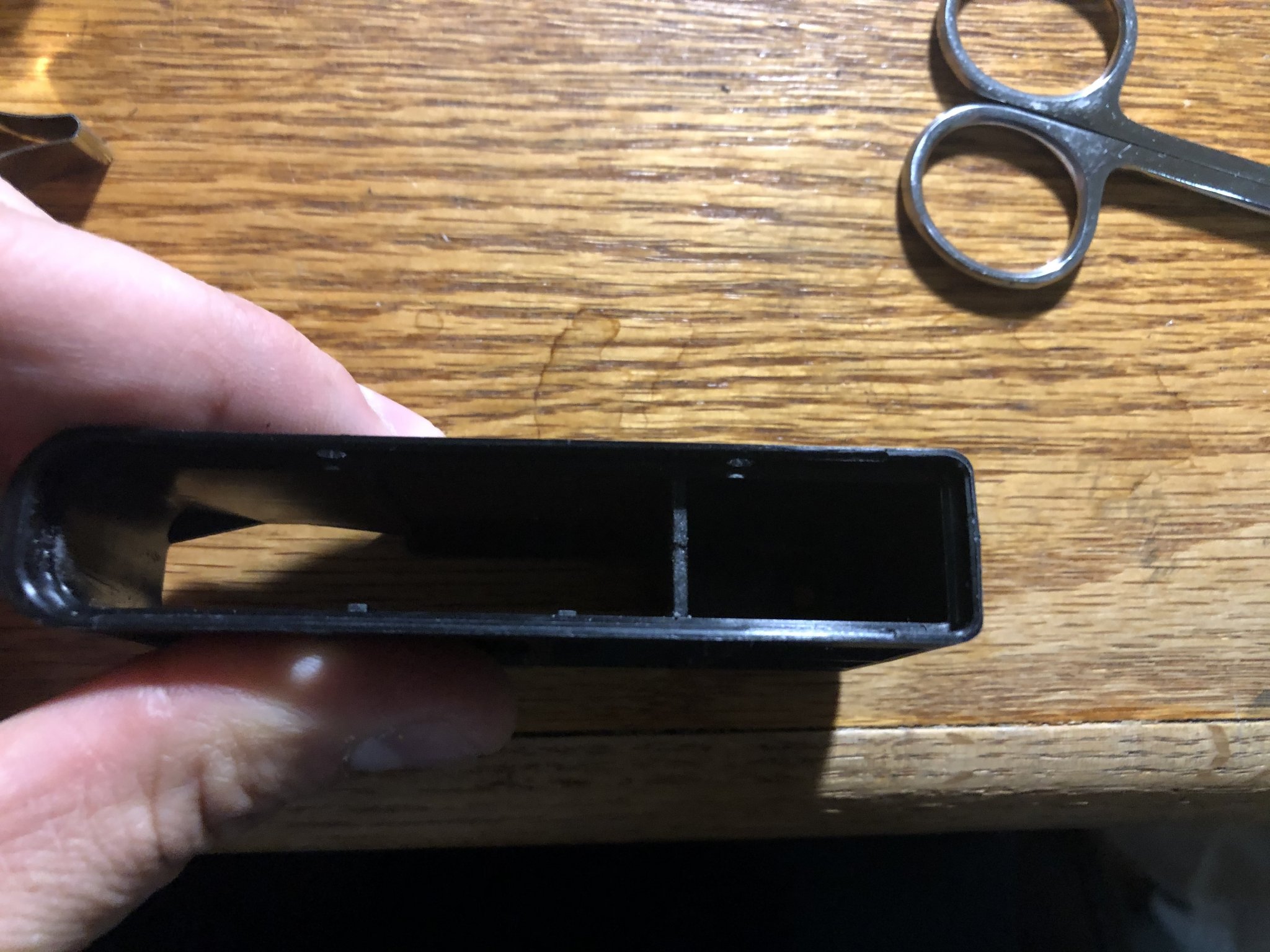

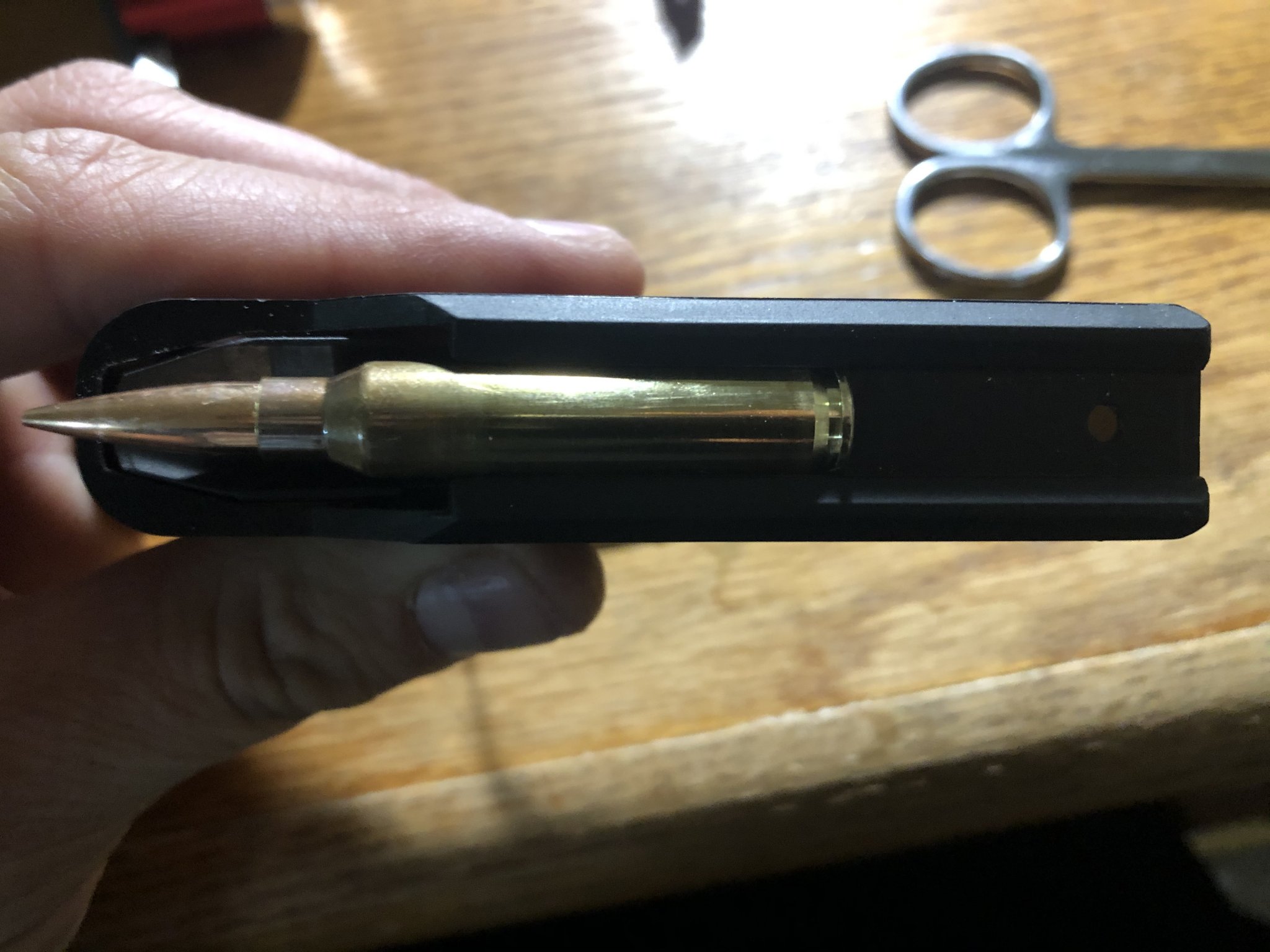

Anyone know of an aftermarket mag that may allow for a longer COAL? Or am I stuck looking for another chassis with AICS mags? There is almost no room for anything above SAAMI specs in these mags

I don't see an easy way to modify that, but it looks like the other calibres use the same mag body, so you may be able to bodge something together with the follower or body from a larger calibre oem mag.
I also found these - https://www.midwayusa.com/product/1022418887
They're out of stock on the manufactures website, but they claim you can load out to 2,6".
Reactions: IdahoSpud
Those are pierced primers. And the ones that aren’t are about to pierce. Note the dome forming at the bottom of the firing pin indent. You have start pressure problems with this bullet.
Have you tried other projectiles. I would try something lighter and work out the pressure quirks first before messing with heavy stuff.
Sierra book gives 26.4 grains max with varget and 69gr matchking. 3100fps out of their 24 inch barrel. I don't know but wonder if a weak firing pin spring could cause the pierced primers.
I haven’t tried anything else. This is my first serious go at it. The ones you say are about to pierce shouldn’t be anywhere near overpressure

Ask in the bolt action rifle section about a weak firing pin spring and one of the gunsmith s will probably give an answer . I don't think over pressure is the cause
Even with a compressed load.
