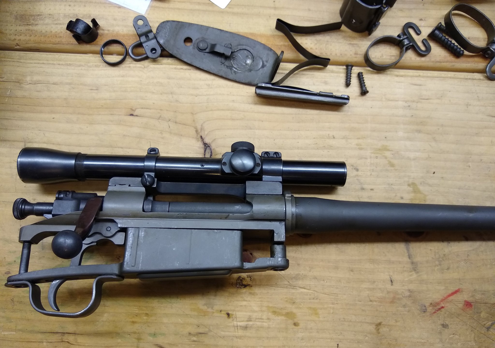

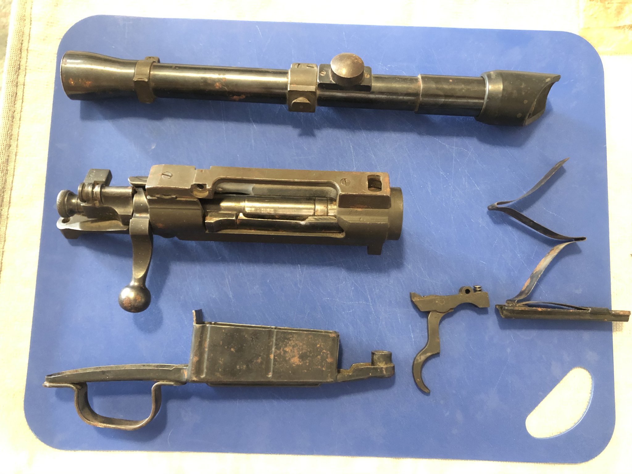

Hello all,
My girlfriend was recently gifted her grandfather's m1903 03-a3 that he was issued during the korean war. The stock/barrel are missing and we were given a box of parts. Does anyone know of a good resource for finding the small parts/pins etc and have any advice for restoring this firearm? I have some tools from working on modern bolt action rifles. Thank you in advance.
Reactions: MarshallDodge
That would be a good start for missing parts. I'm not knowledgeable on the Springfield. There's a few guys on here that are though.

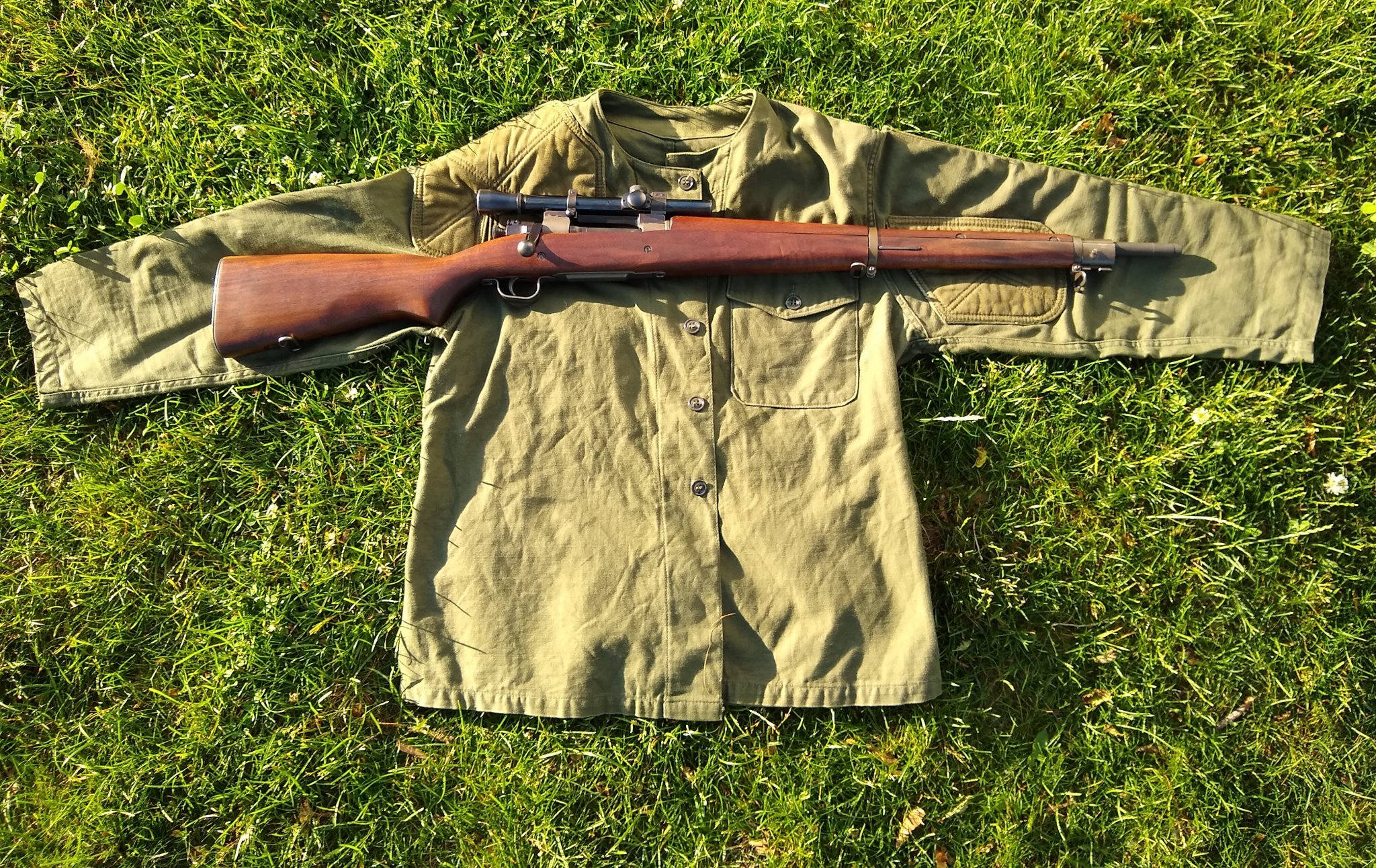

I don't know much about 1903's... but any that were issued with scopes during the Korean War makes your girlfriend's grand-dad someone worth looking up!
You can get his DD214 and records. Which may prove very interesting. Because that likely would have been issued as some kind of makeshift sniper or designated marksman rifle.
Research, research, research. And if it is really something special (which it could well be) then have a very careful and sympathetic restoration done. Regardless of cost. Get it right. There are specialists.
I'll let some of the other guys above comment on the rifle itself. But when it comes to the history, do your due diligence!!

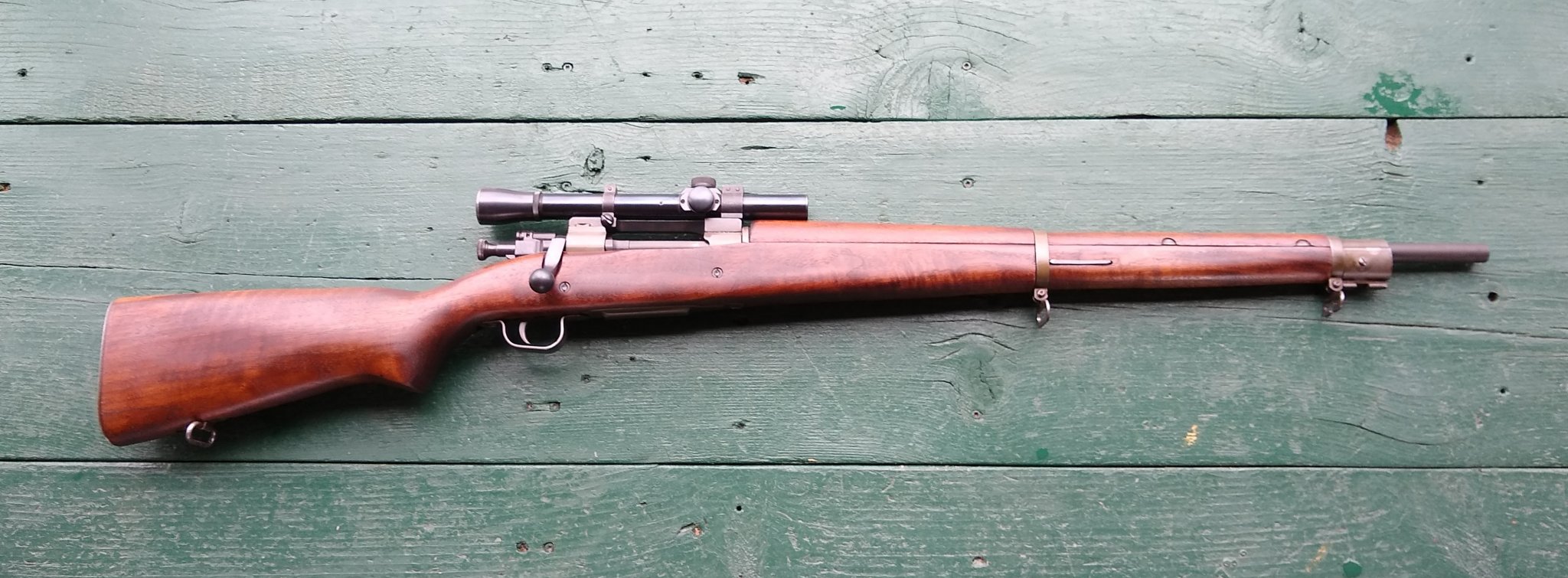

That looks to be an 03-A4 and if so you have a nice pile of money sitting there. The bolt alone is highly sought after.
Post a photo of the manufacturers marking on the front ring. If it is off set left you have a sniper rifle with scope. It will be marked Remington 03-A3 but it is in fact an A4.
I have the name of a good parts supplier I have to dig out. Bought a bunch of spares from them.
Join the CMP and start getting educated. You will find plenty of help to restore that gem.
Look for a Keystone replacement Cstock (best shooter) or a scant stock.
Stand by for more info
Amherst Military Depot.....
Barrels are plenty available but going up in price.
Remington made the 03A4 and finding a Remington barrel might be difficult. Sniper barrels were from the standard production. I think even two groove barrels were used.
If all you are looking for is a shooter I'd suggest White Oak Armory......they make great AR match barrels and at one point were producing 03 barrels. The Criterions would also be suitable CMP sells those. Just about any modern 03 barrel should outperform GI.
The CMP actually has a service to build snipers. If you speak with them, show what you have for parts they will build the complete rifle to include missing parts and stock.
Keep us updated!
Best I can tell from the s/n the reciever at least is an original Remington a4 made in July-August '43. Dont know about the bolt, but probably GTG there too.
If made in July the correct barrel would be marked R.A. 2 -9-43, most common bbl date see on july guns is 6 or 7-43.
Made in august correct bbl date would be R. A. 7-9 43, with a most common date of 7 or 8-43.
Theres a guy named Chuck Moline in Denver, Co. that specializes in rebuilding and restoring '03a4's and theres a good chance he has a correct original barrel and stock along with the other small parts needed.
His business is Warpath Metal Finishing.
You can also find him in the Springfield 1903/1903a3 a4 forum at milsurps.com under the name chuckindenver.
Another recommendation for Chuck at Warpath Metal Finishing, he built me a 1903A4 from parts I gathered and it turned out perfectly! Send your parts to him when you're ready, he can also source parts and usually has some stuff on hand.
Sarco out of Pennsylvania is another great source for parts. Great guys to deal with and really fast shipping.
That is looks to be a Korean war era A4.
The scope is the correct Lyman Alaskan 2.5x with the eye cup and sun shade.
The eye cup is on the sun shade, switch that to the objective and you are gtg 😉.
Nice A4, had to zoom in, too look at it. If it was mine I would either: A) buy an A3 and strip the parts or B) Find an A3 somone has sportarized and pull parts. (hit up your local pawn shops.)
The biggest pain you'll find is the barrel. Its a standard 03 barrel missing with the front sight. The barrels were parked without the front sight, if I remember correctly the A3's were parked with the front sight on, so if you steal a barrel, there will be a spot in the white where the front sight used to be.
Barrels are the easy part. Criterion makes brand new match barrels. They are under $200 and come short chambered. Finding an original barrel,
that would be a trick. You could always go with an NOS barrel and re park it.
Finding and fitting a good stock is a pain, but also very rewarding.
You have the start to a beautiful rifle my friend. Take your time and do it right.
- Jon
