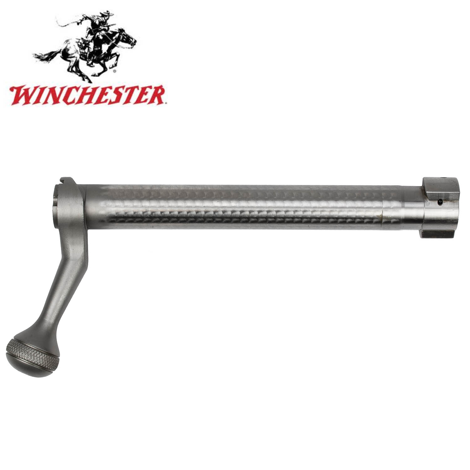

Hi all- I’m new here so pardon me if my search results did not find an earlier post.
I need to find a replacement bolt for a post 64 model 70 in 30-06, push feed. It was lost a long time ago and the rifle is useless. Can anybody point me in the right direction? If I buy a new bolt, are there any head spacing issues or can I just drop it in?
thanks
Bob
Will need to have headspace checked as it most probably won’t be right w/o some adjustment.
Of I order a used one on EBay, can someone walk me through how to properly headspace the bolt?
To do it properly, I would send it to a qualified smith and have them take care of it.
But, because of the extractor cut in the barrel, they may have to cut off a decent chunk of barrel.
It also depends on if there’s too much or too little headspace.
Post '64 push feed guns don't have an extractor cut in the breech, they use a sliding extractor in the right bolt lug and a flat breech face. The CRF guns do have the cut though, so if he has one of those it'll be more of a challenge.
If it's one of the FN produced guns I've had the headspace between bolts be pretty darned spot on, but it should be checked with qualified gauges, obviously.
