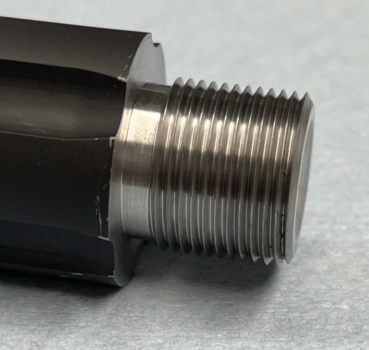

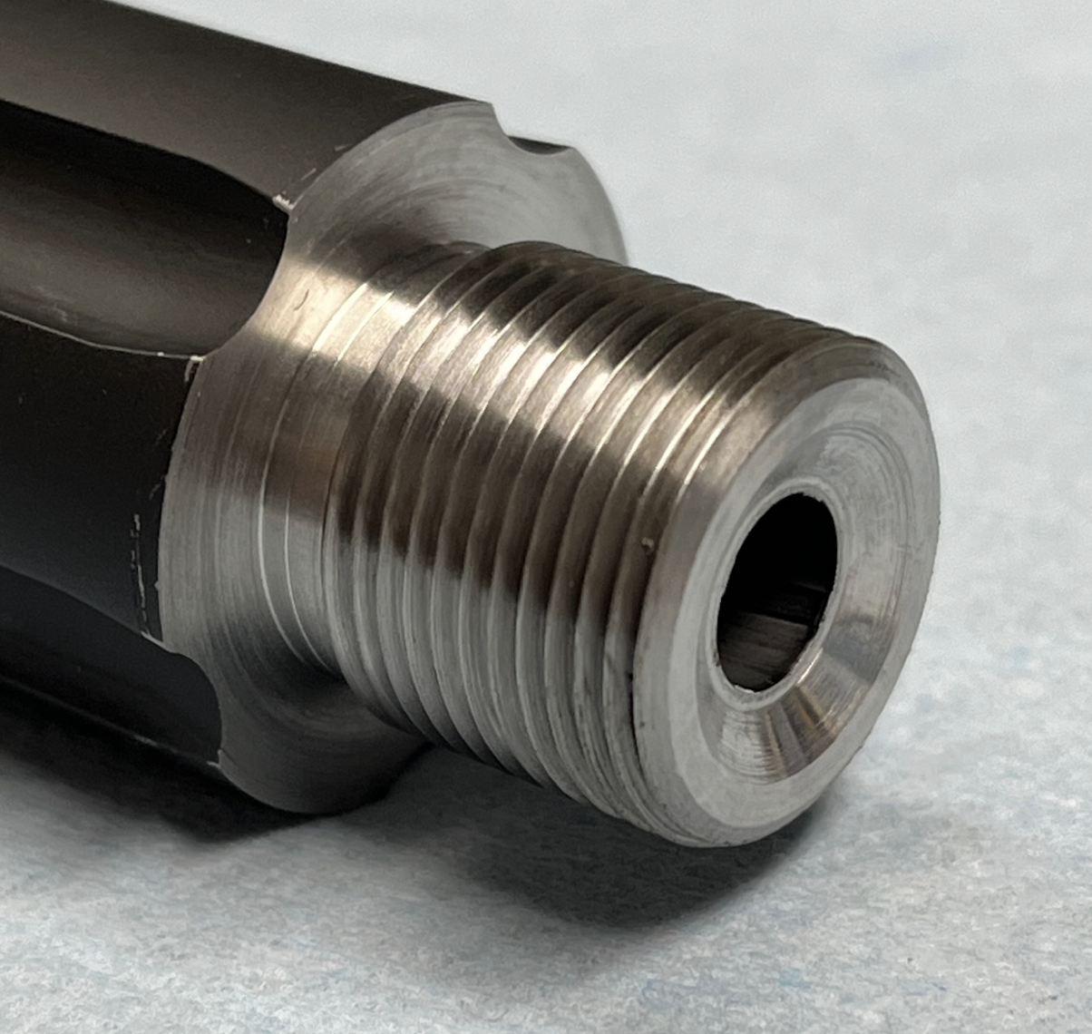

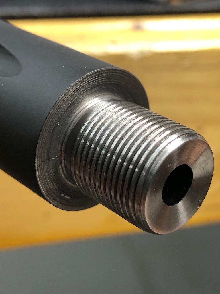

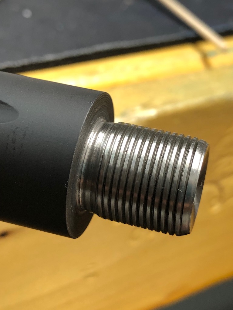

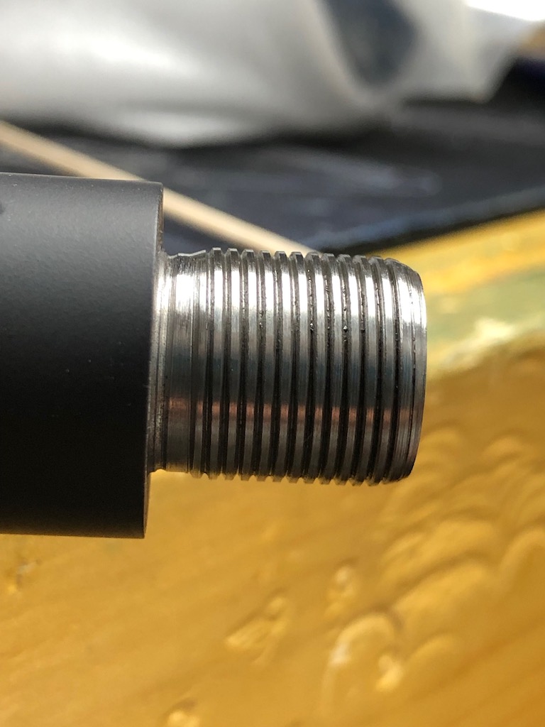

Hey guys. Hoping for a reality check. Buddy a mine just got a new barrel for his precision AR. He's gonna have two different uppers to do longer range AR15 shooting with. Anyway, this is the barrel for the 2nd upper and I've got some questions for the group if you will indulge me.
When he showed it to me the muzzle threading looked way off to me but I'm not a long gun guy. Here's what we're dealing with. It's threaded 5/8x24 and this is the exact condition as received.
Pic 1
Pic 2:
Pic 3:

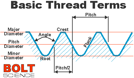

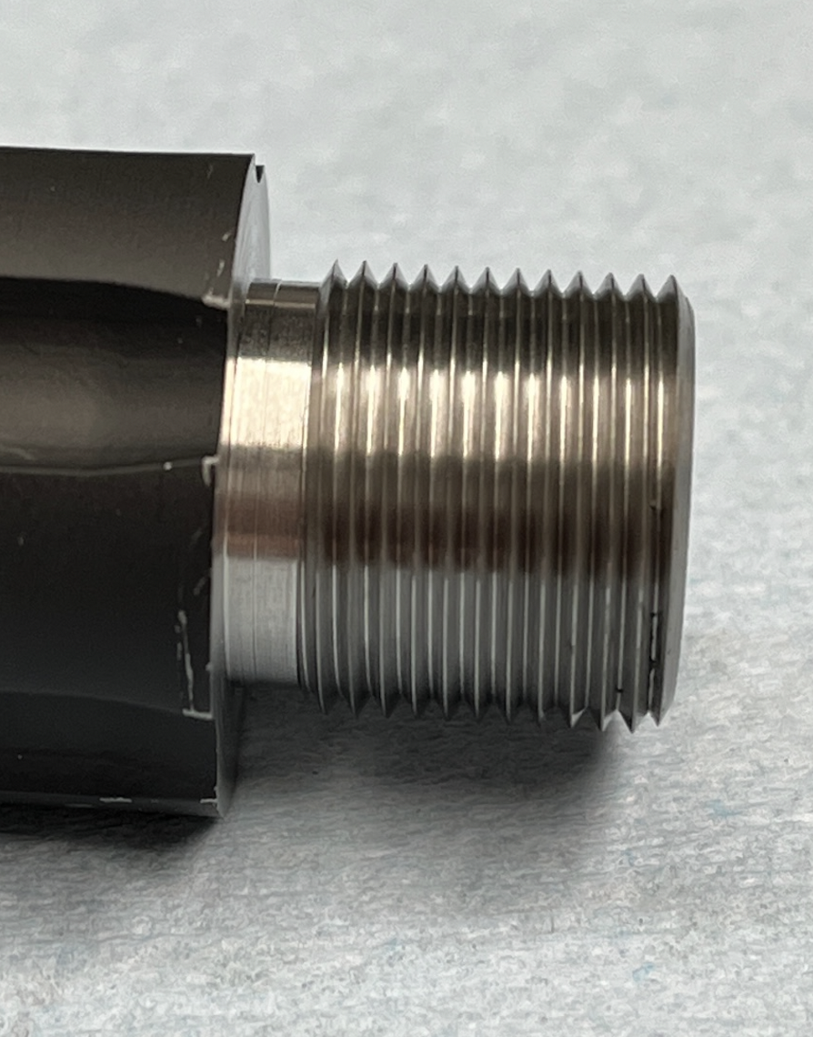

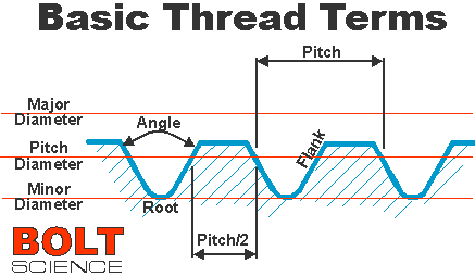

I thought these threads looked way to flat but again I'm not an expert. I did a little looking around for how to measure threads and purchased a Brown and Sharpe thread wire set to measure the pitch diameter. Should be here in a few days. My friend intended to shoot this thing suppressed with his 30 cal direct thread thunder beast. I told him definitely not until we get some info on these threads.
I took a couple initial measurements and as it sits right now the threads are .604" OD. I'll get the pitch diameter dimension when the wire set gets here.

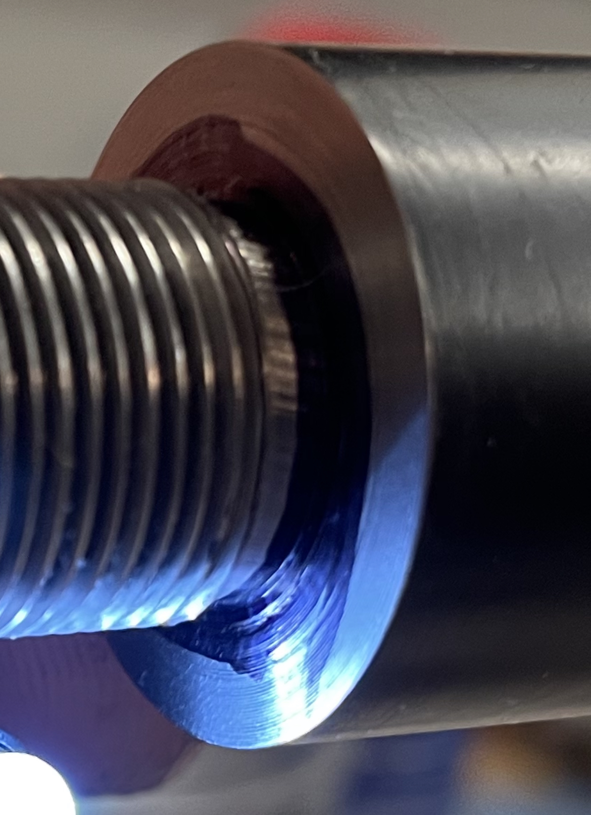

I also measured from the face of the muzzle to the shoulder and it was .668". I watched the video by Thunderbeast saying this dimension should be .600" to prevent the threads from protruding into the can and getting caked up making removal a pain.
Finally, here is a short video of the barrel with my friends TB can threaded most of the way on. Is this movement normal? My can is a CB mount so I have nothing to compare it to.
I don't want to say where he got the barrel from until they have a chance to address it. This barrel was expensive though, over $800 with a bolt and gas tube. I'm also concerned that the machining is so poor on the shoulder that even if the threads were ok it could shift the can one way or another as it seats.
Thanks in advance for any help.
If it was going to be a muzzle brake or flash hider I would probably test the barrel out and see how it shoots- Still enough threads there to safely secure one of those- but no way would I put a can on those.
Reactions: Stoweit
Hell of a QC job lol
I mean how many hands did that go through that all were like “meh, good enough”
I can forgive errors hard to spot, but that shits obvious from the naked eye, and it’s also shiny part of a black barrel, like it draws the eye.
I’d send it back, get the money, and use a known good OEM.
Wrong. Send it somewhere else to get re-threaded.
You don't need to waste your time.
I probably thread and chamber 5-10 barrels a year, for myself, work, friends, etc... Never once have I done a 5/8-24 thread outside of a .621-.624" diameter window. Someone is either incompetent or not paying attention.

Can someone who knows about machining explain what happened? To my amateur eyes it looks like either the threads didn't get finished being cut, or something majorly stripped them or something??? I just cant understand how that went out???? It's so blatant and obvious??? Every shop puts out a mistake or two now and then, I just don't understand this one because it's so apparent.
The thread major diamter for 5/8-24 is .625. Most of us cut them a little smaller as ledzep mentioned above. The OP’s major diameter is .604(a LOT smaller). In other words, the guy cut the tenon too small before threading started.
Reactions: BuildingConceptsllc
3 things going on with any thread. Major diameter, Minor diameter, and Pitch diameter.
In this case, the major diameter should have been .617-.625", but it was cut down to .604". I think the OP or his friend may eventually measure the pitch diameter (pitch diameter basically controls the "fit" of the thread), but the short answer was the threads were cut at least to where they needed to be, maybe too deep... but the big goof here is that the OD was turned down to .604" before they started threading.
They made this instead:
Ok, so this is why I asked... so they cut the diameter too small before they even started to thread it, then threaded it anyway.... I think I'd just ask for my money back instead of a new one. It's hard for me to believe whoever did it, didn't know right?
The major diameter was machines too small.
But it’s pretty apparent, even to the naked eye. Even if a shop doesn’t gauge every thread on a proven program, that one is hard to miss visually.
Doesn’t look like you can re-thread that barrel without cutting back into flutes. No way I would cut back into flutes in a brand new custom barrel. Likely your Smith trashed your barrel unless he lops off the threads and crowns it for an unthreaded version; possibly to resell.
Either way, you will likely need a new barrel. Sorry for your situation. I just had a similar circumstances with a threaded barrel from a local smith.
These threads were purposely cut 0.010” oversized. Problem was the 0.003” shoulder left on the the face of the barrel. The lip has permanent marker on it abs you can see the light hitting it just behind the threads (about at the location of the outer diameter in the face of the barrel).
Pic 1
Pic 2:
Pic 3:
