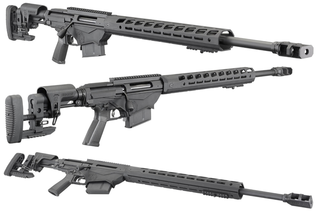

Hello,
I am a military veteran and I just got a new RPR .338 LM and I want to start getting into precision shoots and competitions. I am looking to find out best recommendations for the bipod and scope. Currently looking at the Vortex Viper HSLR 6-24X50 FFP. Thoughts?
Also, anyone who has shot this RPR and caliber have any changes they recommend for performance? Only upgrade I have read so far was on swapping out factory magazines with a Magpul or AI magazine for better feeding.
Any help is greatly appreciated.
Thank you.

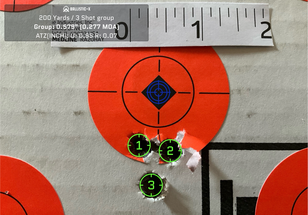

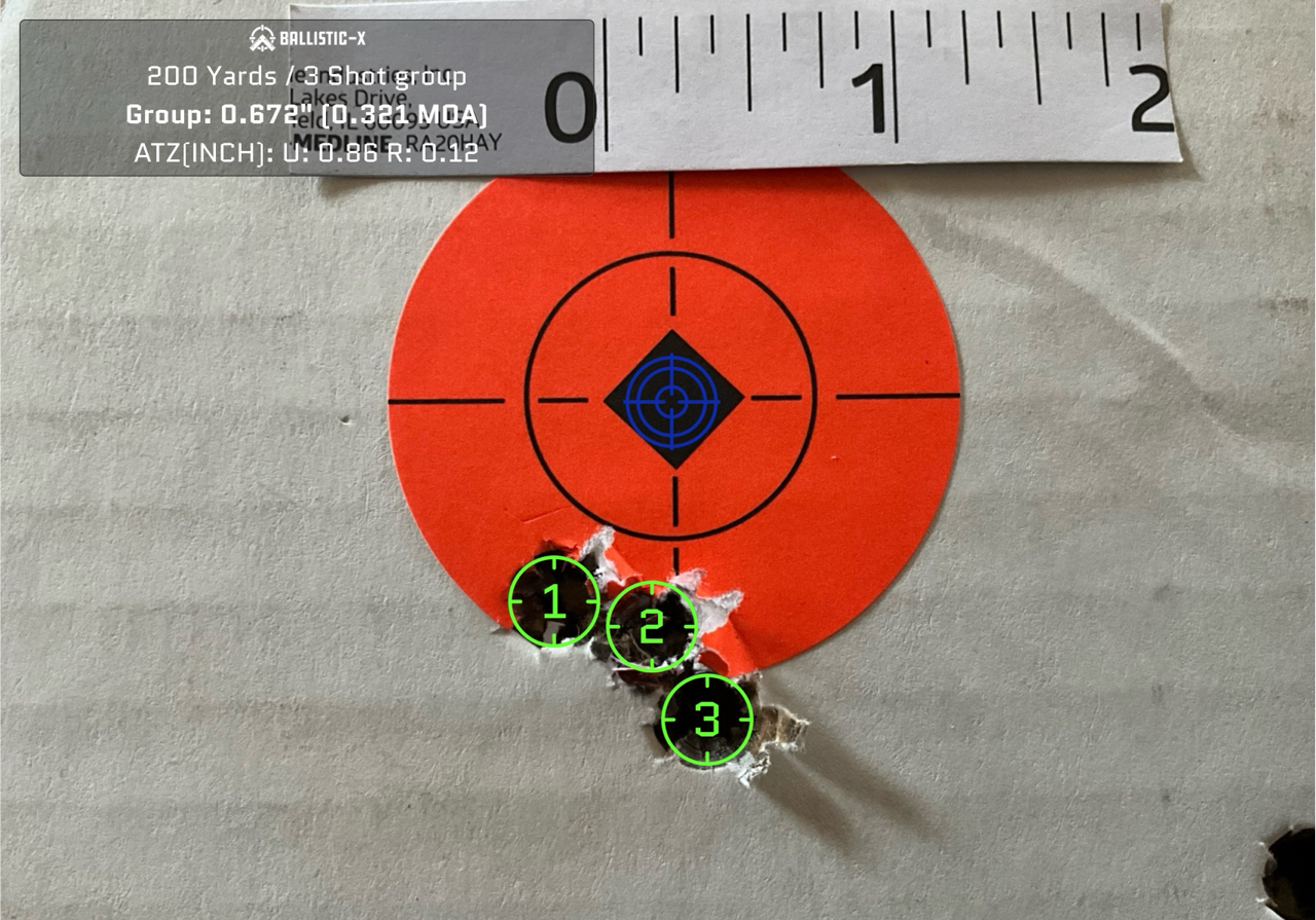

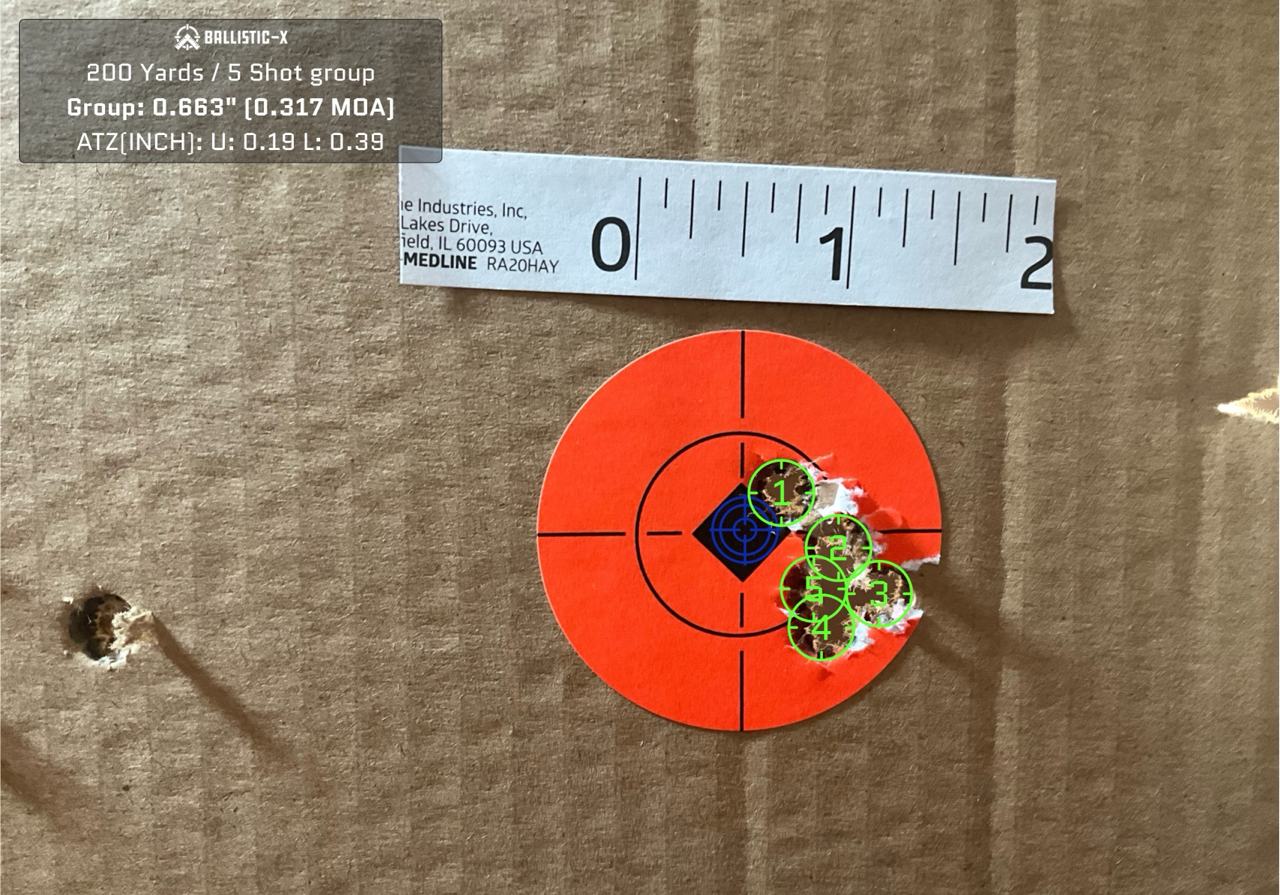

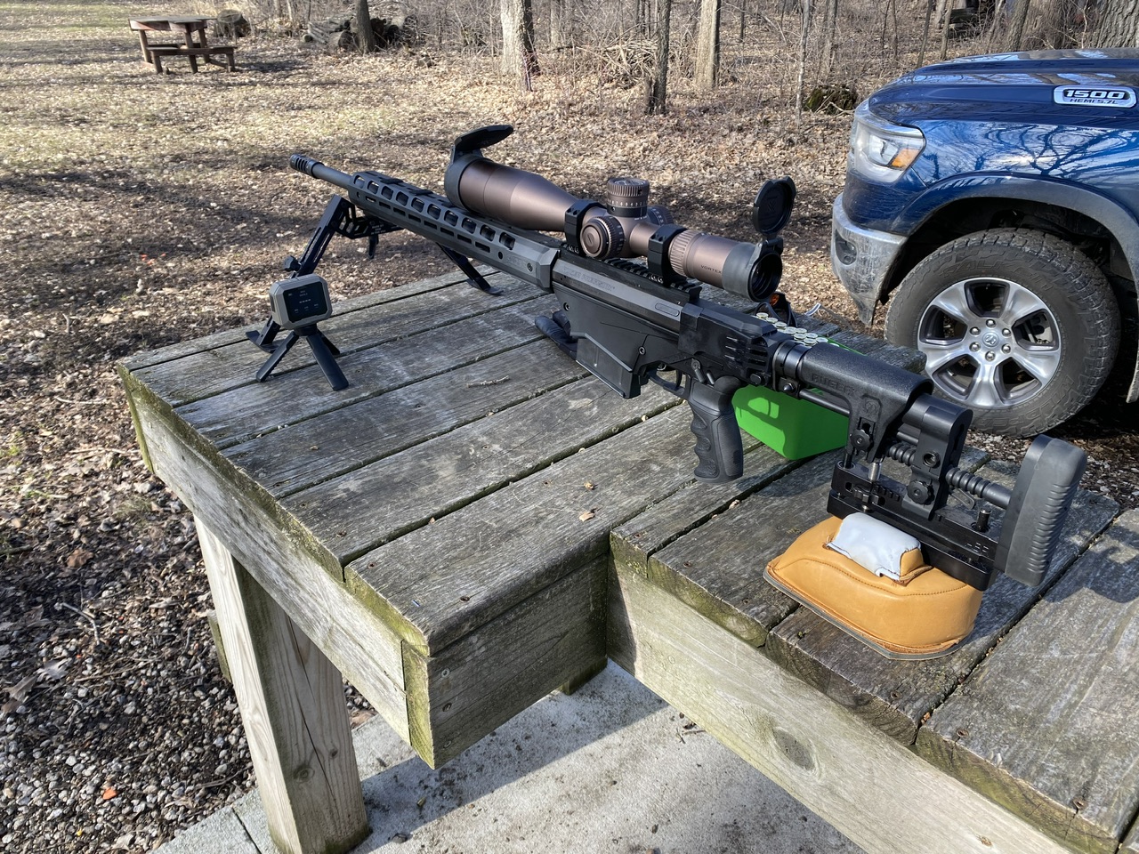

The RPR 338 Lapua is my favorite rifle too. I’ve owned it since 2019 and I’ve been through 1500 or so rounds by now (over 800 since July 2023). Got tired of waiting for the Triggertech trigger and got a Timney, glad I didn’t wait any longer (curved, prefer the straight on my 6.5 RPR), Vortex G3 (Never though I could justify anything beyond my PST II’s, but now I want to replace the other 2 I have left as well). Also have an ABR (https://www.adjustablebagrider.com/) and the matching Protector rear bag. I don’t shoot competition and its only purpose is informal 200y ”group therapy”. I’ve used H1000 since day 1, but since it was unobtainable at some point, looked for alternatives. LRT gets the velocity but no consistency - and groups. N170 gets me there and I don’t think I’ll switch back to H1000 since N170 appear to be cheaper these day (less expensive is probably more accurate). I don’t get the hype about N570, it smokes more than black powder if you ask me and doesn’t get me any additional velocity over n170. Best results I’m having with 250 Scenars and 300 Bergers. I’ve tried 285 ELD-m and 250 Bergers but got less accuracy, 250 Bergers I might as well throw at the target as there is no neck to provide any tension.
Recently replaced the brake for a EC tuner brake. It doesn’t look as good as the factory brake, but as a brake it works just as good. I think it also helps to shrink groups. Bipod is Mystic. Works OK-ish, but there’s no way to torque the legs to a point they don’t shift up. I’ve asked Jerry, the original Mystic guy and he simply replied to find something aftermarket. Still waiting for EGW to come back with a solution.
Anyway, I’m trying to hurry up and wear out my barrel so i can upgrade to LRI, but so far I’ve not been able to improve my skills to justify the barrel swap… yet.
