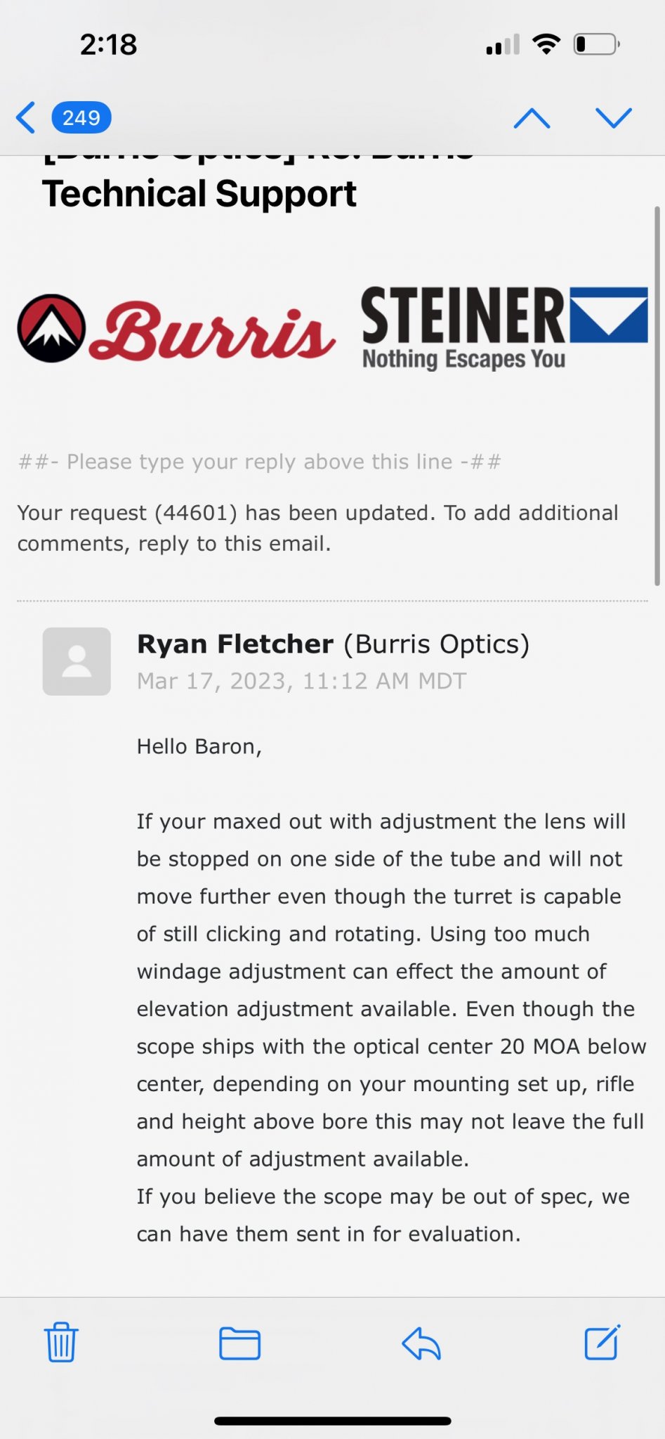

I recently found a possible issue with my XTR pro’s. While checking tracking and level I noticed that my reticle stopped moving around 13 mils but the turret kept turning until 19.4 mils. I checked my other 2 Pros and they both did the same thing ranging from 13-14.7 of reticle movement but turrets continued to turn after reticle stopped to 19.2-20.5 mils.
I lifted the turrets to bypass the zero stops and had around 8-10 mil of travel below the zero stop and the reticle and turret both stopped at the same time. Which shows I don’t have the full 26 mils of travel as advertised.
Below is the response I received from Burris and the way I’m interpreting it they are saying it’s normal??? They are willing to check it out but don’t want to send it in if this is normal.
Thanks for everyone’s help with checking theirs.

Were you starting from the factory optical center? Or are you bottoming it out & then counting MRAD running the elevation through full adjustment in the opposite direction? I may not fully understand how you adjusted...
Advertised 26mrad total elevation - 13mrad up, 13mrad down...
Except Burris ships the optic with optical center 20moa (6mrad) down (compensate for standard 20moa rail)
So it should ship like this: 13mrad - 6mrad = 7mrad usable "down" elevation, 19mrad usable "up" elevation for bullet drop @ range
I’m not overly worried about the overall travel, that was just a rambling side note I guess.
The main issue is that when dialing up with the turret, the reticle stops moving around 13mils but the turret continues to turn until around 19-20 mils.
An example, say my data says dial 14 mils. I can physically dial my turret to 14 but the reticle stopped moving at 13ish so now I shoot thinking my reticle dialed with the turret and I’m about 1 mil low because the reticle didn’t keep moving with the turret. Not having the reticle and turret stop together I don’t know when I need to start holding over to compensate unless I remember the 13ish mil stopping point instead of a hard stop
Hopefully that example helps explain. My turret will physically turn to 19-20 mils above my zero range but the reticle stops around 13. This happens with all 3 of my Pros. I checked my other scopes and all of them the turret and reticle stop moving at the same time.

I am counting from my rifles Zero. All 3 have 20moa rails but for some reason the Pro on my tikka has the most reticle travel up as well as the most turret movement. Its reticle stops at 14.7 up and turret stops at 20.5 up. The other 2 Pros both stop around 13 but turrets continue to 19.2 for one and 19.4 for another.
Oh, I see. Yeah that would bother me too - I bet my XTR3 does this, but I've only shot it to 800yd w/ a .308 (dial 8ish mrad)
Out of curiousity, using the Pro on your Tikka - your reticle stops at 14.7mrad "up" from zero, do you have 11.3mrad "down" from zero?
Edit - My XTR3 does not do this. The elevation turret & reticle both track "up" to 17.5mrad & then stop immediately.

Ok, I have to eat crow. I’m a complete idiot. I re tested today and everything was fine. Not sure if it was because I was using an angled roof line next to my house or I wasn’t steady but no matter, today I locked the rifles into my tripod and used a barn roof around 1k yards out to accentuate the reticle movement and it moves the whole time on all my scopes.
Sorry for the waste of time guys. And thanks for the help.
