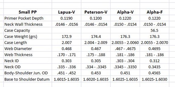

I have two small rifle primer pocket tools that I use. One is a RCBS Primer Pocket Uniformer and it's diameter measures .1725". The other is a 21st Century uniformer and it measures .1710". I use the RCBS on most other brass (e.g. Lapua and Peterson). For my Alpha brass I use the 21st Century one.
The first time I used the 21st Century uniformer to clean some fired Alpha .308 brass, it was kinda tight. It would slip into the pocket of the Alpha brass about half way and after just a little turning, it seemed like it broke through a point there and would reached the rest of the way to the bottom just fine. It seemed odd . . . almost like there was a donut of some kind half way down the pocket.
When I seated the virgin Alpha brass with CC-400's there was just a couple that were difficult to get seated to the depth I intended (.003 below flush) and would only go to .001 below flush. I used a 21st Century hand seating tool that's adjustable for seating depths, which has plenty of leverage making it easy on my old hands.
For those who might be interested, here's a chart of measurements I took comparing .308 Lapua, Peterson and Alpha virgin brass:
Reactions: aam and RegionRat
