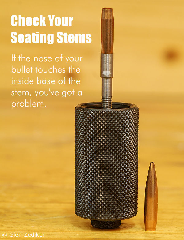

I am not sure this is a valid test, reseating a bullet multiple times can deform the area that the seater contacts the bullet. I suppose if your seater is a perfect match to the bullet then this may not happen. I do notice if I set up my seater die and I have been using the same case/bullet to slowly adjust the die down that using a fresh bullet will be slightly different then the one that has been through the die multiple times.
