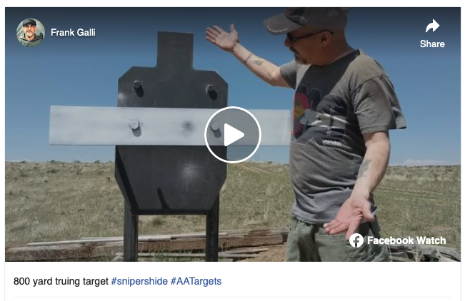

I need ideas and information about choosing/making steel targets to permanently place on our land. My local range only goes to 540 yds. On Everyday Sniper, Frank has talked about a 0.2 mil tall horizontal bar hanging in front of another steel plate to true rifle trajectory at range. I searched the forum and can't find a picture of this.
