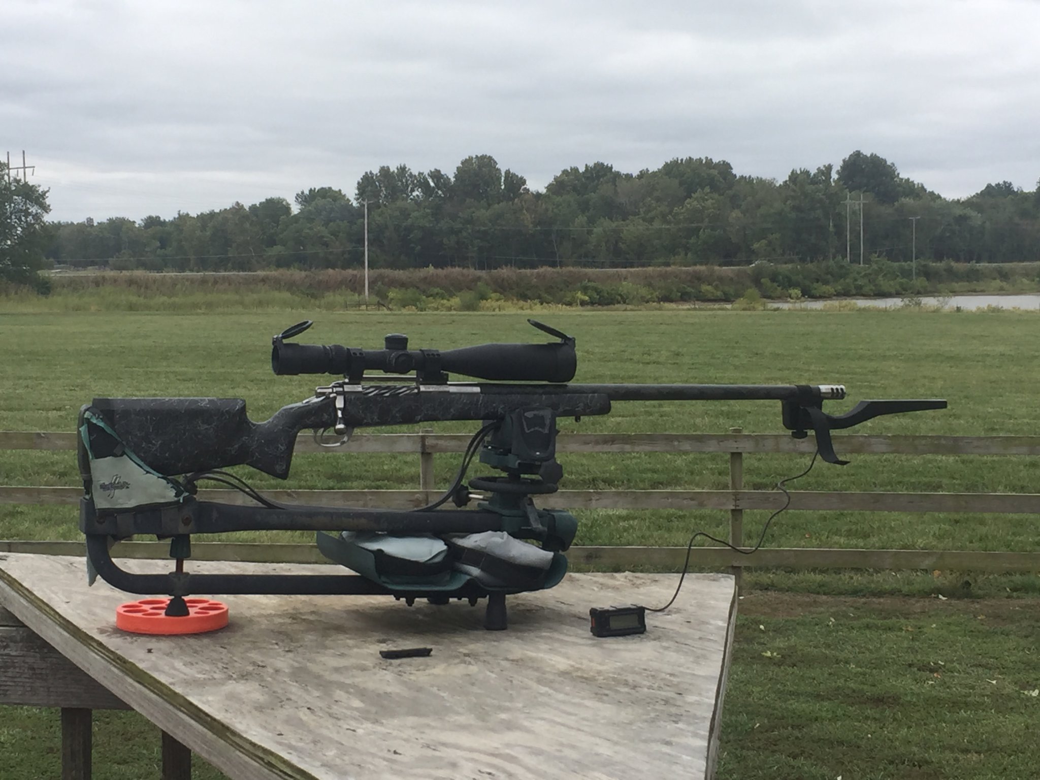

Thanks for the advice. That is my usual aproach but this is just a minor hobby for now I hunt way to much out west and whitetail in Arkansas Kansas and Oklahoma along with 2 little girls to have a whole lot of free time for this. I do however appreciate nice things and all the help I get here members help me build this 338 Lapua that is my go to for western hunting!
Reactions: bman940
With my ThOR 4 on top of my 6.5 CM I would have zero issues shooting to 400 yards. There is a ballistic app you can use for range and a range finder made by ATN ( I do not have one) that fits right next to the obj lens and sends info to the scope which then adjusts the reticle for your shot. It looks very cool but I haven't used it. Most of my shots are inside of 250 yards and the 6.5 does great with zero adjustments.
