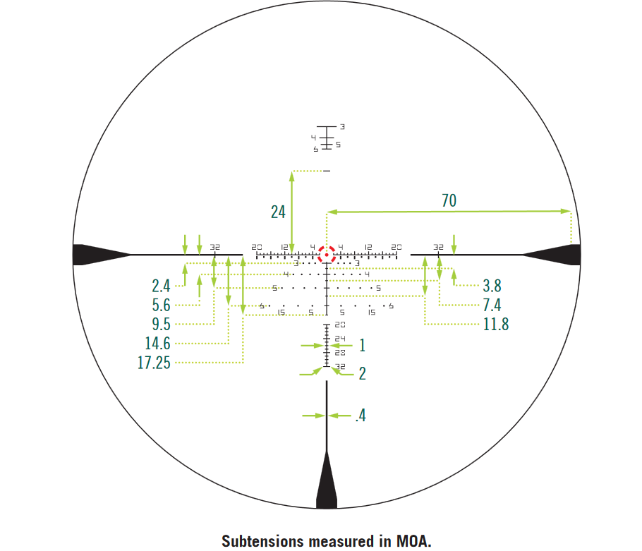

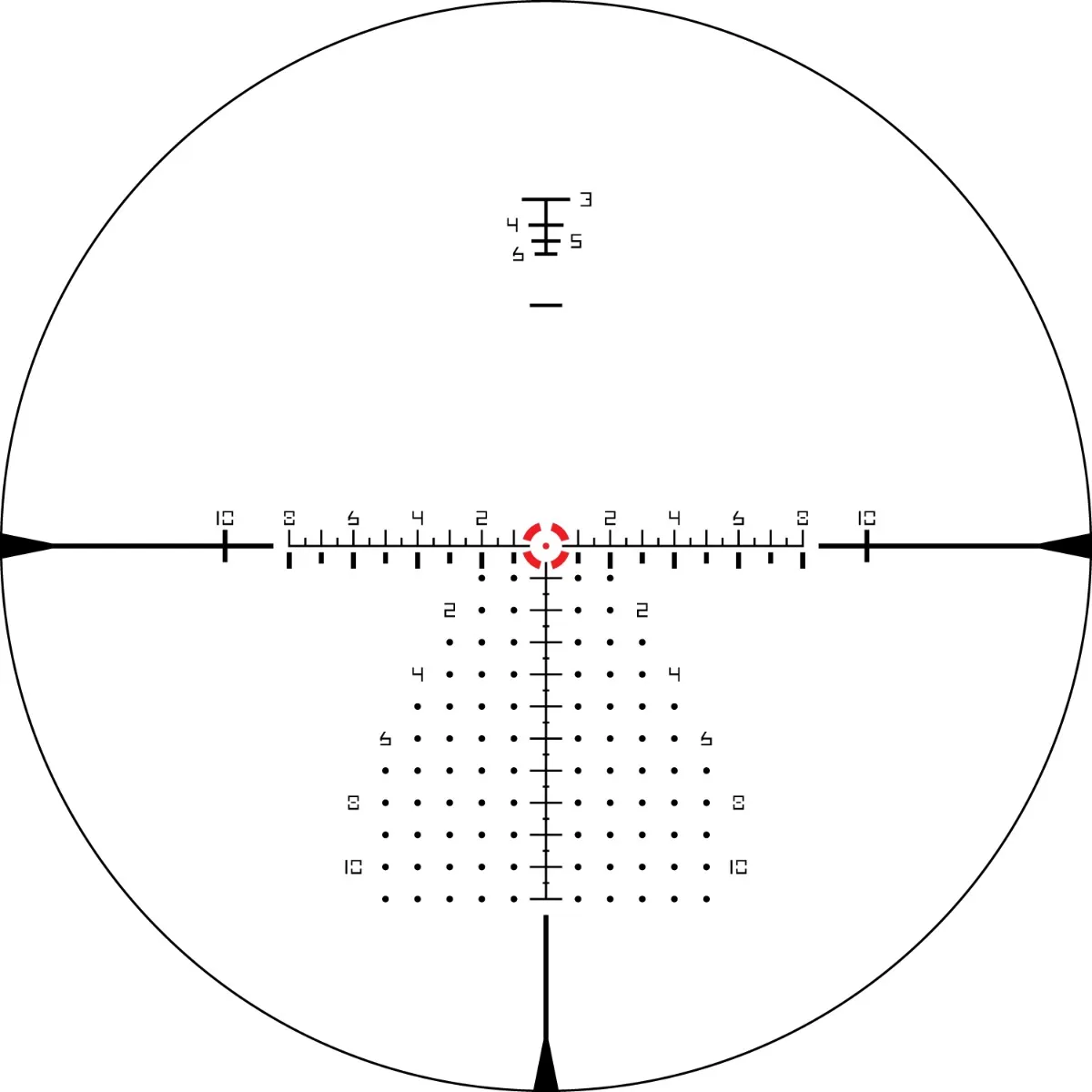

Not exactly
The EBR-9 MOA reticle is a tree reticle with elevation and windage major subtensions every 4 MOA. It does have a BDC embedded in the wind tree, but you can ignore it because ever major hashmark down from center is 4 MOA.
When in doubt RTFM: https://vortexoptics.com/media/wysiwyg//sub_RazorHD3_EBR-9_moa_1-10x24.jpg
It works exactly like the EBR-9 MIL, it's just in different units.
Pick whichever one is in units you like best.
EBR-9 MOA
EBR-9 MRAD

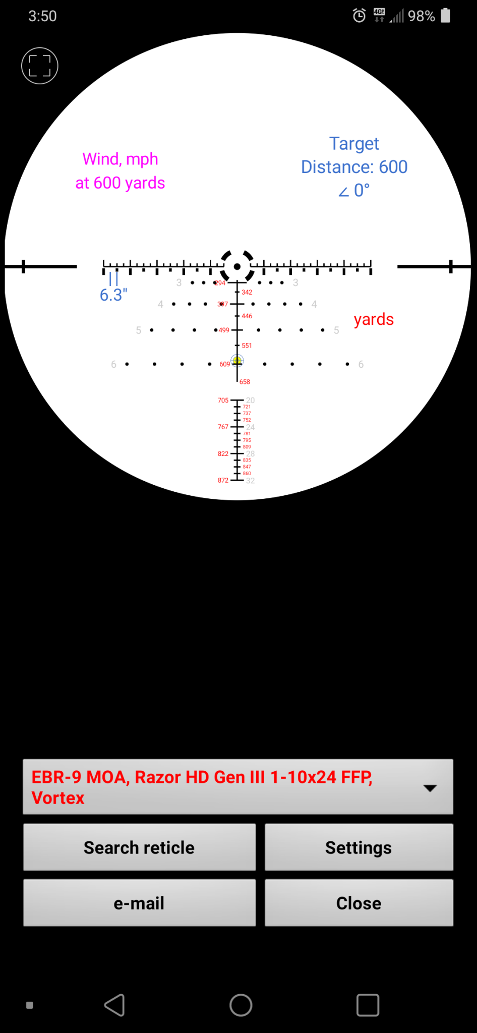

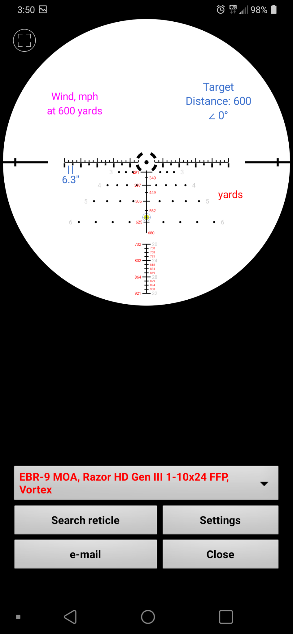

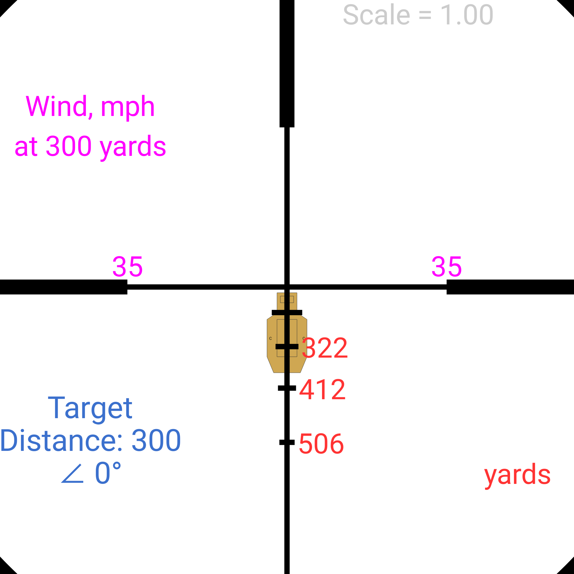

It's always worthwhile to run some numbers through Strelok Pro to evaluate whether a BDC reticle is going to work for you.

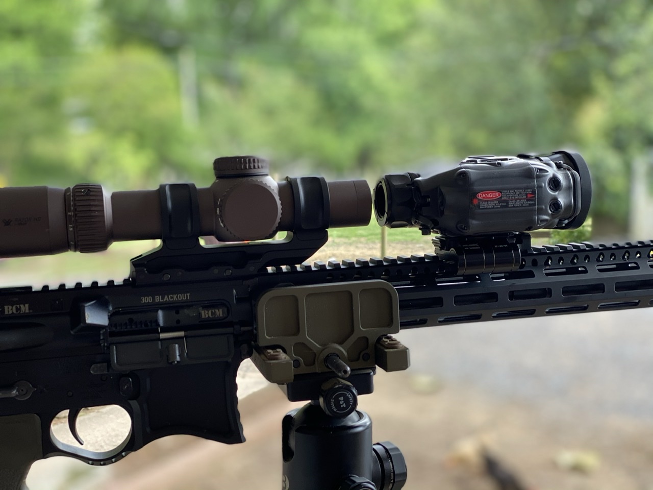

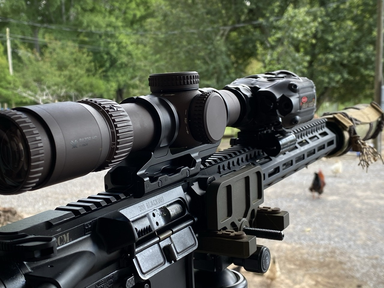

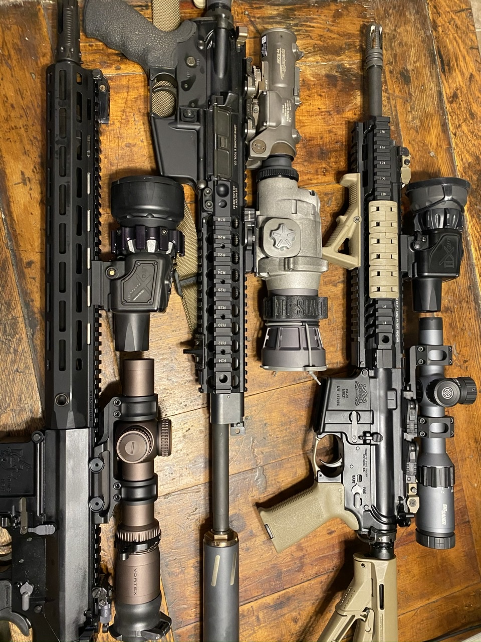

I built my entire rifle and ammo around the Gen3's BDC, and, surprise, it works great for me. Some people forget that's an option, and it's not necessarily a terrible one in all circumstances.

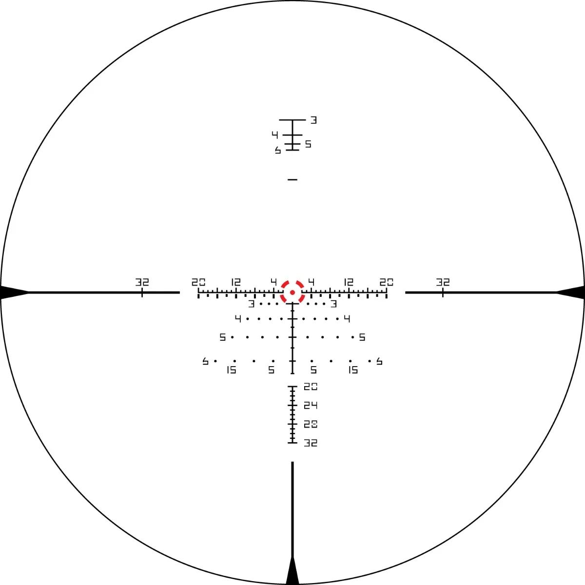

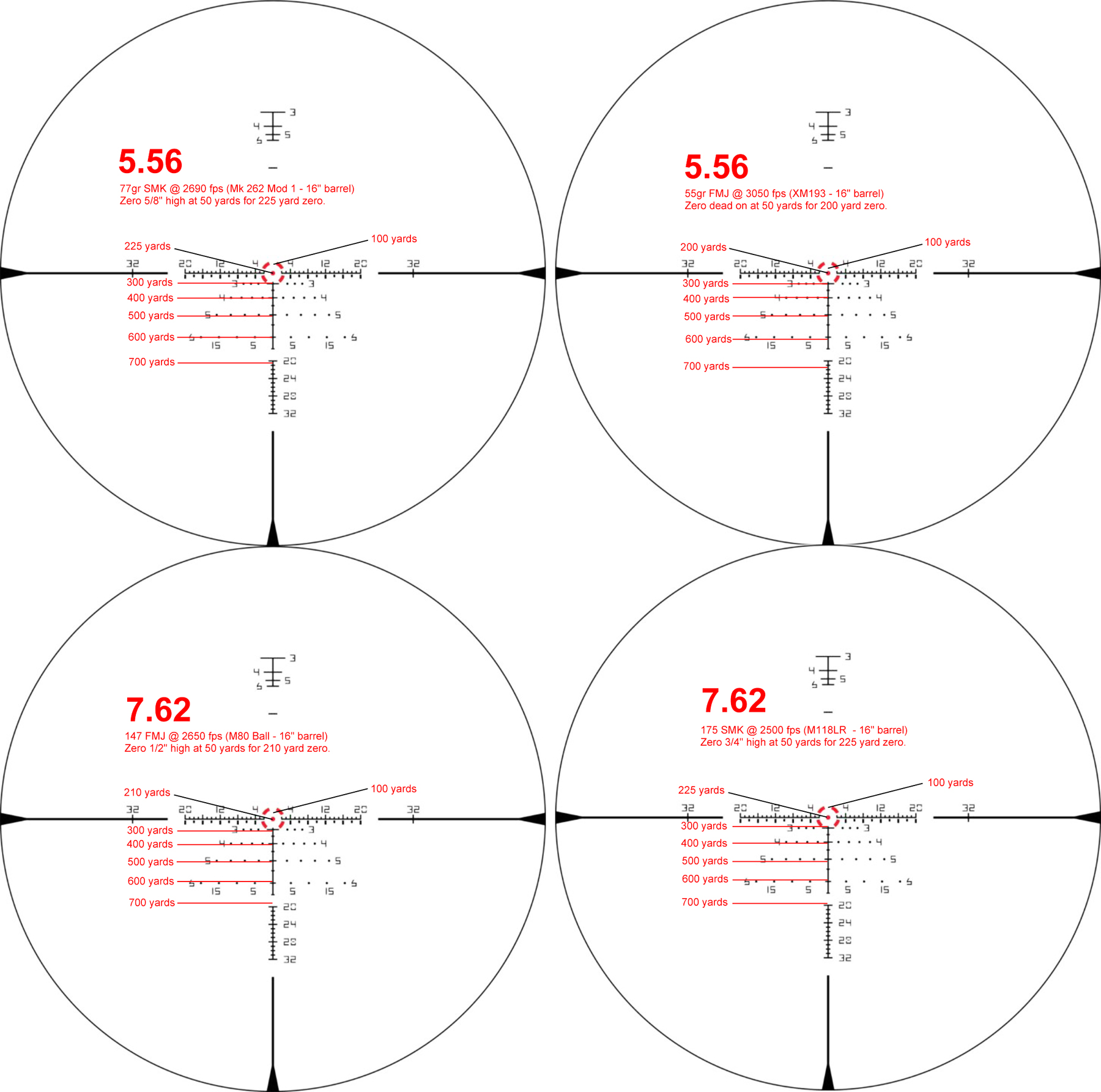

The EBR-9 MOA isn't laid out in 4 MOA increments, there's definitely a BDC in there. It follows the typical Vortex subtension scheme down to 600 but with added details. Past that there's a 2.75 MOA gap until you get to 20 MOA where it's a 1 MOA increments to 32 MOA.
I reviewed a Gen III 1-10 a while back with the MOA reticle and ran some numbers with both 5.56 and .308 in different bullet weights to make this comparison graphic. Nothing is perfect so to get it to work with the different bullet weights requires some tweeking at 50 yards but it should work out with common 5.56 and .308. For the length of time I had the Gen III, I wasn't disappointed I had the MOA reticle, it wasn't that hard to map out but MRAD would've been my preference if I was buying it.

The graphic I found in the vortex website didn't have all the detail that yours has.
Now that I look real close at the distance between the vertical subtentions I can see they're not equidistant.
I stand corrected.
But you're right it does line up close. And for a hunting or battel rifle, the MOA one would be my choice.

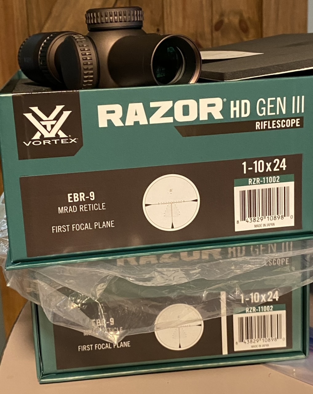

I mention that because I just bought a Gen III from Scott at Liberty Optics and I originally put in the order for the MRAD reticle; however, I then changed it, as much as I've harped on BDC over the past few years, I decided to give it another try...
Thank you for your input. Seems like you've had a good amount of experience with the MOA reticle and still prefer the MRAD. Would you still prefer the MRAD for speed? Seems like the BDC is accurate enough and you don't have to remember anything when on the timer, where the MRAD you'll have to remember the holds. That said, I'm leaning toward MRAD because of its versatility if I want to put it on something else that may not be 5.56/308 or push out further, It's also something new for me to learn.

This might be what I do as well, but the other way. I'll get the MRAD and if it's not what I'm looking for in sure someone would trade me for an MOA or I can see it and buy one.

MOA is obsolete and is slowly dying (not fast enough)
MRAD is easier math, smaller numbers and based on a 10 scale. Faster and more intuitive, not to mention the entire industry and mil talks in.... Mils.
That's what my friends have been telling me, however I've been using MOA for a while and it's easy for me to understand. That said, everyone says that mrad is easier so I'd like to learn how to use it.
Taken on their own, MOA isn't easier or better than MRAD and vice versa. As long as the subtensions and knobs match, it's all just numbers.
In this context, with the GEN 3's MOA BDC and MRAD reticle, I feel the MRAD is easier to work with. I say that because you're not trying to bend the reticle to your will by tuning zeros and getting as close as possible to the subtensions. The EBR-9 MOA works but like I said, my preference is always for MRAD.

Holy crap! When you’re right, you’re right. Please accept these images as my formal apology.
Now we're talking. May I inquire as to what that little piece of eye candy is sitting in front of the Gen III (yes, showing my ignorance of Thermal gear). At least you and I have one thing in common - we both like 300 BLK ;)
Thanks for posting this pic! I told my wife that this vortex scope only works correctly if there is a thermal out front of it! She said I need to get to saving for the thermal then! I’m lucky she never complains of my spending on gun items just encourage s me to get what I want the first time and not cut corners….im going to need to do some research on thermals

The efficacy of BDC reticles can be argued until the cows come home but I still think Vortex has one of the best BDC subtension schemes out there save for mils. Their zero, 2.4, 5.6, 9.5, 14.6 subtension is carried across all their BDC's, only the designs change based on the model but it works well for common factory 5.56 like 55, 62, 75, 77 gr bullets. You may have to play with your zero offset but you can generally get them to line up pretty good.
davsco, I ran some quick numbers on yours but man I just think the MV isn't going to let it line up but like you said if you know your drops and they're working for you, I'd keep on keepin' on.

Ok, hear me out. If you zeroed the 55gr PMC 1/2" low at 50, the BDC boils down to 100 yards at the crosshairs, then 225 yards, 322 yds, 412 yds, 506 yds. That'd be a MOA or less difference out to 500, your stated max range, so it could work.
i appreciate you working on a possible solution!! first thing i need to do is see how accurate the pmc is at any distance. then i need to play with bc's and see the wind effect vs the 69 smk's. i def don't want to give up accuracy or a lot of windage just to have 'easier' holds. i have some research and playing around on my side to do...
