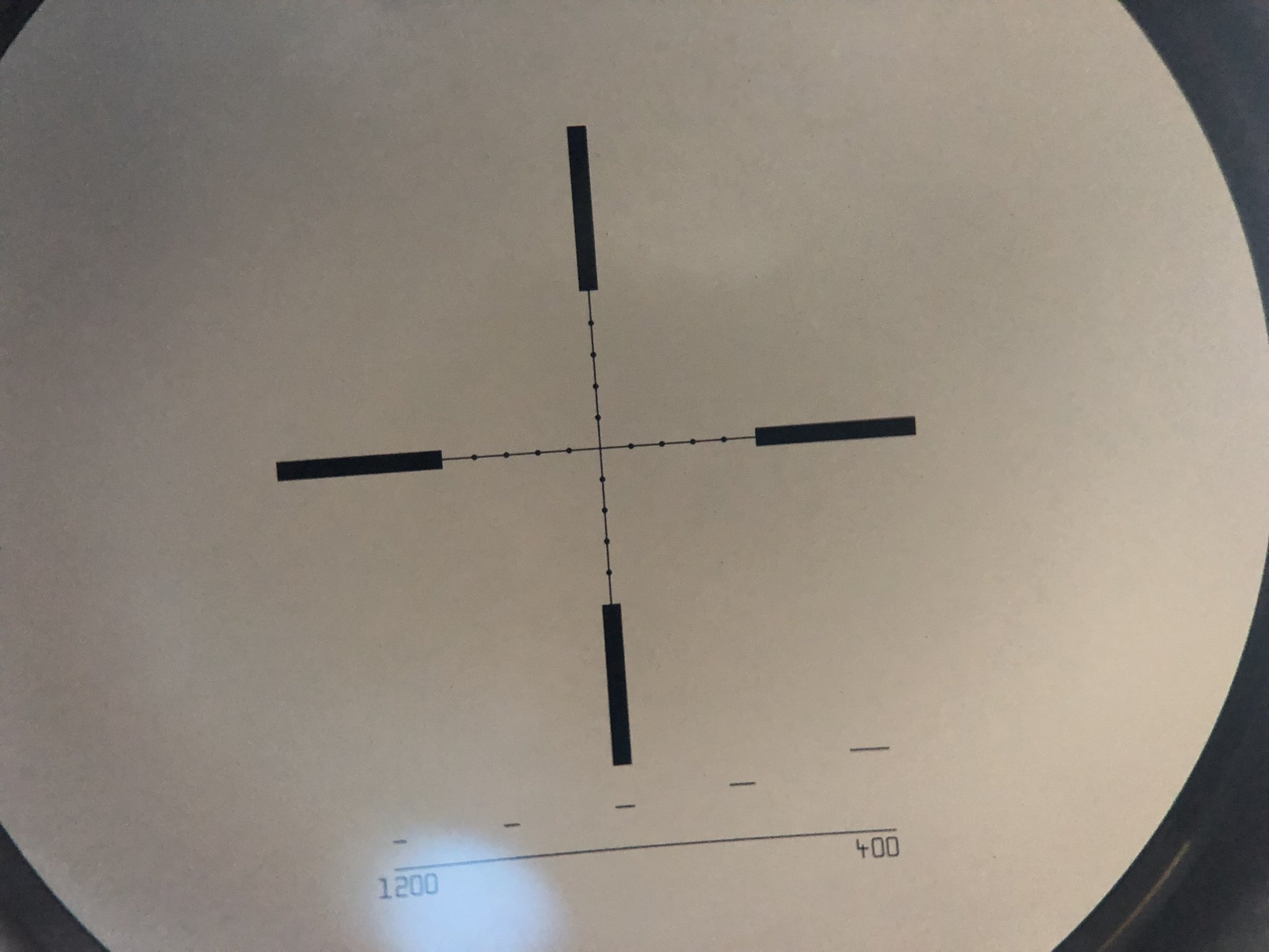

I have the Zeiss eyepiece reticle and the fact they are Primes and Not adjustable is not an issue, you can have a 20x, 25x, 30x, you don't need more than that. I have 3 - 30xWA Zeiss eyepieces for my Diascopes'
The kicker would be NF Reticles in two brands of pre-existing spotters
You are not saying anything I don't already know
Here is a clue,

I didn't realize you could buy an eyepiece with a reticle for the Diascope or I would have bought the one that just sold in the classifieds. Reviews looks really good on them.
I use a vortex 30x mil ranging eyepiece on my swaro stm 65 and 80. I've heard, but not personally tried, the Burris ranging eyepiece that is supposed to work on the first gen razor 80 spotters and the ats/m and sts/m 65 and 8o swaro's
