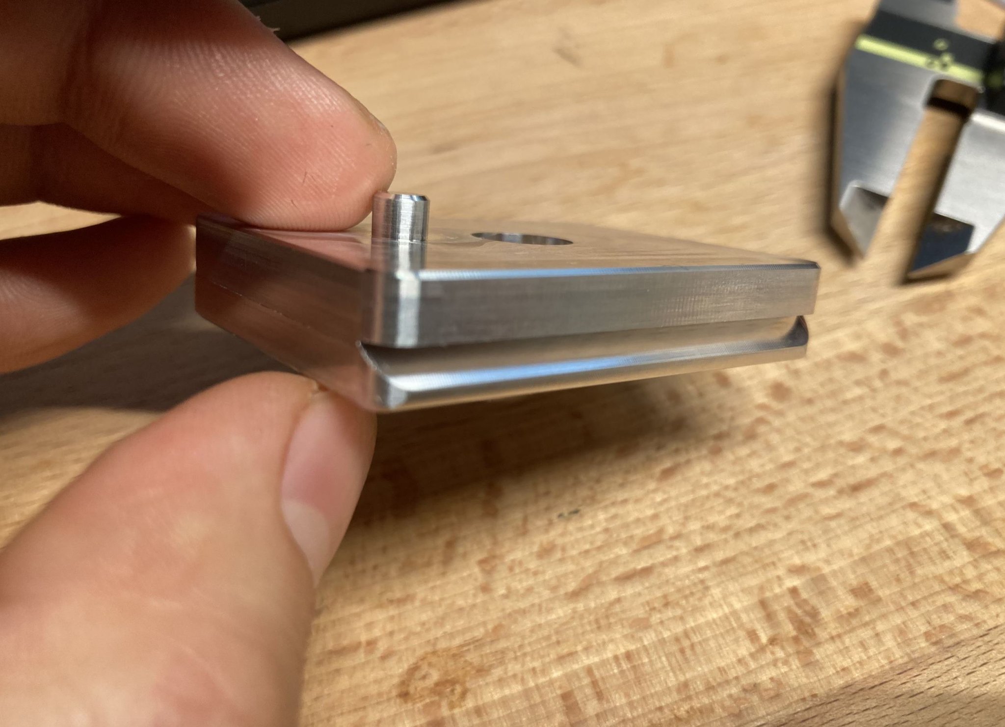

If not, I'm working on a more universal/adjustable ARCA plate design that may solve this issue... What's the size of the anti-rotation pin hole (diameter/depth)?
It does come with a reducer (they are also readily available from camera suppliers) but 1/4-20 threads are much weaker so my preference would be to use the native threads. I tried measuring the pin hole but the chamfering out the outside is making it hard to get a good reading with my calipers and I don't have a set of pin gauges handy. It is at least 4.5mm ID but I think it might be 5mm.
Hensoldt finally got back to me again, the hole is sized for a 5mm pin, it's about 5.1-5.2mm.
Here you go:
0.4" hole for 3/8" screw (I'd probably tap it 3/8 instead and make a screw with reduced shoulder so it can be captured in the plate)
5mm post
14mm center-to-center
2" OAL
Reactions: shoobe01
