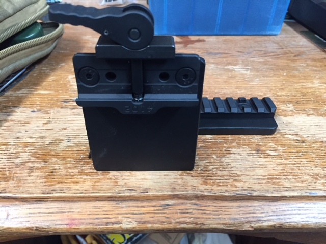

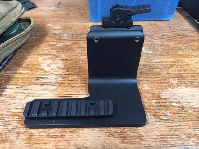

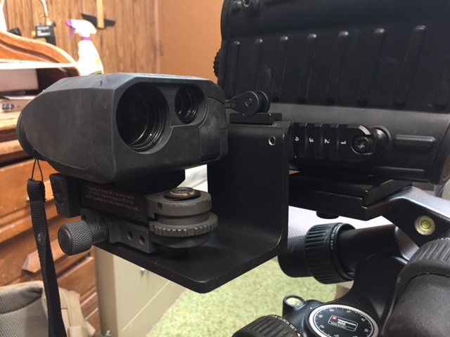

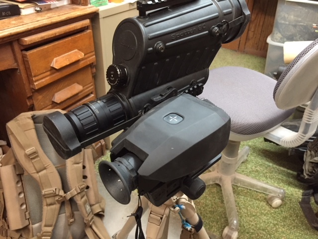

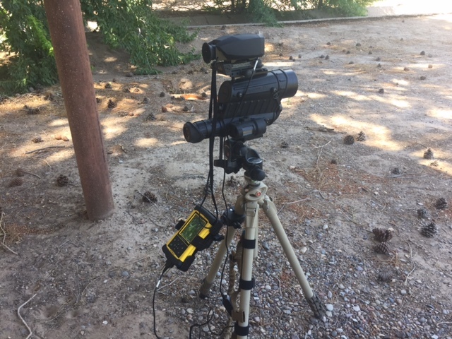

Hensoldt Spotter 60
APO Opto/electric rail mount
Vectronix PLRF 25C w trigger cable
1x RDS
Manfrotto 055 CF tripod
Manfrotto 405 Gear Head
Trimble Nomad running FFS
RAM mount for Trimble
This is an older picture and fabricated a QD adapter where the PLRF can be mounted on the side of the Spotter.
