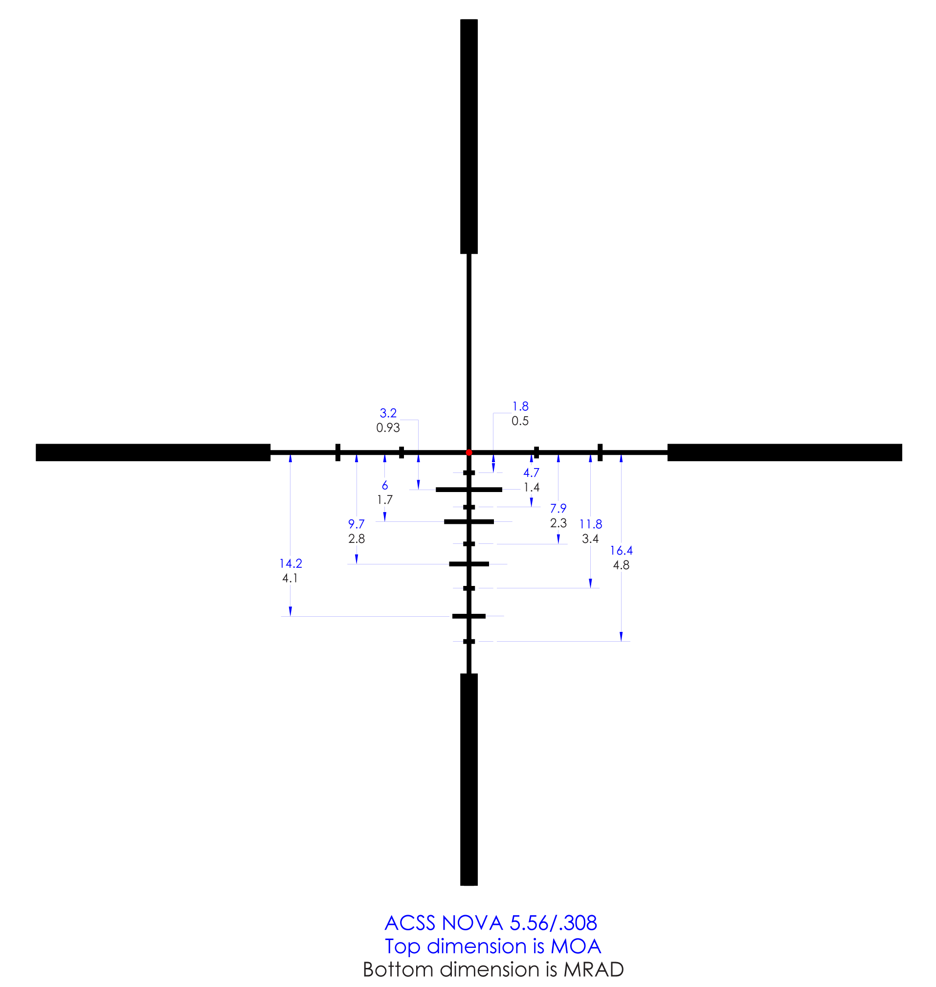

I picked up a couple of your PLx-C Novas and wondering what barrel length and ammo (both 308 and 5.56) the BDC drops on the reticle will work OK with. There's no chart for this in the manual like you have your other reticles. Thanks!

I sent the PA CS an email asking for the drops for the Nova BDC reticle in mil or MOA I was told they did not have that information and to use the chart in the manual...thanks a lot for zero help.
We do not own the IP for the BDC ACSS version and are prohibited from publishing the exact measurements. What I mean is the exact measurements is what is given to the factory to manufacture and is usually to 4 decimal points. Let me get a rounded off version that will work for your purposes. I will get that for customer service as well. Sorry for this hassle

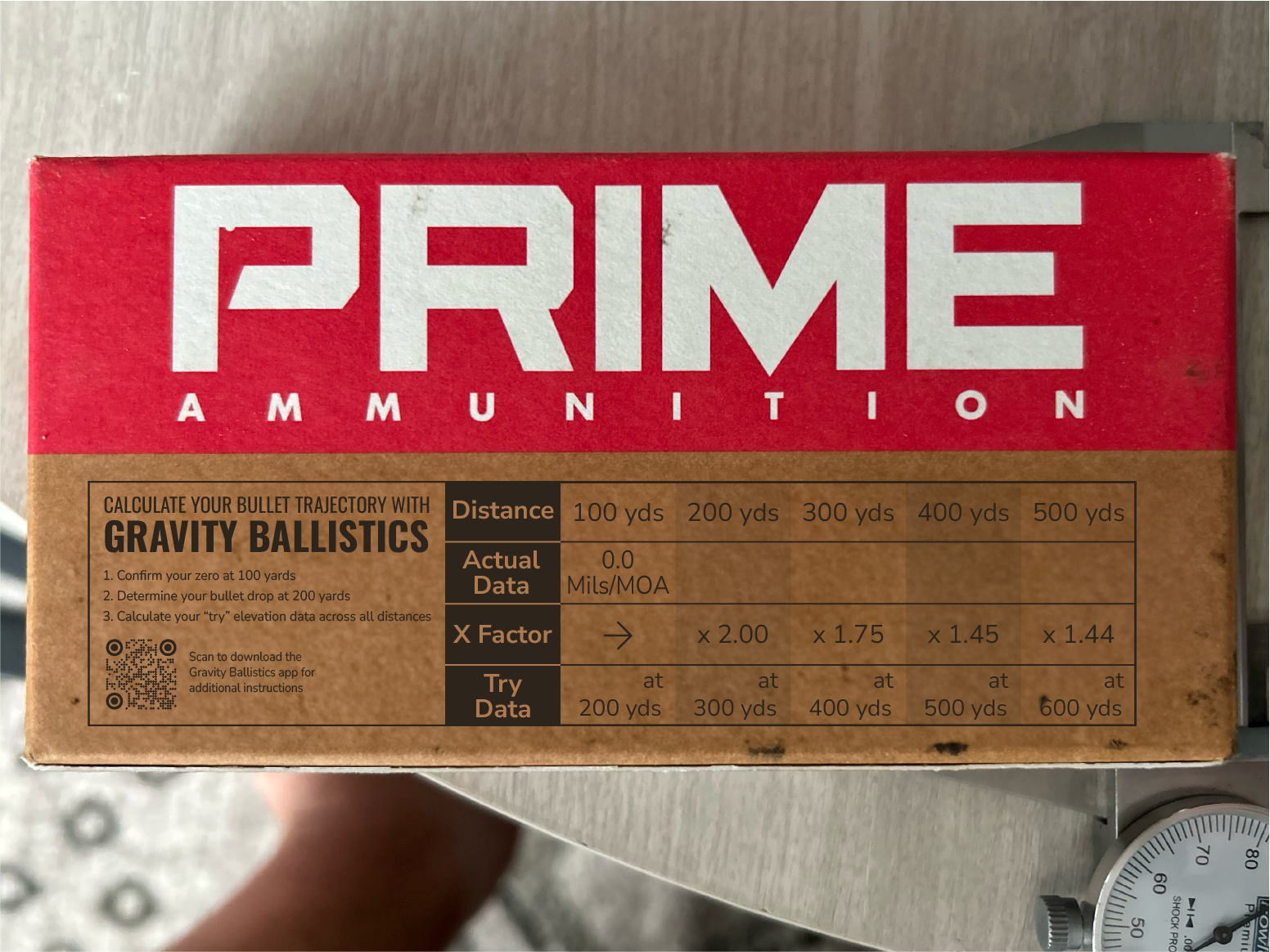

I bet I could make you one with Gravity Ballistics, and it would be close to on-point
Because you used GB it would be open source and not owned by anyone
My next goal this year to put it on ammo
I had mock-ups made for different boxes of ammo, but it will translate to drop in a number of ways
I have my dope for the actual drops for my load in the rifle it's on. I was just trying to see where the drop in the BDC on the reticle lines up. Maybe tweak the zero distance slightly to get it all to line up without having to get out and shoot a bunch before I have some rough data.
Based on the chart in the manual there seems to be some variance in the data printed with x round at y velocity. Running the numbers in my AB app or others it varies by about .3 mils which isn't too bad for general information.
