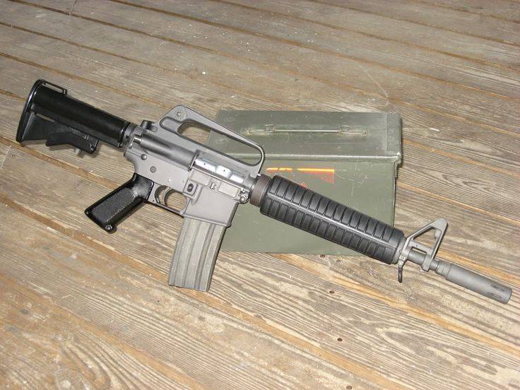

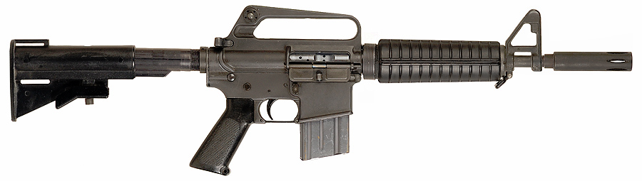

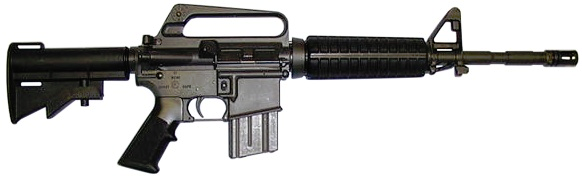

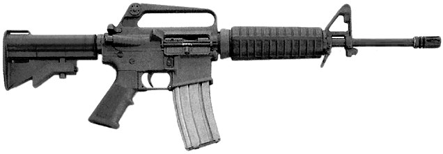

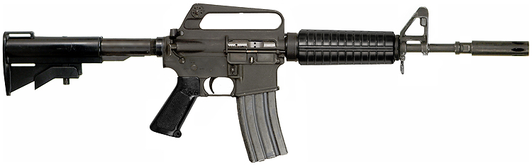

    The XM177 was the Colt Model 610, which came out way before the Colt 723 in 1966 along with the Colt 609 (AKA the XM177E1). The XM177E1 was partially replaced by the Colt 629 (AKA the XM177E2) in 1967. The 723 came out in the 1980s unless I'm mistaken.
    The Colt 723 does not have the same upper receiver as the Vietnam-era XM177 carbines. Those were the same as the M16A1 with the forward assist (or the regular M16 without the forward assist, for the Air Force carbines) and simple carry-handle sight, with no brass deflector. The 723 had the A1 style rear sight, forward assist, and the brass deflector, so they're more-or-less the same as a Canadian C7-style upper. There were also at least two different barrel profiles, either a plain unstepped A1-pencil barrel on earlier production or a stepped M4-style barrel on later production carbines.
    Colt Model 610 (XM177):
    Colt Model 609 (XM177E1):
    Colt Model 629 (XM177E2):
    Colt Model 723 (Early Model):
    Colt Model 723 (Late Model):
    (Pics from the IMFDB)

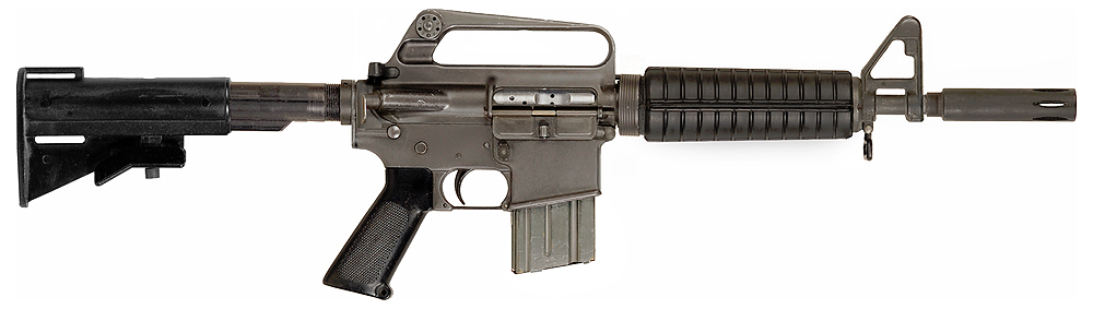

    The XM177 uses a unique flash suppressor sometimes called a flash or sound moderator for its 10-inch (250 mm) barrel. This device is 4.2 inches (110 mm) long and was designed primarily at the request of the US military's MAC V SOG as a method to confuse the Viet Cong and NVA, as the moderator makes the weapon sound more like the AK and AKM rifles in use by the Viet Cong and NVA. This device reduces flash signature somewhat and alters the weapons sound signature, making the normally louder short barreled carbine sound like a AK/ AKM.
    The Model 610 was classified as the XM177[1] but adopted by the Air Force as the GAU-5/A Submachine Gun (GAU = Gun, Aircraft, fully-assembled Unit). The Army purchased 2,815 Model 609 CAR-15 Commandos on June 28, 1966, which were officially designated Submachine Gun, 5.56 mm, XM177E1.[1] As part of the contract, Colt was supposed to supply each XM177E1 with seven 30-round magazines, but Colt was unable to build a reliable 30-round curved magazine that would fit in the M16 magazine well, so most XM177E1s were shipped with 20-round magazines. The exception was 5th Special Forces Group, who received a total of four early 30-round magazines. Colt completed delivery of the purchased XM177E1s in March 1967.
    In 1967, in response to field testing, Colt lengthened the Commando's barrel from 10 to 11.5 inches (254 to 292 mm). The increased length reduced noise and muzzle flash, and allowed fitting of the Colt XM148 grenade launcher. A metal boss was added to the moderator for mounting of the XM148 and rifle grenades.[2] The chambers were chrome-plated. The Commandos with the longer barrels were called the Model 629 and Model 649. The Model 629 Commando has a forward assist; the Model 649 Commando does not.
    In April 1967, the Army purchased 510 Colt 629 Commandos for use by troops assigned to the Military Assistance Command, Vietnam Studies and Observations Group (MACV-SOG), and designated them XM177E2.[1] Delivery was completed by the end of September 1967. The Air Force adopted a similar model without the forward assist feature as the GAU-5A/A. Sources debate whether or not this was a Colt Model 630 or 649.[1] According to John Plaster and other sources, the lack of 30-round magazines continued to be problematic and SOG operators resorted to pooling their personal resources and purchasing the larger capacity magazines on the civilian U.S. market.[3] Problems with range, accuracy, barrel fouling, and usage of tracer bullets continued to plague the XM177 series, but Colt estimated that it would take a six-month $400,000 program to do a complete ballistic and kinematic study. There were also recommendations for a 29-month $635,000 research and development program. Both recommendations were declined by the U.S. military as American ground force involvement in the Vietnam War was gradually winding down. Production of the CAR-15 Commando ended in 1970.
    It is rumored that the People's Army of Vietnam's M-18 was designed based on XM177 carbines seized from dead or wounded American and South Vietnamese soldiers in the Vietnam War.[4][5] They were first seen in public in 2010,[6] made by Z111 Factory.[7]
    I have a ATF legal replica of the XM177E1. The original military flash/moderator is an NFA item as it reduces the sound sufficiently to allow AFT to require a transfer, so mine does not have the original style muzzle device. My impression of this gun is it is LOUD as HELL and the cyclic rate is such that initially I have frequent jams. I have changed the buffer to a much heavier one to slow the cyclic ate and now it functions without jams. My wife weighed only 100 pounds and could not shoot it in auto mode as to walked her backward.

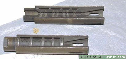

    There were 2 different lengths of moderators. There was a short moderator, 609?, then the 177 was longer by about 1" (?). I would have to pull them out to measure. There was also a model 639 that was rumored to be for a contract to the Shah of Iran. He fell before the order was delivered. A bunch of these guns were sold through Areo Marine in Birmingham. I have records on 30-50 of these.
    If you look at the pic of the 629, there is a second piece to that moderator. It is a small ring that goes on the barrel before you screw the moderator on. It is a grenade ring.
    The original XM guns sold to the public had the moderators with them. ATF retroactively classified the moderator as a suppressor and the owners were tracked down and they could register it or destroy it. There were a bunch of original moderators that were thrown away because no one wanted to pay the $200 tax on the moderator. Most of the originals are marked "ATF XXXX" as a serial number.
    Several years ago, Colt found(HA!) a bunch of the original moderators on a shelf somewhere. They marked them with newer style Colt engraved marking and registered them as suppressors. A dealer in PA had a bunch of them. He may still have some. If you have an original XM gun with no moderator, thats your only option for an original. Even though it is not marked the same.

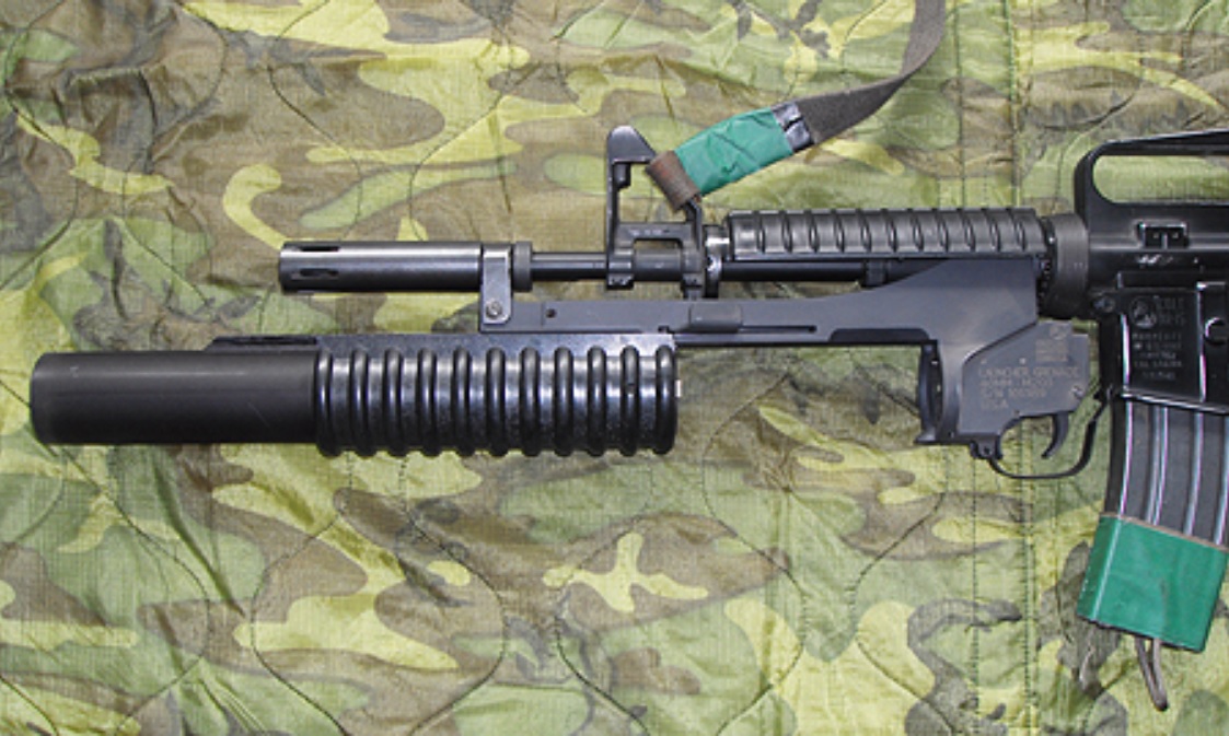

    Grenade ring and how the M203 mounts to the XM177E2:
    Griffin XM Linear Comp -- same dimensions as NFA item, but one baffle and NOT noise suppressing. Sadly discontinued:
    Inside:

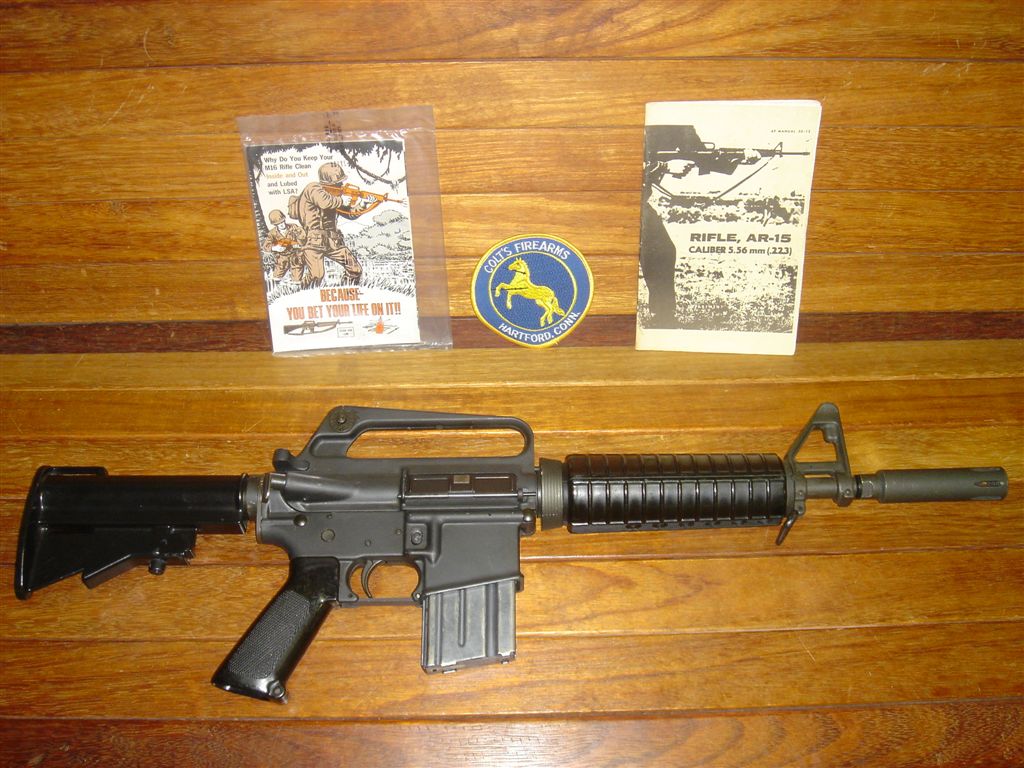

    This is a non US Prop marked 619. It is marked COMMANDO. I have only seen 1 other in a photo.
    This came out of a PD in Louisiana.
    Many of the XM's have barrels that are toast.

    The FSB is also incorrect. There shouldn’t be a bayonet lug on either XM177E1 or XM177E2.
    The barrel is obviously incorrect for avoiding NFA purposes, but is the correct diameter at the FSB and fore end, just a bit longer to bring it to 16” overall length with the faux moderator.
    Grenade ring meant to retain the XM148 and M203 shouldn’t be glossy, but parkerized.
