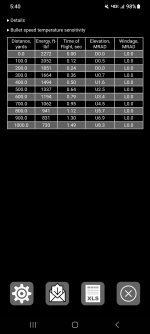

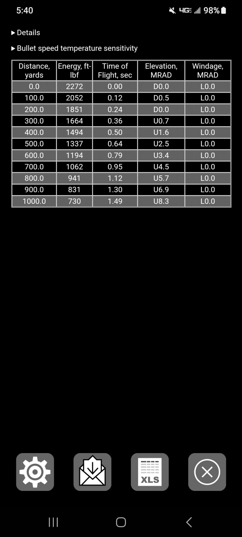

Well If I have a 200 yard zero how many clicks in general( I know, it's for me to see if I even have enough adjustment to hit targets at 800 or so yard), I have plans to buy a Night Force scope. My wife has an operation here in May so for now I need to play with this scope to get an idea on how it works. I only have used iron sights when I was in the Army in the 80's, and a 3x9 on my deer rifle. I don't know anyone either who knows anymore than I do and I don't know anything. I watched last night a youtube video of a ranger sniper teaching his friend and he had a 100 yard zero but was using his dope to hit targets out to 968 yards I think it was. I was just wondering if my scope even had that ability to make enough change like that. My scope is in mills. I have a Leupold 8.5x25x50 and it has a nice reticle for squirrels very thin lines on it. Once I put a 200 yard zero on it, year ago the little cross hairs basically could bring me as far out for a 500 yard shot and it did. I never had the need to do anymore then that. There is a range that is a hour away from me that is out to 1000 yards but you need to be a member which I plan to do once the wife gets back to work as she will be out they say for at least 6 weeks. I have a vpr-m-06Md and the Mill dot is pretty clear but its not the real scope that I wanted but it will do for now. Thank you for your help and suggestions.
With my 6.5 CM and a 100 yard zero, it's a 20 minute dial up to get to 800 yards, and an additional 9 to 9-1/2 minutes to reach 1000 yards.

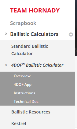

Go to this site:
Put the data on your rifle, zero, and environment (just make some reasonable enviro numbers up, yeah) and you can see how many mils or moas you need to come up for 800 yards (clicks ain't really the way to look at it)

If you go to that site (Hornady), you will see there is a "Standard" ballistic calculator and the 4DOF (DOF = degrees of freedom...and, its just a more sophisticated calculator).
I'd suggest the 4DOF. At the top of the page with this calculator, there is a link to a description of all of the fields you need to fill in and the fields it will output. If you get stuck, come back with what parameter is not clear and someone here will steer you straight.

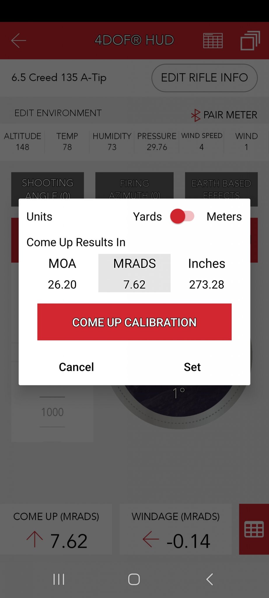

lol I must have done something wrong it says that I need to go up basically 192.1 MOA. I don't even know if have that much adjustment. I need to go out there tomorrow morning and see. I need to turn the knobs a bit to check. I know that I am zeroed so all I need to do is turn up the elevation and see if I can even get that many MOA out of it. I believe for the most part that is fairly close to what my scope would need to be able to adjust too, just to give me an Idea of what I would be able to do with it. Thank you for all your help,
Robert
Robert
You did something wrong
Robert
For a shot at 996 yards (which is my actual distance to the 1k berm)
Hornady Dof says this with the 135 A-tip.
Something in your setup is way off.
Yep, with Berger 140 HT to 1,000 (and not being weird with environmentals) I'm getting 27.4 MOA/8 MRADS/287 inches
@Rude Robert - don't suppose you know how to capture and post an image of your inputs to the ballistic calculator?
