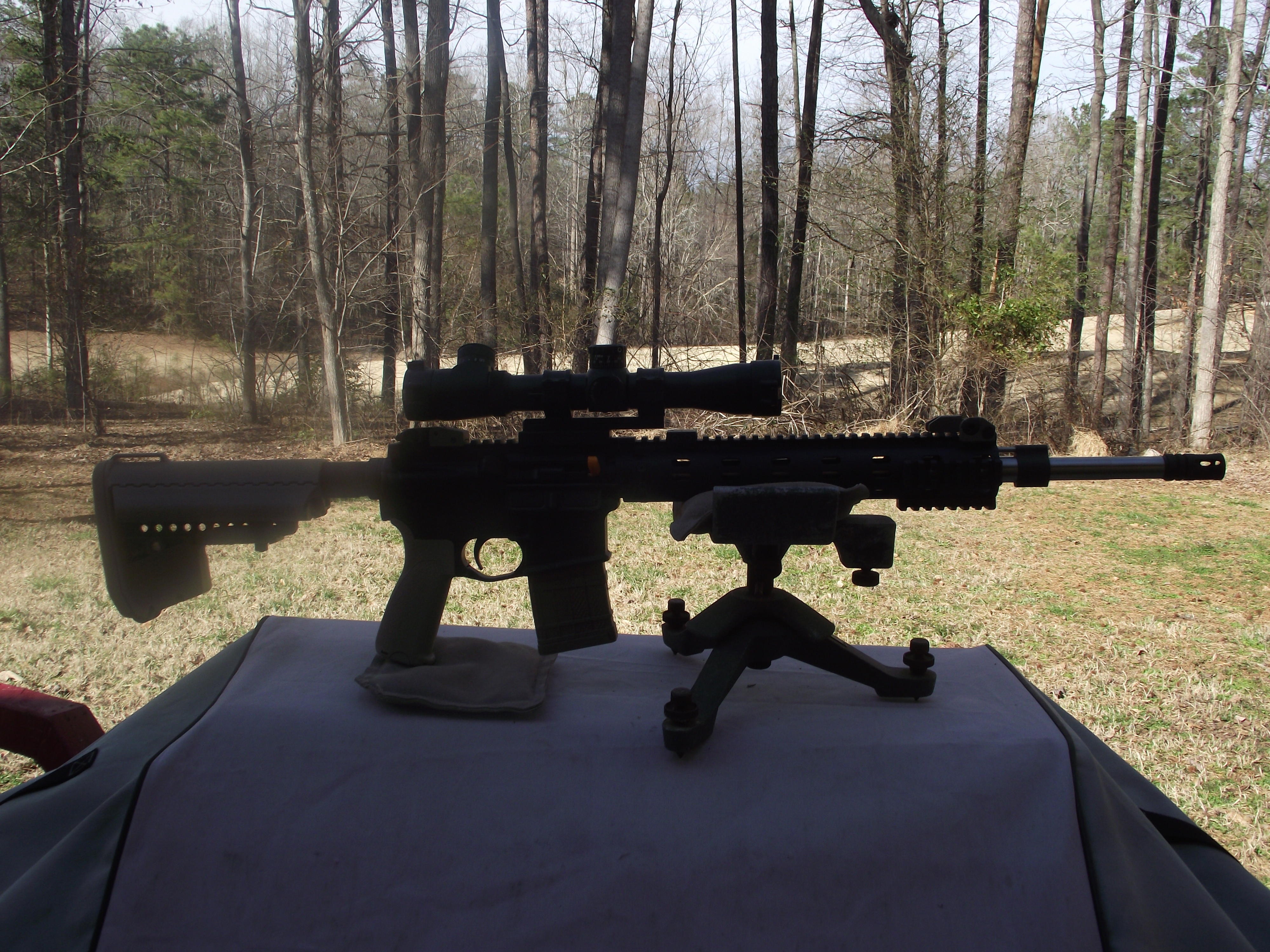

This was built using a HCS upper.
Lower: Spikes Tactical Punisher (SEAL throwback idea)
Geissele SSA-E (amazing)
Regular A2 stock and rifle buffer/spring combo
The gun shoots amazing. No recoil at all and groups around an inch. The bottom pic is at 505yds with 4 of my hand loads (2 groups of 3 looked promising at 100yds so i took the remaining 4 rounds out to the long range)
Its by far my favorite rifle to shoot and that 1 vertical line on the stock is for the first coyote I took with it this last January. The AEM5 is in jail til Nov. Visitation rights are a wonderful thing.
The group is about a half minute low because my handloads are about 50fps slower then the BH 77otm they sent me.
