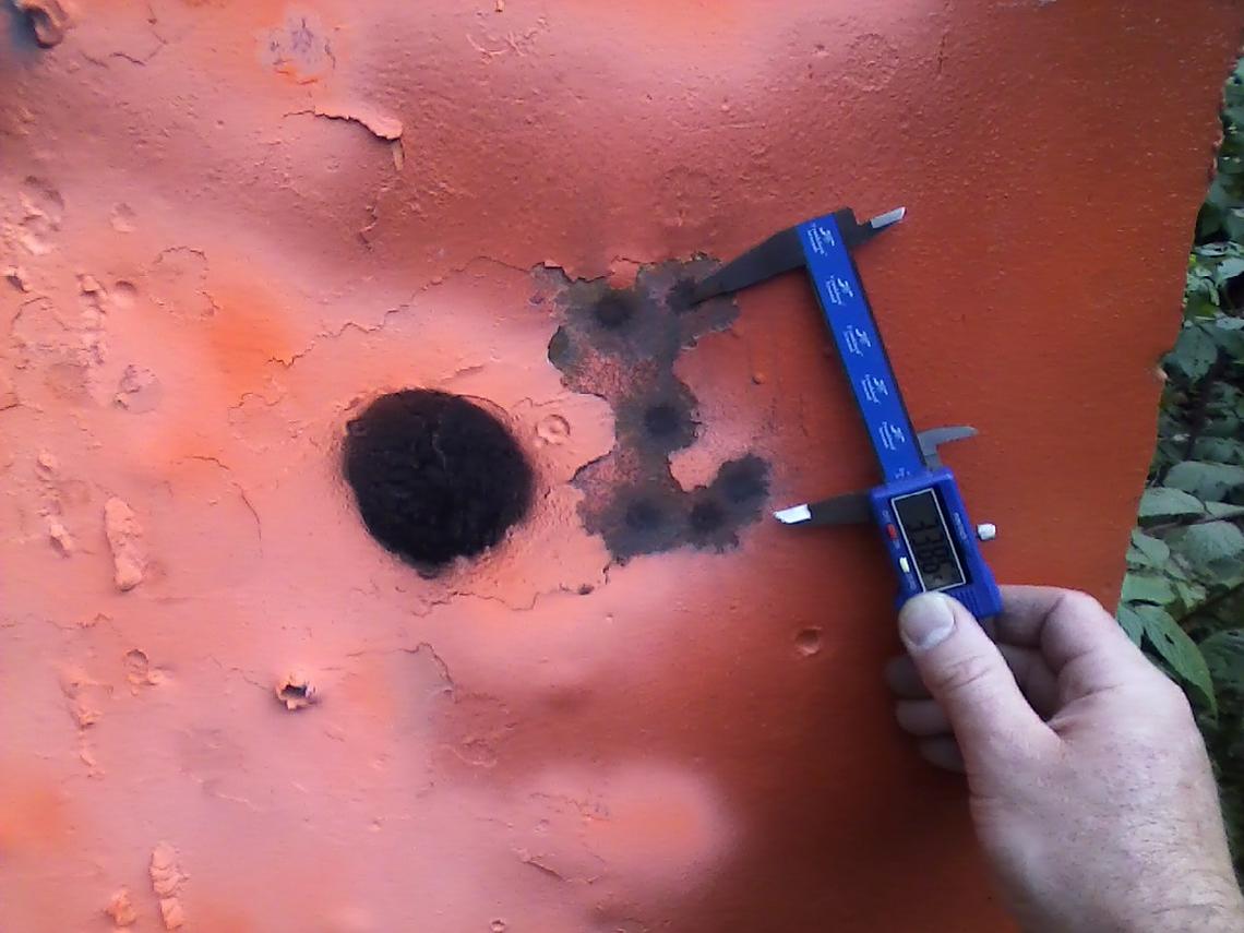

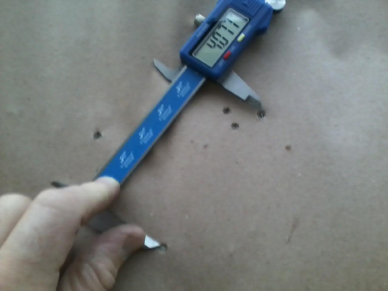

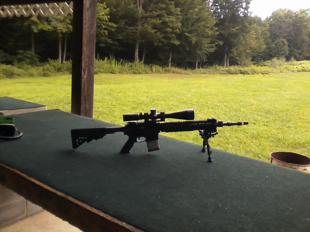

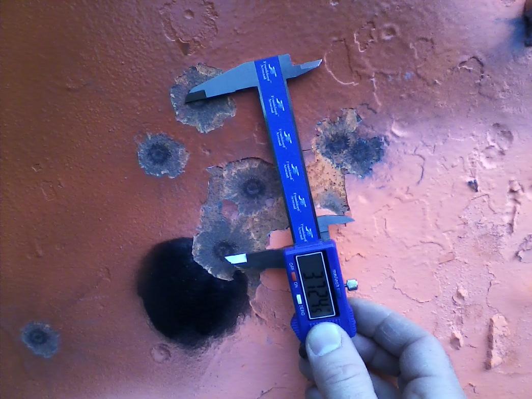

I sent off my 308 to GAP for a rebarrel so I've been shooting my HCS MK12 Mod1 lately. This thing sure is fun!!! I still need either a NF or Leupold correct scope, but for now, I threw on my NF 5.5-22 mil/mil. I've been testing the load with win brass and 24.2 varget under a 77 SMK. I tend to pull the last round sometimes!
The one pic is 100 yards 8 rounds and I pulled the ninth one. Around .55 center to center for the 8 rounds. The others are shooting a steel plate at 500 meters. 6 rounds on the one and 7 on the other..pulled the last one again! lol. Anyways, just thought I'd share some pics. These groups were fired rather fast but I'm extremely pleased with it so far!

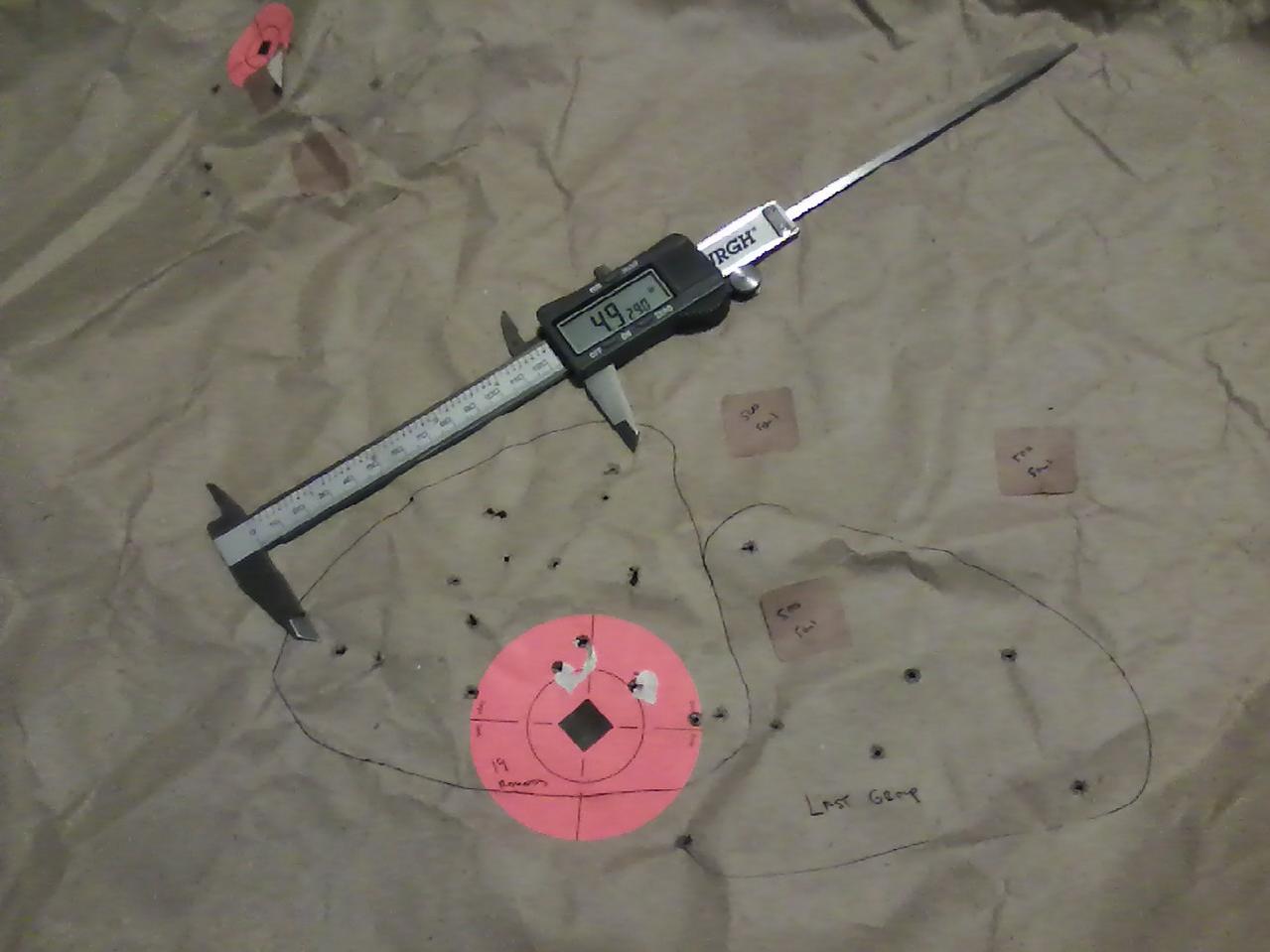

I shot it again at 500 yards tonight.Groups were pretty good with one being 2.4" for 6 rounds. I shot 3 foulers..then 3 groups...two groups 6 rounds, one group 7 rounds..driving down each time to check and paste over them. I kept the scope dialed the same for all. The last group of 7 rounds, the wind changed as can be seen in the pic. Overall it's very consistent as can be seen in the pic, especially the first 3 groups for a total of 19 rounds. 17 of the 19 in first 3 groups in 2.5" vertical. 21 of 26 for all rounds total in 2.5 or less vertical spread.

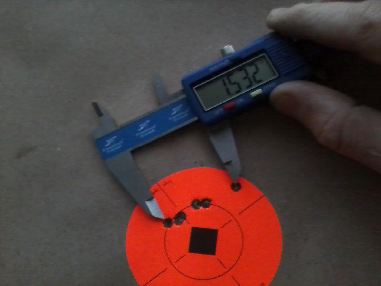

Cleaned the barrel and had a good 6 round group at 300 yards yesterday. 1.5" 5 were in around .83". Also included a 4" 5 shot group at 600 yards. Just confirming the load again...its good to go, just the wind get you more with the 223's than I'm used to
