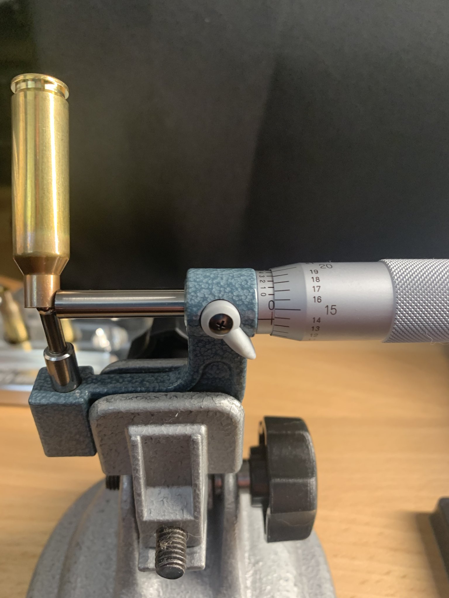

For a trimmer, I just recently bought a Giraurd. I did so for a few reasons including that I didn't want to have to bolt a trimmer to one of my benches (like the Henderson) and that's not needed with the Giraurd. In hindsight, if I wanted to go Henderson I could have mounted some T-bolt slots into the bench and make it easily removable...but I didn't.
I made a post about Doug Giraud going back (like back 20 years ago) to the old open bearing motor that he USED to use that needs an occasional drop of oil in this little port....without updating his website, manual, or notifying customers who had outstanding orders for his trimmer. He did so for what I consider a small price increase in his cost for the sealed bearing motor which served him well but IMO did not serve his customers well. And that pissed me off, frankly.
However, at my usage rate, I anticipate needing to oil it once a year so not a big deal and many like the Giraud over the Henderson as the Henderson uses a pilot that goes into the neck and @Dthomas3523 has a post where the pilot was galled a bit and etched the inside of his necks. the Giraud does not insert anything into the neck.

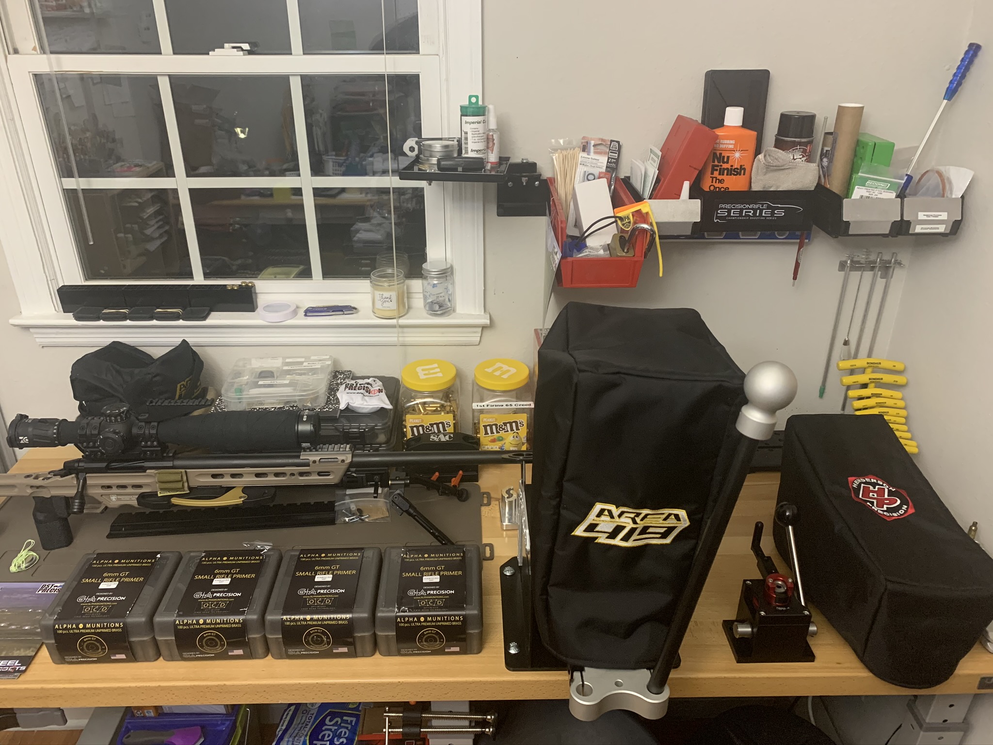

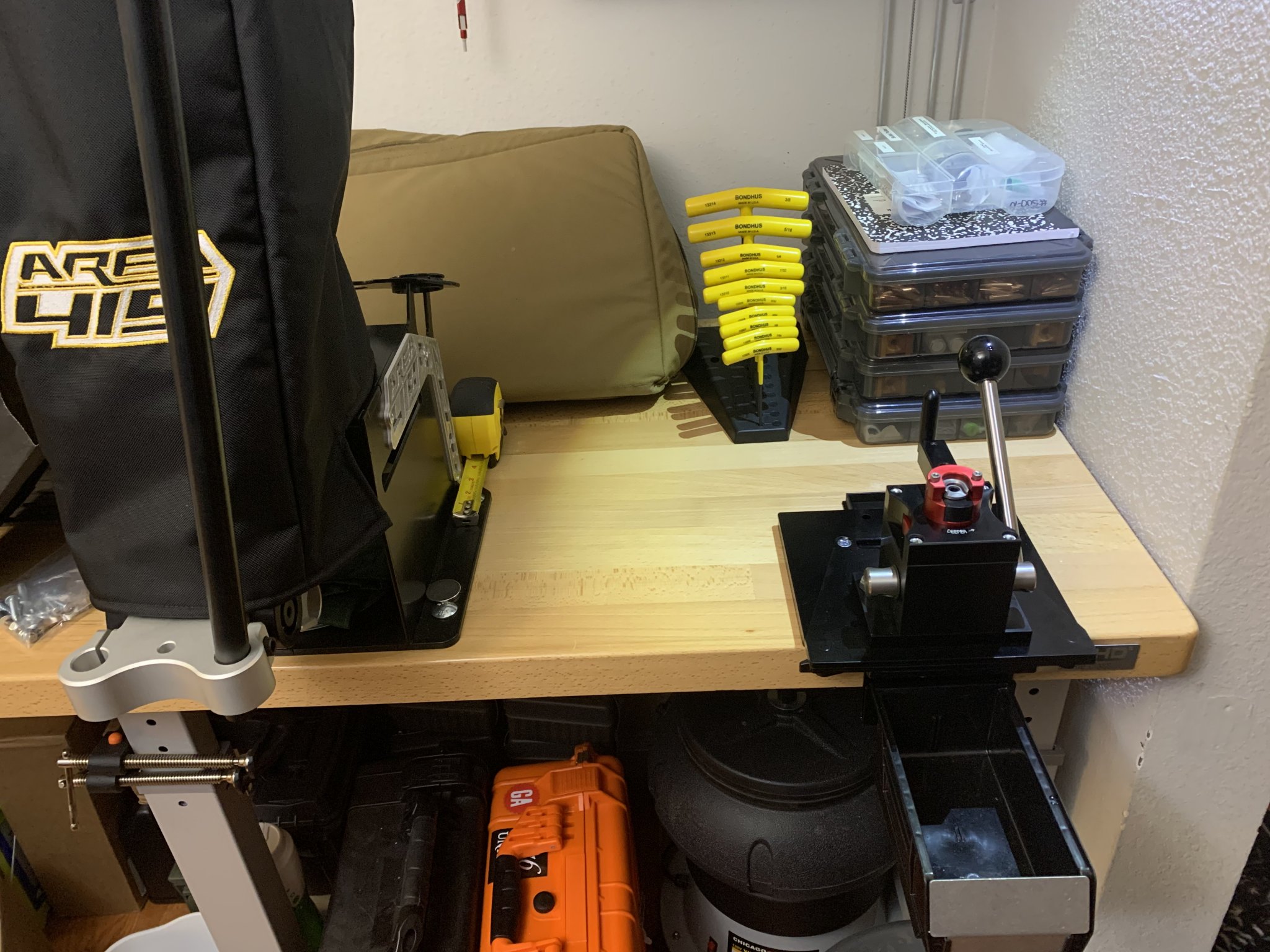

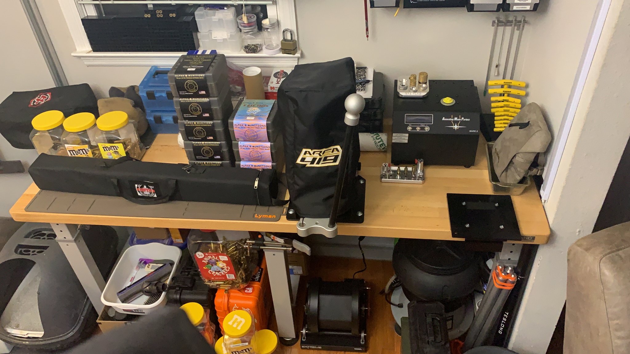

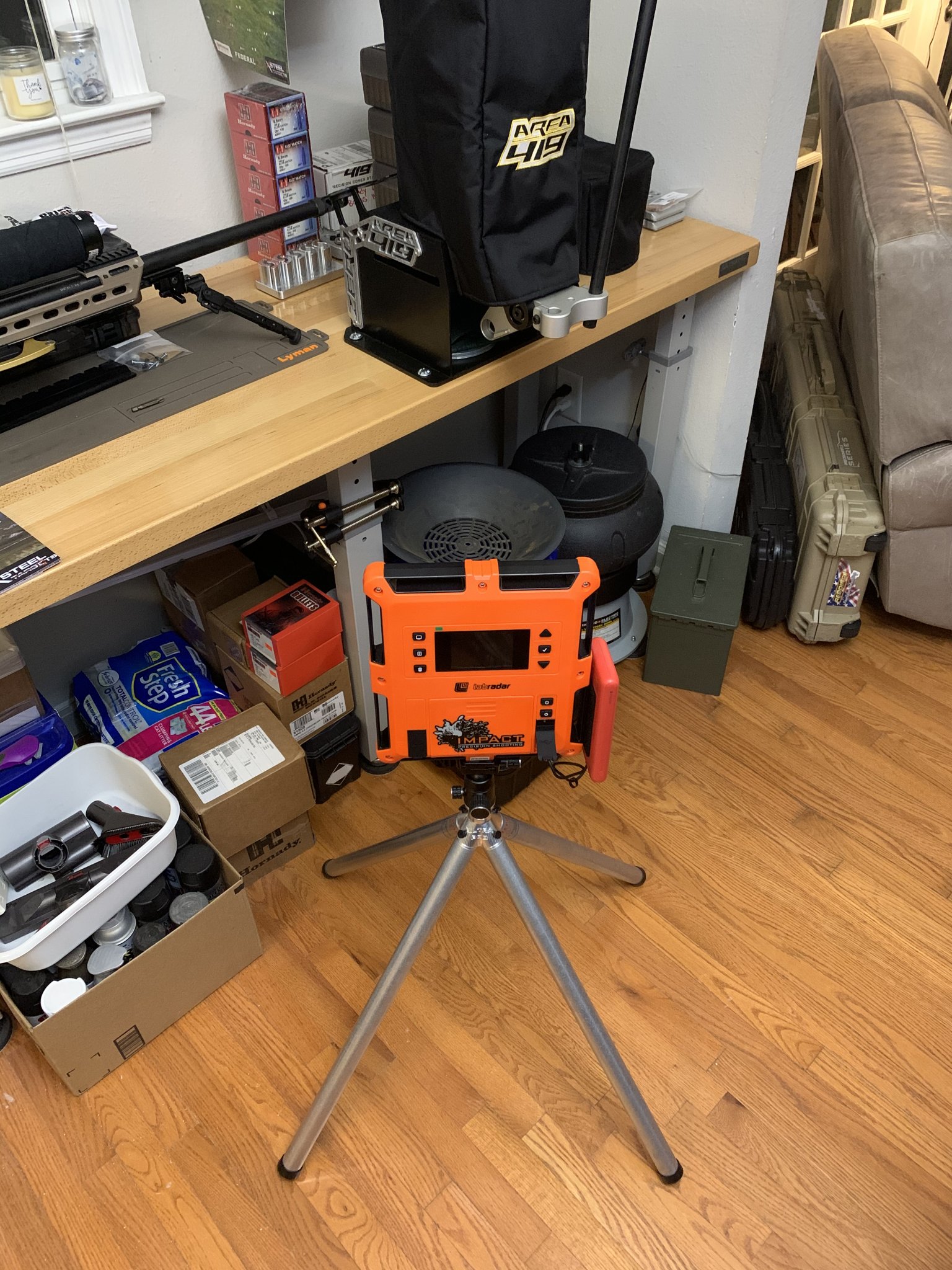

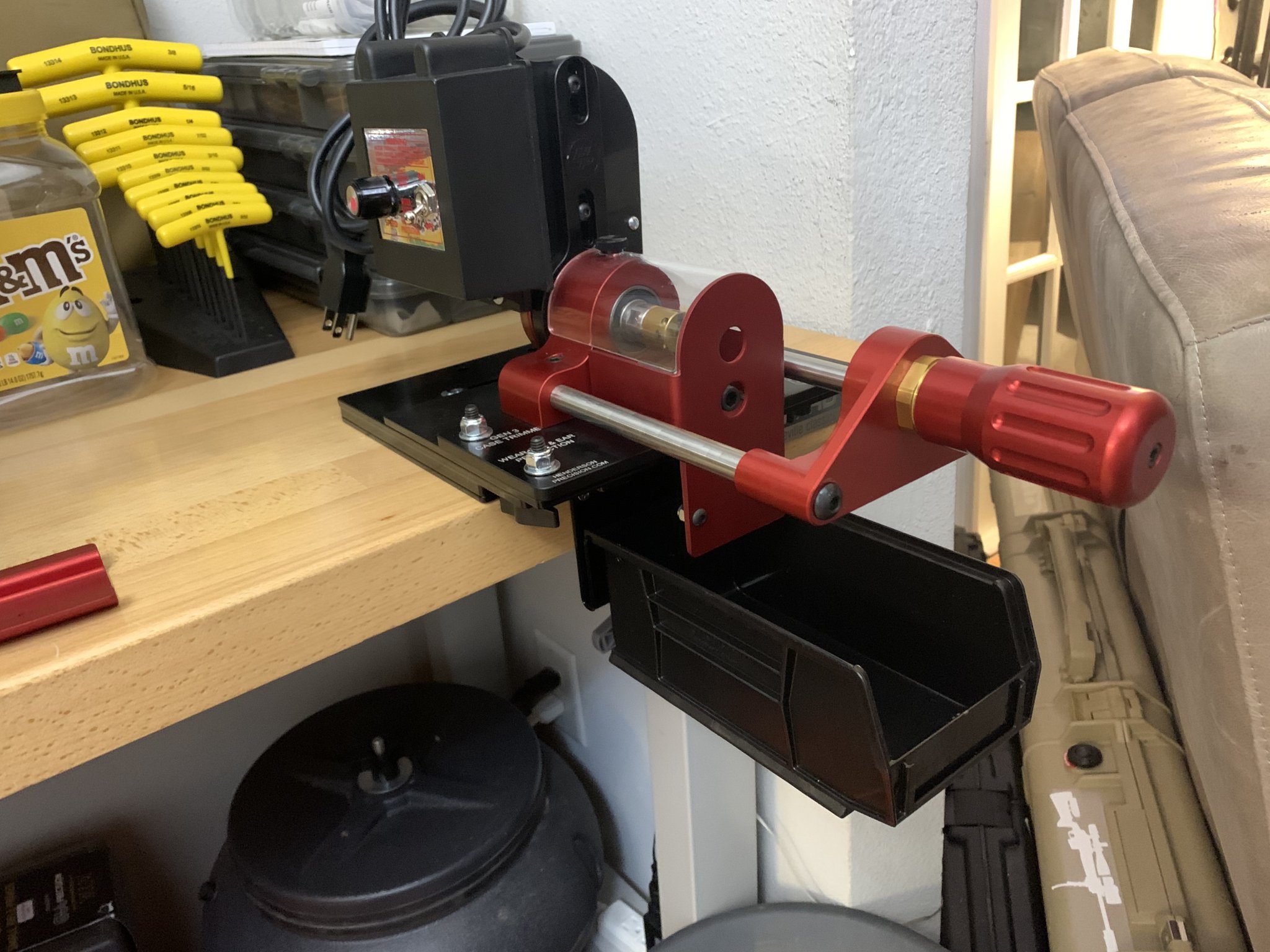

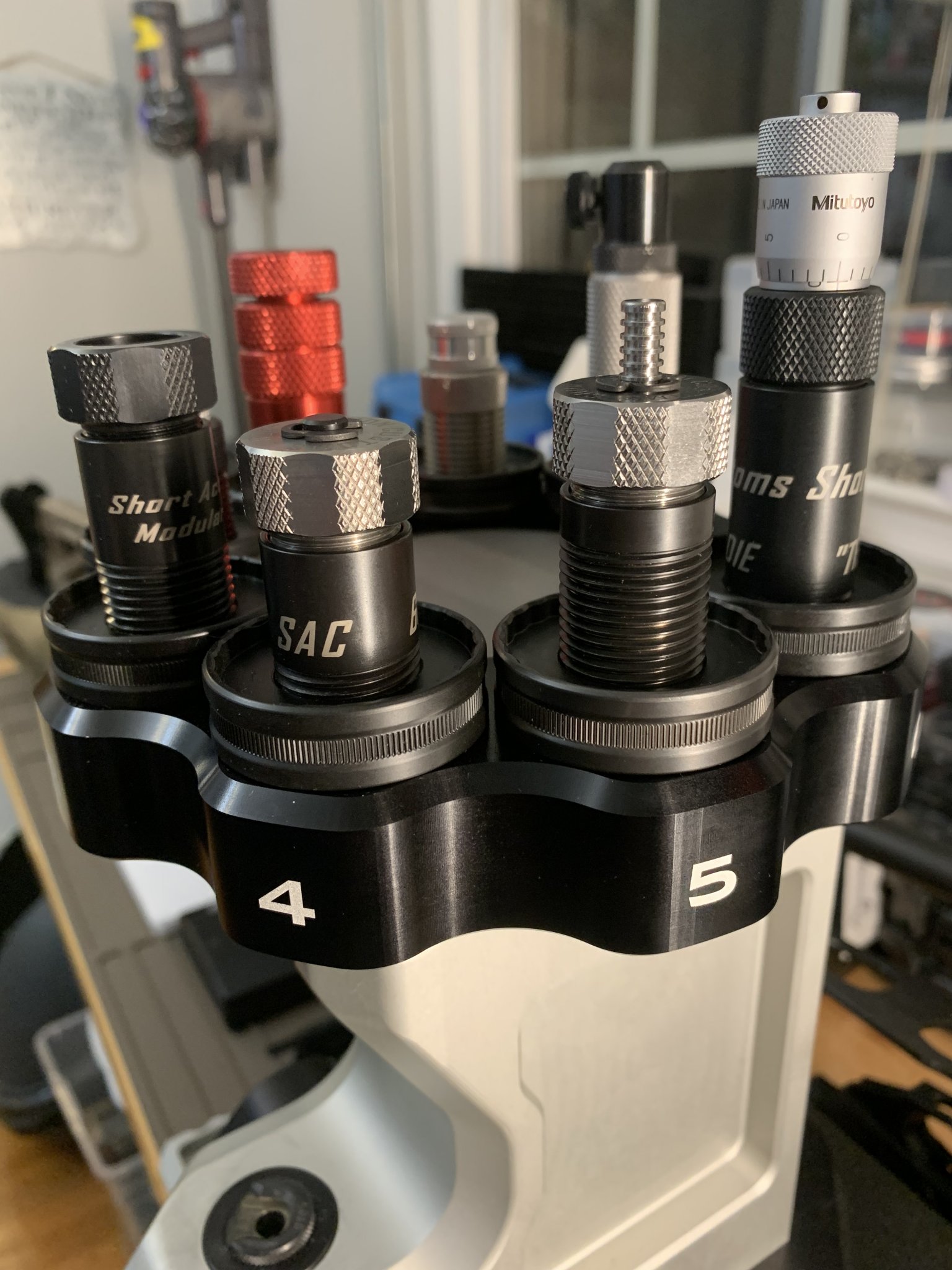

I couldn’t agree with you more. I jumped head first into this sport in late 2020.
